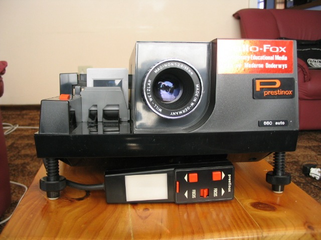

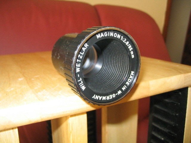

Hi All
I'v started investigating with the slide projector. It's an OLD
Prestonix 680 Auto. Luckily I got it with the manual.
As per the manual: replacement Lamp - 24V 150W Quartz iodine
Details on the current Lens : Will-Wetzlar Maginon 1:2.8/85mm
According to the manual I can use a variety of lenses with this
unit. 2.8/50mm; 2.8/85mm; 2.8/100mm; 3.5/125mm; 3.5/150mm;
3.5/70-120mm zoom; and a very high definition 2.5/90mm lens.
Some testing I done with normal photo slides. The image section
on the physical slide measured [w x h x diag] :
3.4cm x 2.2cm x 4.05cm (1.34in x 0.87in x 1.59in)
The projected image [w x h x diag] at [distance from lens to wall):
3.0m (9.84ft) - 127cm x 82cm x 151.17cm (50.00in x 32.29in x 59.52in )
3.6m (11.81ft) - 150cm x 99cm x 179.72cm (59.06in x 38.98in x 70.76in )
4.0m (13.12ft) - 170cm x 110cm x 202.48cm (66.93in x 43.31in x 79.72in )
These are approximate, as the dim bulb and ambient light in the
room didn't allow for extremely accurate measuring. Now to source a LCD module with dimensions close or equal to the slide....
I will post some pics of the lens, slide projector and room soon.
regards
Gary

erm ... don't know what happened to the attachments. They were there while moderator was checking my first-time posts. The preview showed the links and file names.
I'll try re-posting them tomorrow. Sorry about that guys.

I mentioned the slide projector experiment incase anyone was contemplating the hand held 1.5 inch screens. in a slide projector. It fell together took about two hours of mucking around. Basically I learnt about the lenses condensors etc and fresnels.
I should get a real small setup. I am looking forward to sharing results.
