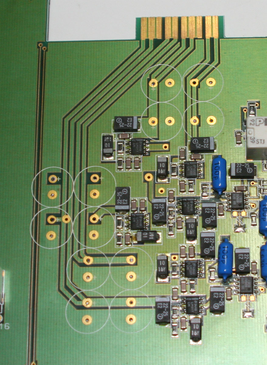

Hi Loris,
I'm very sorry to hear this - but it does not surprise me. On the occasions I've attepted repair of the PCB's - they have never lasted.
Pls. don’t waste your money replacing the capacitors - I now believe that due to low voltage operation (when the PCB tracks have gone high resistance due to the leaking capacitor electrolyte eating the PCB tracks). This I believe damages the Logic IC’s within the potted DAC section, which fail after time operating under these adverse conditions.
I believe the failure sequence goes something like this:-
1. Capacitors start to leak eating the PCB tracks.
2. PCB Track becomes High resistance – DAC operates with reduced voltage – however the CLOCK section within the DAC which is supplied by a different supply rail beginnings to “Power” the DAC section, via the Clock Line and ESD protection diodes on inputs the of CMOS Logic and Supply rails (note this is intergrated at 50% duty Cycle - so half VCC)
3. After some time operating under this “Fault condition” the Clock output drivers (which are not “Series Terminated” – my bad) begin to fail…. Finally you end up with the resultant “White Noise” as the clock degrades.
This is one of the reasons I've given up on trying to repair damaged Dacapo PCB's... Your much better going for an MDAC or 8200CDQ
John

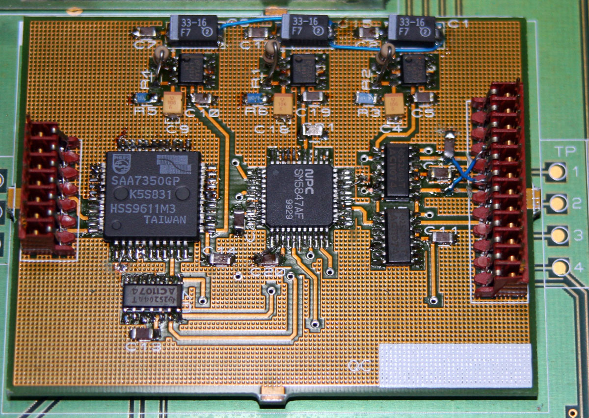

.........actually I was waiting the one you promised me for Christmas....
Hi John,
I can't say if this is consolation..........
Anyway this time the white noise is not because of the caps, there was no leaking at all as you can see in the pic. The new caps are already arriving so I'll put new ones.
The other pic is "my" 24 bit filter.

Hi Loris,
Indeed - Consolation will be coming soon...
The 24 Bit filter is such a mess, this was "Designed" and produced after I left PT, The design and construction is quite shamefull. Are you having noise issues with this filter? - Do you have the option of testing the Dacapo with a different filter module?
John
