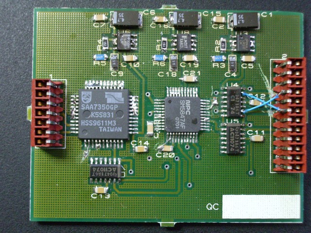

Here's a photo of THIS 24 bit filter, hope there's not a problem with it being shown? It is 10 years old now.
It does look rather modified!
I'll see if I can make enough sence of the data sheet to determine if any of those modification looking changes enable the “internal dithering function”.

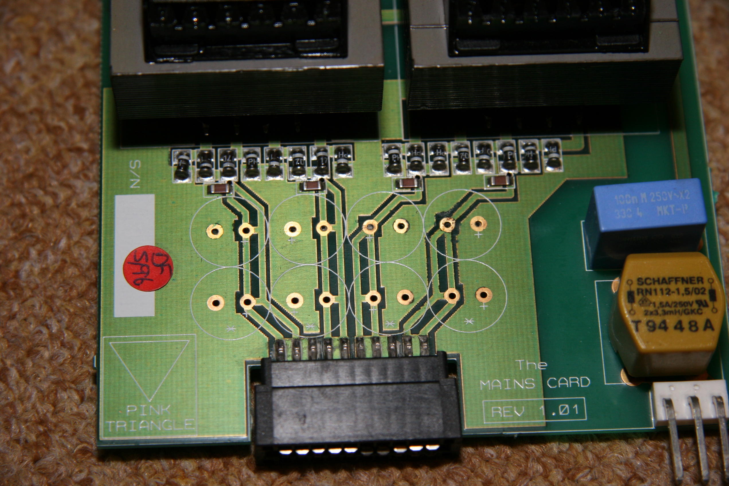

The caps from my CD player have also been removed . Luckily there is no sign of leaking caps at all
Yes there is. Many of them have started leaking and eating into the gold pads. Those faint rings from the base of the capacitors are the liquid residue.
You need to clean that off.
please tell me more about polar or non-polar type of cap for replacement, aswell as parallel the caps: -negative (-) polar with (-) polar and positive with positive? Am I right?
What kind of the leaking caps are? Polar or Non-polar? Can I use either of them to replace the leaking caps?
Non-polarised capacitors have no polarity and do not have the -ve stripe down one side. They can be connected either way around.
The leaking ones are polarised capacitors. Polarised capacitors can explode if connected the wrong way around.
which caps please help

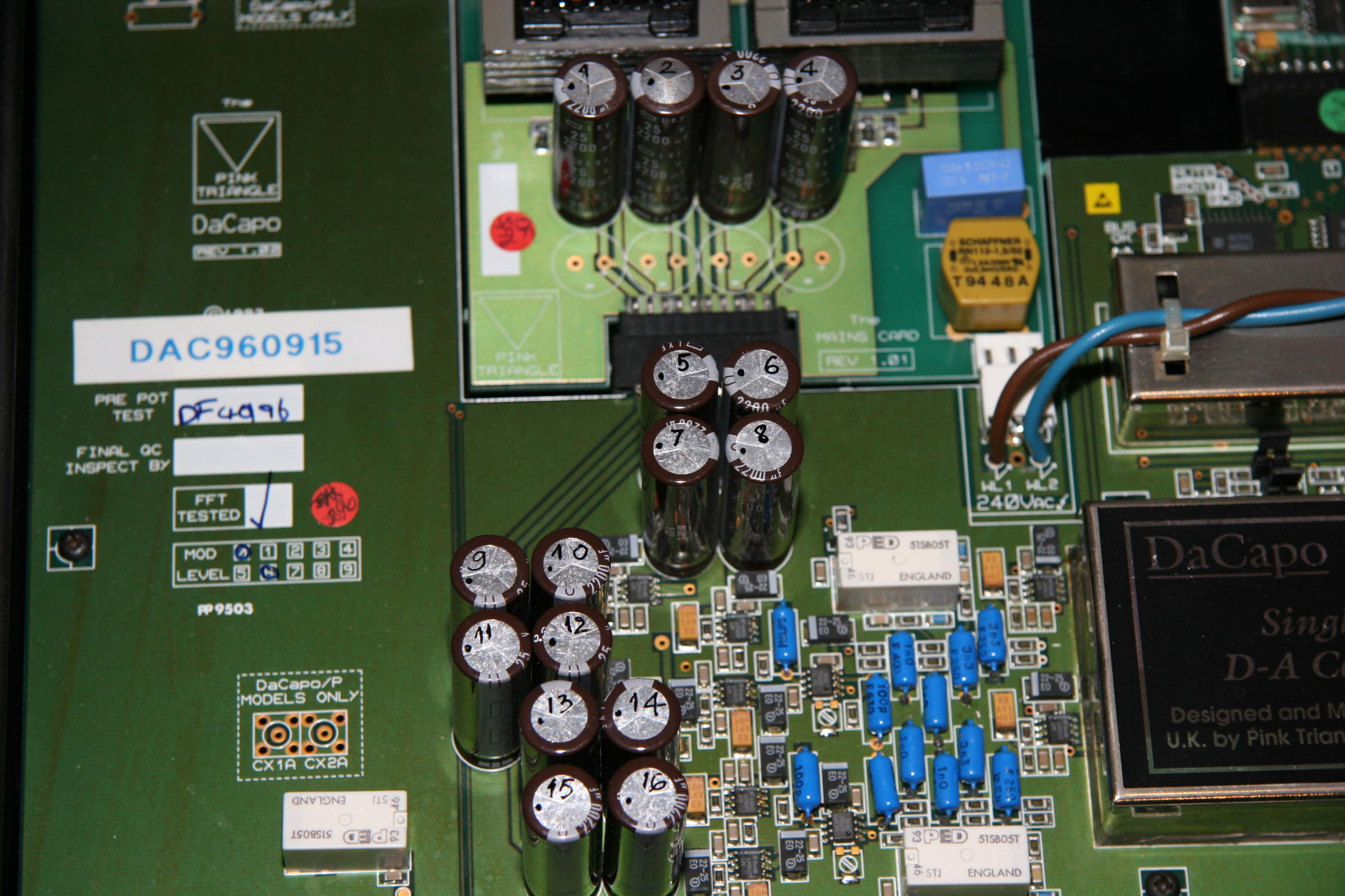

I used Rubycon ZL as they were
cheap,
available,
recommended by several people inc in this thread,
sold by some on-line HiFi shops for an inflated price as 'excellent caps, similar sounding to Black Gates'. (Similar to Black Gates! Yeah right! Similar colour and made by Rubycon!)
I think it probably doesn't matter all that much in this circumstance which 'ordinary' caps are used. We're not asking them to deliver current. The main thing to get better sound quality seems to be to parallel some 'special' ones across them.
Unless your disposable wealth level permits exclusive use of 'special' ones, eg, Black Gates. Conductive Polymer caps appear to be in this category, but I'm currently unsure of their effect at bass and they only come smallish values.
10 years ago, with a friend we used to make and sell PSUs for CD players. We used 1000uF Nichicon KZ series before the discrete regulator(s) and Black Gate standard series in and after. I didn't use then in this DaCapo due to them being so very much larger for the capacitance. And also to save money, it was not known whether the white noise problem could be cured so there was no point in investing a larger sum only for it to be wasted.
They seem to be quite good, nice to listen to, by very laid back compared to Black Gates. The KZ's can cause a boomy bass when paralleled across a 10,000uF. Black gates = slam propelled by amazing dynamic range and speed at all frequencies, both on their own or paralleled across something larger.
The other thing to bear in mind is that the bridge diodes in the DaCapo are not all that beefy, and the transformers aren't either. Might be wrong with this one as I've not tired it, but all previous experience suggests that a very good separate PSU can't fail to improve this DAC.
The one I used on my 7350 DAC, with only drew 100mA, had 20,000 of the Nichicon KZ, discrete reg.'s, 1200uF black gate, 1000uf OsCon. For and output of ±15V DC. I'd have used ONLY Black Gates though if I could have justified the cost as my pals supply, equal in all ways except Black Gates instead on KZ's was Sooo much more 'powerful' and slam bam wallop!
Yes sadly the 24 Bit Module is a REAL mess - design and build quality.
Pin 44 (last Pin on the QFP) should be Grounded - its appears floating (High) in your module - you can just solder bridge to the row of Grounded pins next to it.

Yes, it is floating. I've just checked.
Thanks for that 🙂
I'm only guessing but it rather seems that who ever populated that board mistakenly soldered the last floating pin of the 7350 instead of the last floating pin of the 5847!
I'll put that right. And have a listen before and after.
Another way that this assembly might be lacking is that the three 317's are fed direct from the +16V rail that feeds the +5V TO220, whereas all the other (digital) 317's are fed from the 8.2V regulator, thereby double regulating.
I've found in the past that double regulating with decoupling in between in a CD player can make a (surprisingly!) large improvement to the sound.
I guess one of the chips in one of the filter variants must have needed a higher voltage?

I am not sure about the trade-mark name of amps or DACs John W will be with. However, I did find the first Pink Triangle amp 2009 reviewed at:

I have another few improvements for the DaCapo.
• Add a Nichicon Conductive Polymer capacitor, 820µF 6.3V, going +5V to ground, after each of the last two LM317 regulators (nearest to the DAC can) (one cap for each of left and right channel) that feed the logic chips in the DAC can. Even though in there are already five 22uF Tant chip caps each with a 0.1µF chip cap, each pair decoupling each of the 5 chips per channel, the 820µF improves the upper end of the sound, bringing it together and reducing a kind of splashyness / glare. Further reducing the veil. NOTE: Before doing this, I first added a back (protection) diode across each of these 4 regulators, as stated as a requirement in the LM317 data sheet.
• Add a 0.1µF poly prop cap across the ± supply pins of each of the two OPA604 output OpAmps. I plan to increase this to 0.3µ to see if that's even better.
• I then added a black gate to each of the 820µ caps and that was a further refinement and also filled out the bass, as they often do.
• We tried different mains leads, all ones we made ourselves, all differing in resistance, capacitance and inductance. All sounded very different. One gave a much larger bass than the others which brought forward the bottom area nicely as there was far too little as it was. So you can count suitable mains cable selection as an improvement too.

Big problem must be seen. Need your help. Please
Please help me to give your advice about replacing capacitors for Dacapo DAC
Please look at the photo: this is the original condition of capacitors before being removed out of the board.
According to the photo of the capacitors( capacitor 1,2,3,4) you can see the polary as : (- +) , (- +) , (+ -) , (- +)
And the photo of the board after removing capacitors:
You can the board printed as: (- +) , ( + -) , ( + -) , ( - +)
I think the capacitor number 2 was inserted INCORRECTLY by manufactory. However, my DAC did work perfectly.
Now the old-leaking capacitors must be replaced. I do not know which way to go:
1- Accept the mistake of manufactory ( replace exactly as photo)
2- Go as the board print : (- +) , ( + -) , ( + -) , ( - +)
Dacapo’s owners, I highly appreciate if you could open your Dacapo and give me your advice
Julio
Julio
