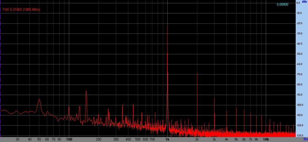

So far as the measurements.. my application is 150mVpp to the grid, horisontal load line. If you can run it again with those parameters, great.
So far as 200Vpp levels of drive, I do understand, and each to their own, but I would use a low Cin and low mu DHT, something like 71A. Stacked supplies without cathode (fil) bypass and <2kRp. Takes an additional stage, but so long as it is a good stage, IME it sounds just as direct, okay maybe some slight loss, but more different than 'loss' but very much more effortless and less strained on peaks.

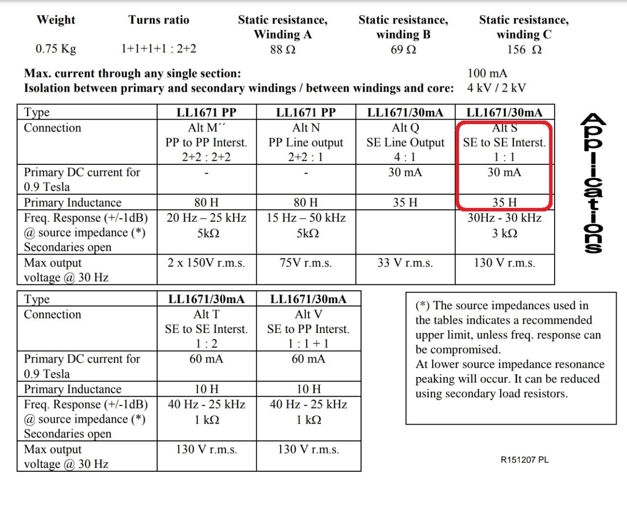

Today my amp is D3a , RC copling , 45 , Lundahl 1671 coupling , 300B , Lundahl 1664 OPT.

200vpp are more than enough to drive the 300B.Larger than 198Vpp?
Larger than 198Vpp?
No, not more than 200vpp

E55L is 600 ohm and would also work, but if you go too low with the drive impedance you have resonance issues, which some winders describe as 'benign'. Always struck me as an interesting word choice.
