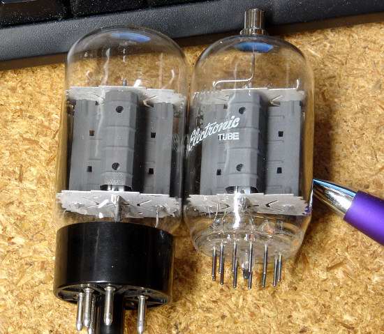

I have too many tubes already, but I couldn't resist this one. At the risk of making them all dissapear I'll mention this. There is one sweep tube on Stan's Dollar list, so I got 10 when I was in Orlando. Guess what guts are inside the glass?
6FW5 on the left. mystery tube on the right......
Have I got anyones attention? Number? OH, you want the number? It is the 6GV5. I am going to make some of these glow. How many watts can I get? It will be a few weeks before I find out.

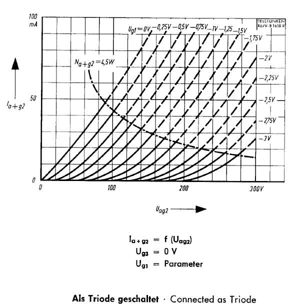

From the plate curves, it seems I would need a bias voltage in the range of -10V to -12V
So I would need a string of 6 red LEDs or even a matrix of 6x6 red LEDs to obtain the bias?

I think you looked at the wrong datasheet. From the plate curves, you want to bias between 1.5V and 1.75V.
http://www.mif.pg.gda.pl/homepages/frank/sheets/128/d/D3a.pdf

Yes, I have read the datasheets. But have you noticed that they put a +10V on the grid to generate the plate curves. If you calculate the voltage drop across the 470R cathode resistor, 20mA would cause a drop of 9.5V.
Correct me if I was wrong, the actual bias voltage from the plate curves should be -(10V + the grid curve voltage).

You are, of course, welcome to do what you want. The datasheet is as it is because in the 1950's when the datasheets were written, big electrolytics, as would be necessary to bypass the small resistor necessary to create a bias of 1.5V at 15mA, were expensive and terrible. So, they biased the control grid positive such that Rk would be in the 1K ohm range rather than in the 100 ohm range.
However, this is a board meant for measurement, so you can build one with a +10V grid bias, an input cap, and a small Rk bypass and another without the input cap, a small Rk, and a larger Rk bypass and see what happens. Maybe there is more to it and the + grid bias is beneficial in other ways, too.
