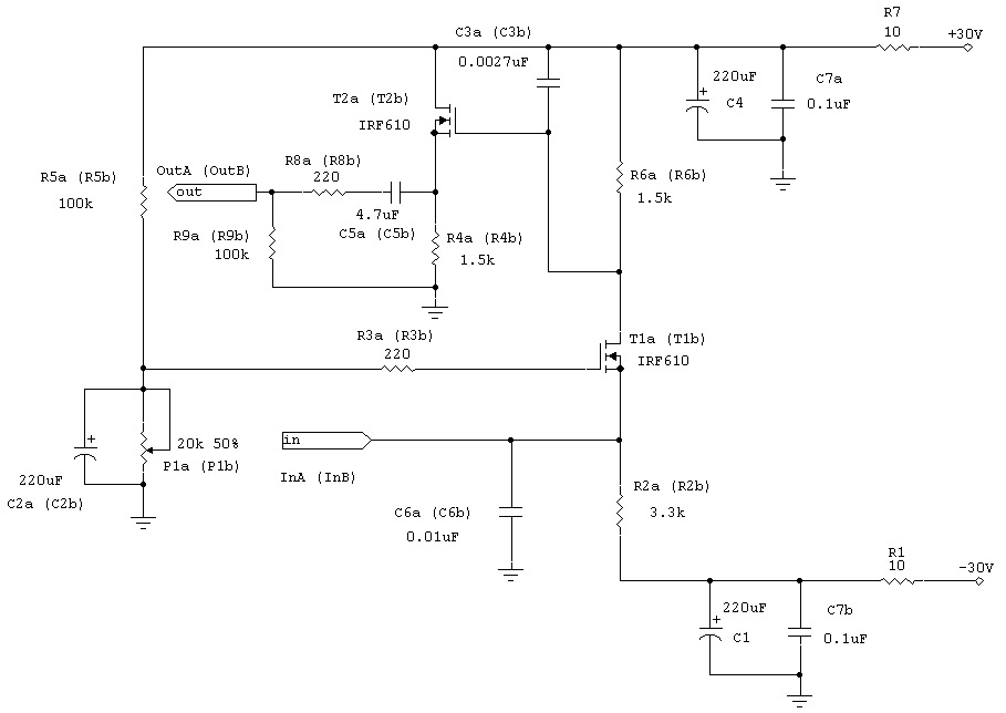

Hello,
I am new member in this forum and I should have a short question.
Can I use the D1 i/v converter for the AD1865 without any modification or not? Because the AD1865 and PCM63 Ioutput are different.
