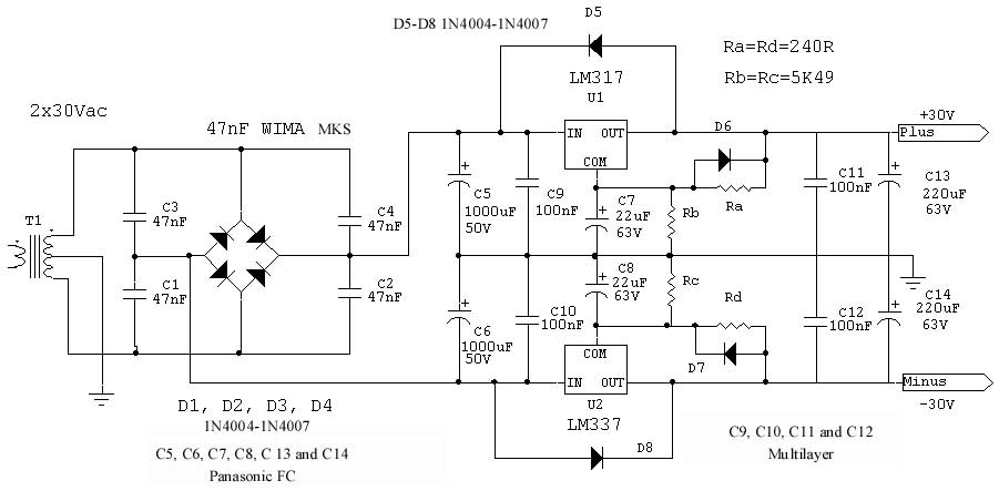

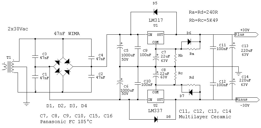

for power supply with LM317 I use the following
In place of RA, Rb, Rc and Rd use 2 trimmers to set the voltage correctly. I think that Rb and Rc shouldn´t be exactly the same or you dont get the voltages matched all the time.
Parts dont give symmetric voltage.

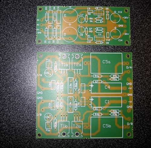

This is the PSU.
I didnt change much.
Made some pads bigger for better soldering.
The holes are now correct for the parts with thick terminals.
There are 2 more holes for bigger caps.
10uF MCap from Mundorf can be used on the board.
The Ground track is corrected.

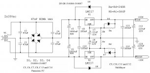

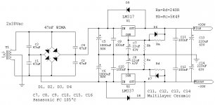

Hey, your Ra to Rd are not placed for multiturns...
Btw, what value are the multiturns? The nearest is 5k.
Hi, I was trying to make a parts list for the PSU. The scheme and parts list are not telling the same thing.
First, in the parts list, there are no 47nF while in the scheme there are. In the scheme, you call some 220uF electrolytics some multiceramics.
Other things like this are on it. That's the other kind of problem I encounter when trying to do a parts list.
DragonMaster
Ra to Rd are normal resistors.
The tip to use multiturn resistors was if you make it yourself.
47n are the caps across the diodes in the bridge.
the multilayer are 100n across the input and output of the ICs.
That doesn't tell me why some 220µF caps are listed as multilayer ceramics in d1psulowres.jpg
ok now I found it
C9, C10, C11 and C12 are multilayer
and C5, C6, C7, C8, C13 and C14 are Panasonic FC.
I will get a new schematic uploaded.
