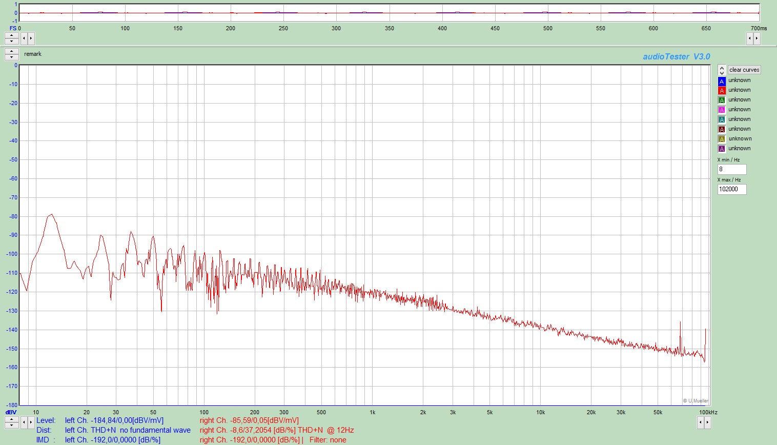

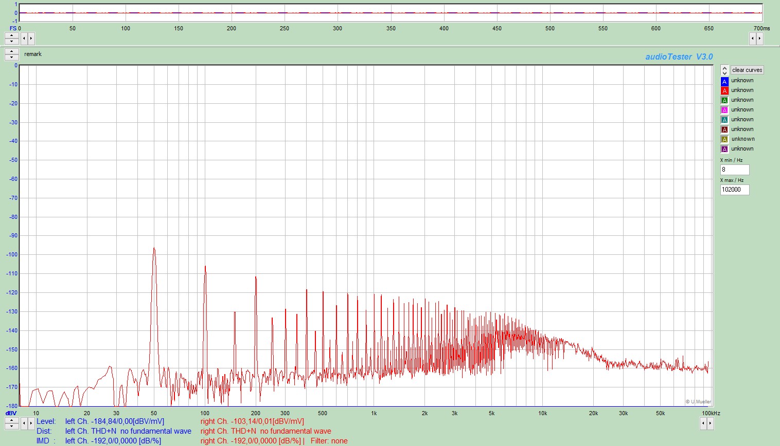

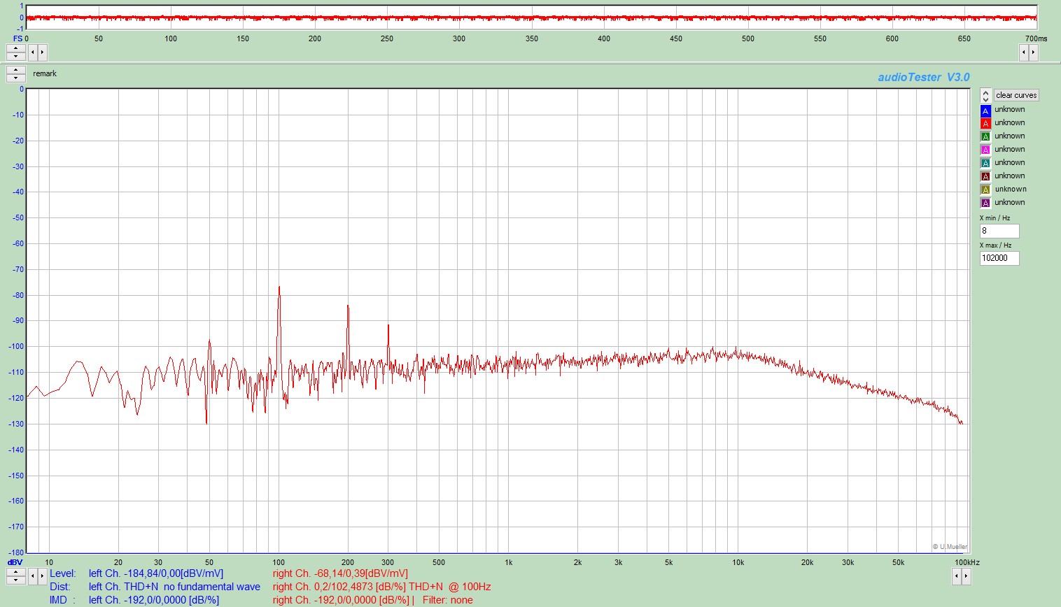

Ok, time for another set of measurements.
While I was servicing my Revox B77 reel-to-reel tape machine I noticed the LM317 supply and it dawned on me that I just have to try the denoiser (as they say "when you have a hammer everything looks like a nail" or "when you have a denoiser everything looks like a LM317 power supply") 😀 For all of you already rolling on the floor laughing this is just a technical experiment. I do not claim that reel-to-reel tape would benefit from a denoiser 😀
The measurement setup is the same as earlier (60dB LNA with MAudio ProFire 610 soundcard).
1. Baseline (regular B77 supply i.e. LM317 with Cadj)
2. Without Cadj. Noise is significantly higher.
3. With add-on denoiser (single BJT). Nothing to write home about, slightly lower noise above 10 kHz.
4. Add-on denoiser with sense wires attached to B77 mainboard. Much lower noise floor. The spikes seem to be 50/100hz related. These may be very difficult to eliminate considering the layout of the B77.

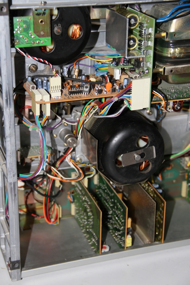

5. Picture of the B77 internals. Denoiser can be seen next to fuses. As can be seen the environment is quite hostile. Power supply board (and the denoiser) sits attached to the main power transformer surrounded by lots of motors, relays and solenoids.
I guess the moral of the story is that add-on denoisers without sense wires may not perform as expected. And even with sense wires the results may not look as pretty as in simulations. And before anybody asks, I do not have anything to say about the sound before or after 😀

Yes those are the original Frako caps. Even after 30+ years of service they measured spot-on. As part of the service I checked most (if not all) elkos. The only one requiring replacing was actually the Cadj cap in the LM317 supply 😀

I don't have a suitable dienoiser ready (i.e. having sense wire capability). It might lower the noise floor further but I doubt it would improve the 50/100hz related spuries.
Can you improve your test setup reduce the 50/100hz spikes example screening the power supply / sense cables?
The denoiser improves key parameters by 30~35dB, BUT as is often the case, your mileage may vary/the devil is in the details:I guess the moral of the story is that add-on denoisers without sense wires may not perform as expected. And even with sense wires the results may not look as pretty as in simulations. And before anybody asks, I do not have anything to say about the sound before or after 😀
If you connect the denoiser directly to the LM317 (negligible wiring length) AND you measure the noise exactly at the same spot, you'll get the advertised performance; if you make the measurement at the point of load, anything could happen: the denoiser has no way to know and correct what happens downstream. The cabling could catch noise on its way, the load itself might introduce pollution, etc.
If you use a Kelvin-like connection, as you tried, it allows in principle the denoiser to sense the nasties directly at POL, but you need to keep a number of things in mind: the denoiser is basically a 35dB amplifier. Any noise caught in the input circuit will thus be amplified and appear at the output of the regulator.
For that reason, it is essential to minimize the input loop area to avoid catching and amplifying magnetic perturbations.
The way to do that is to twist together the hot and GND sense wires (and avoid hotspots, like the vicinity of a transformer).
Secondarily, it is desirable to make that twisted pair follow (broadly) the path of the main supply wires. Failing to do so will create another loop also able to catch disturbances. They won't be amplified 35dB, but if they are large they could contribute to the 50Hz pollution and its harmonics.
The sense wiring was a screened cable (i.e. hot and GND on separate wires surrounded by screen grounded only at other end). The path followed more or less the main supply wiring. However the main supply wiring goes through a pair of PCB connectors which may have degraded (oxidized) during the 30+ years.
