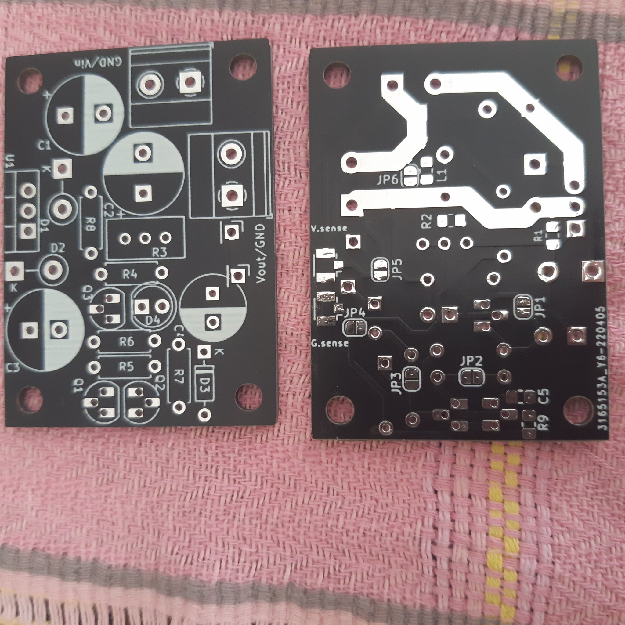

If anyone used it, is thete a jumper I have to open or close when not populating the bc327 ccs please ?

Forgot to mention that the CCS allows to set the circuit for good performance at lower Vout ( needed in the 3.3V-10V Vout range). You can use BC3x7 pair.

You will also need a board with the rectifier and main caps. My latest board designs have DC input only.

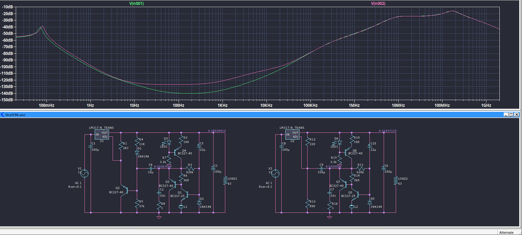

Hi Trileru,Here's example values for 6.3Vout with and without the Nonoiser way of setting Vout.
That one seem very good
did you try It In practice
would you recommend V (n002) variant (as It Is simple) for powering digital supply of dac with 5 Vdc
