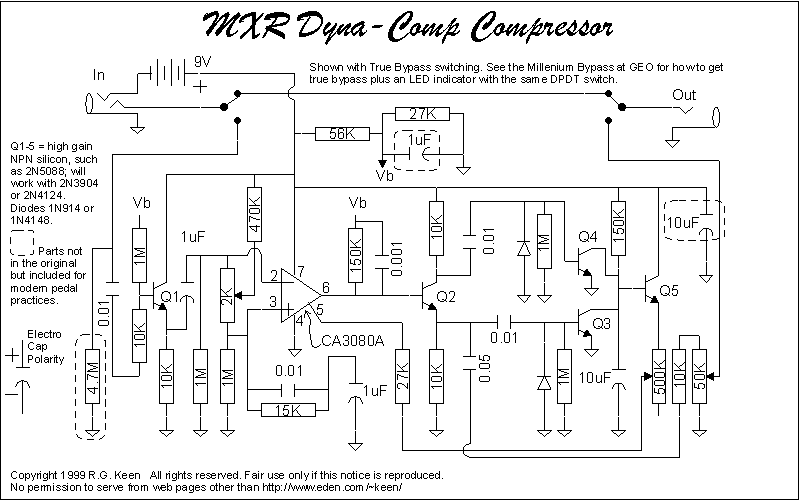

I would like to build a basic compression pedal for a bass !
Is it feasible ?
If so , can you recommend a schematic , or How To video ?😕

I use this circuit with my guitar and I just love it. At the right settings it brings the harmonics up for a rich complex sound, I am drooling thinking about the squish!! 🙂
Thanks ! I will try it , first chance I get .
Do you think it is feasible to attempt building it ?
I have a basic knowledge of electronics , but I have been an electrician most of my adult life !

tonepad -- FX projects
I didn't buy a board but having a PCB might make things easier for you than going p2p.
http://smallbear-electronics.mybigcommerce.com/pcb-tonepad-ross-compressor/
