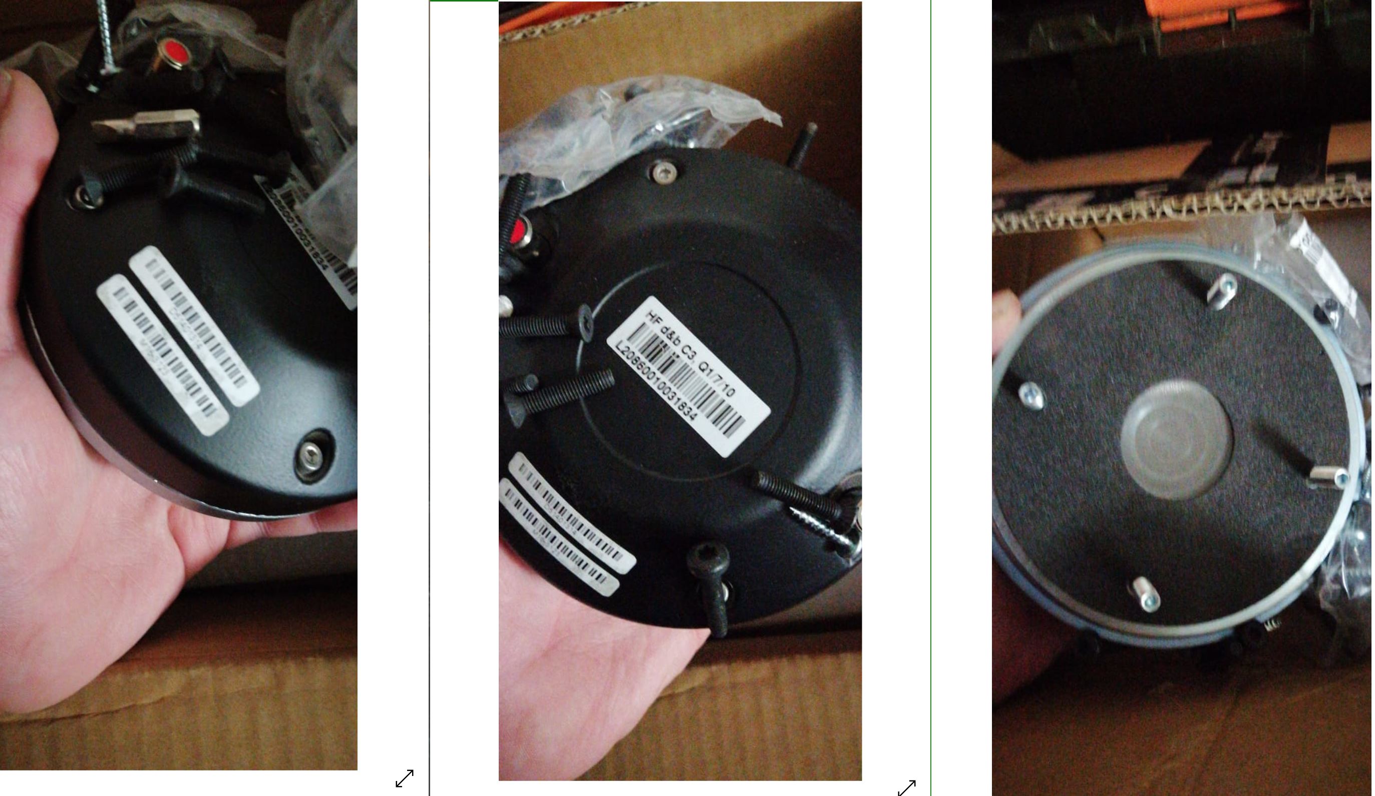

I am interested because someone is selling somespare parts in my country at a good price, but my use is strictly home theater use.
I attached the pictures the seller sent me. If you ask me, they look a lot like B&C, in fact the B&C DE910 looks spot on.

Thanks for your replies!
I am interested because someone is selling somespare parts in my country at a good price.
I attached the pictures the seller sent me. If you ask me, they look a lot like B&C, in fact the B&C DE910 looks spot on, and the woofer looks like the 12NDL88.
The HF Device is B&C DE910
The Low Device May be 12NDL76
76 and 88 magnets are different. Can't see a clear picture
But it is definitely 12NDL
