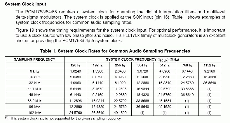

thank you for the explanations. if i want to change my D/A converter what D/A can be used. I would like to know where do you found this information (48x RJ for KS9211) in datasheet. If i want use PCM1730 he does not function too. thank you! Maxpou
