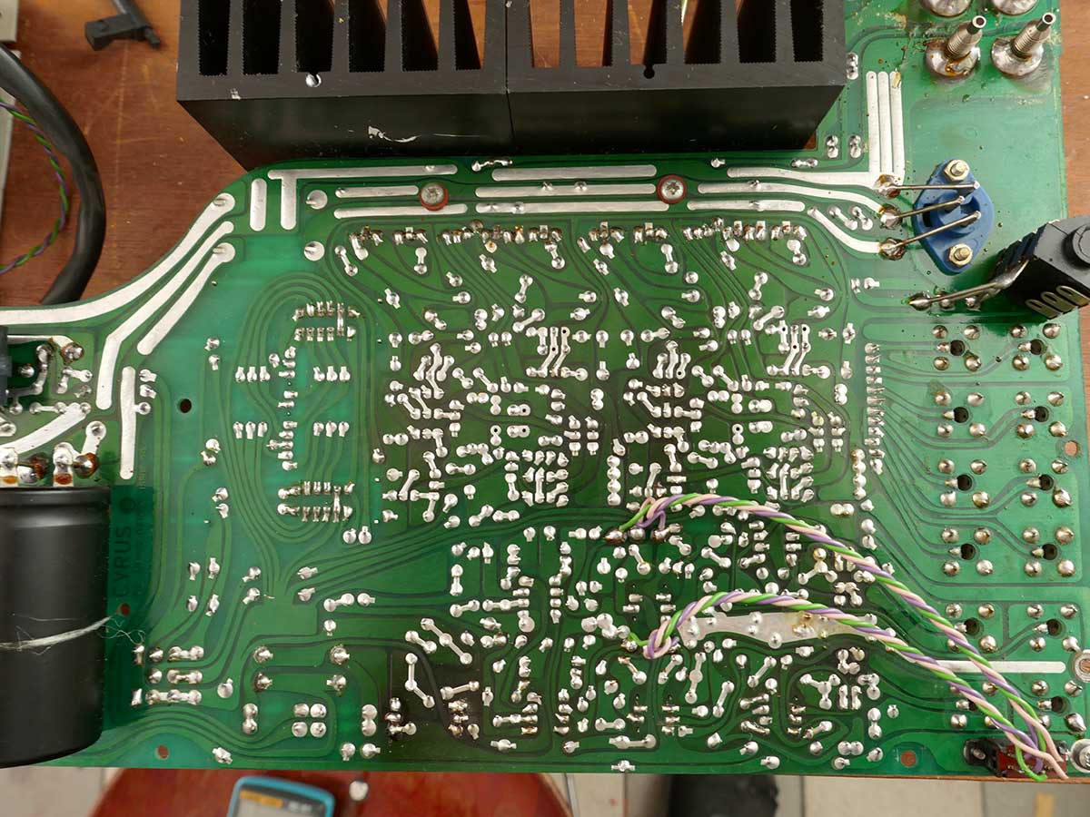

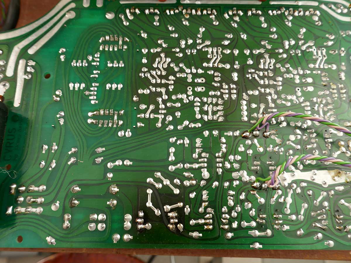

I got Cyrus Two (issue 06) with problems. The previous owner said that only one channel works. I tested with headphones and both channels work however one is significantly lower in volume. And there is some distortion.

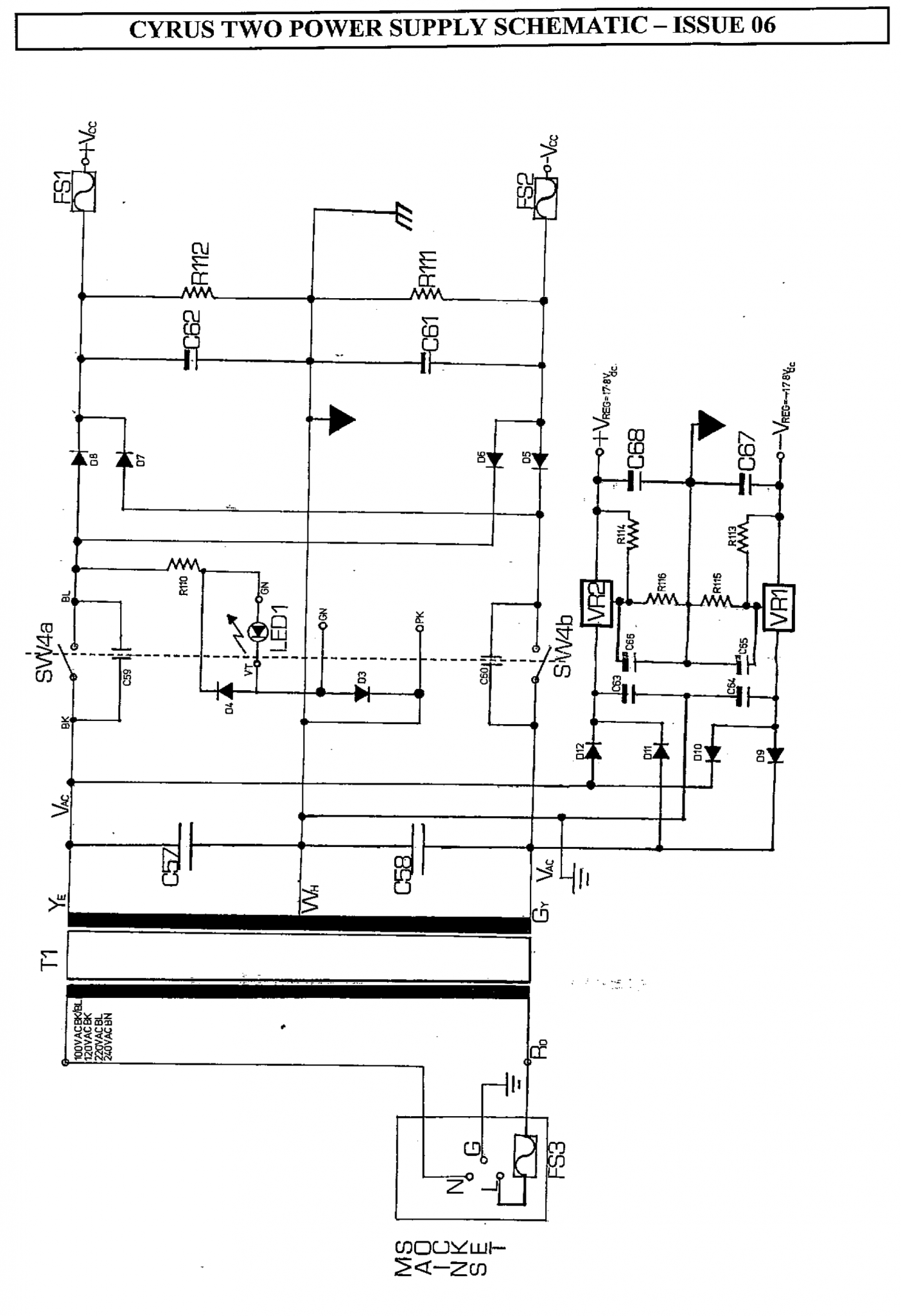

When I look at the PCB it is clear that some parts have been overheating. First test of Power Supply goes fine until voltage regulators VR1 and VR2. Both put out (+-)17,8V. However these VRs are overheating fast.
I remember reading that these VRs are not very good and could be replaced with better contemporary ones.
The problem is further down the line somewhere. I wonder if there is a obvious place to check first before I start to to follow the signal path step by step?
Some picture to go by.

As I understand these VR1/2 regulate power for Phono stage only. All the rest gets the power from D5/6/7/8. So by unsoldering VRs I just break the connection to power for Phono preamp. Since these have seen rather high temperatures I would replace these anyway(at the cost about 1EUR each).

How experienced are you? Regulators can run hot because a load capacitor is leaking. The cyrus load capacitors were built in 2005, to go by date code on the 5332 IC.
Willy nilly replacing parts that haven't been measured bad , especially semiconductors, can insert a lot of soldering errors on your board. Did you measure the voltage out of the regulator? Match the part name? Measuring DC power supplies is about step 3 of the debug procedure, right after checking the fuse. Besides, I bought a load of ON semi regulators that had the same name as the others, but had half the load current rating. Suffix 2nd letter meant the part was ****.
Indeed the red ROEs were at fault - cracked and out of specs. Replaced these and voila both channel work. So many thanks for this advice!

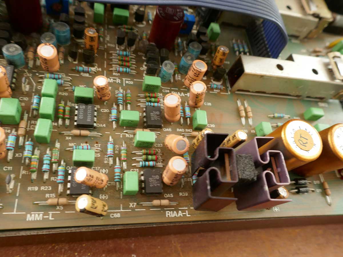

I replaced all ROE el caps in Phono power supply. However the problem is still there. VRs heat up fast regardless giving out right voltages. So next is the Phono stage el. caps. These are Elna bipolars so how critical is the quality - it may not be easy to get these?
jaycee, did you mean to bridge the 470uf caps with 100nf? I made a mistake to indicate part numbers - C67/68 are 22uf while C63/64 are 470uF.
