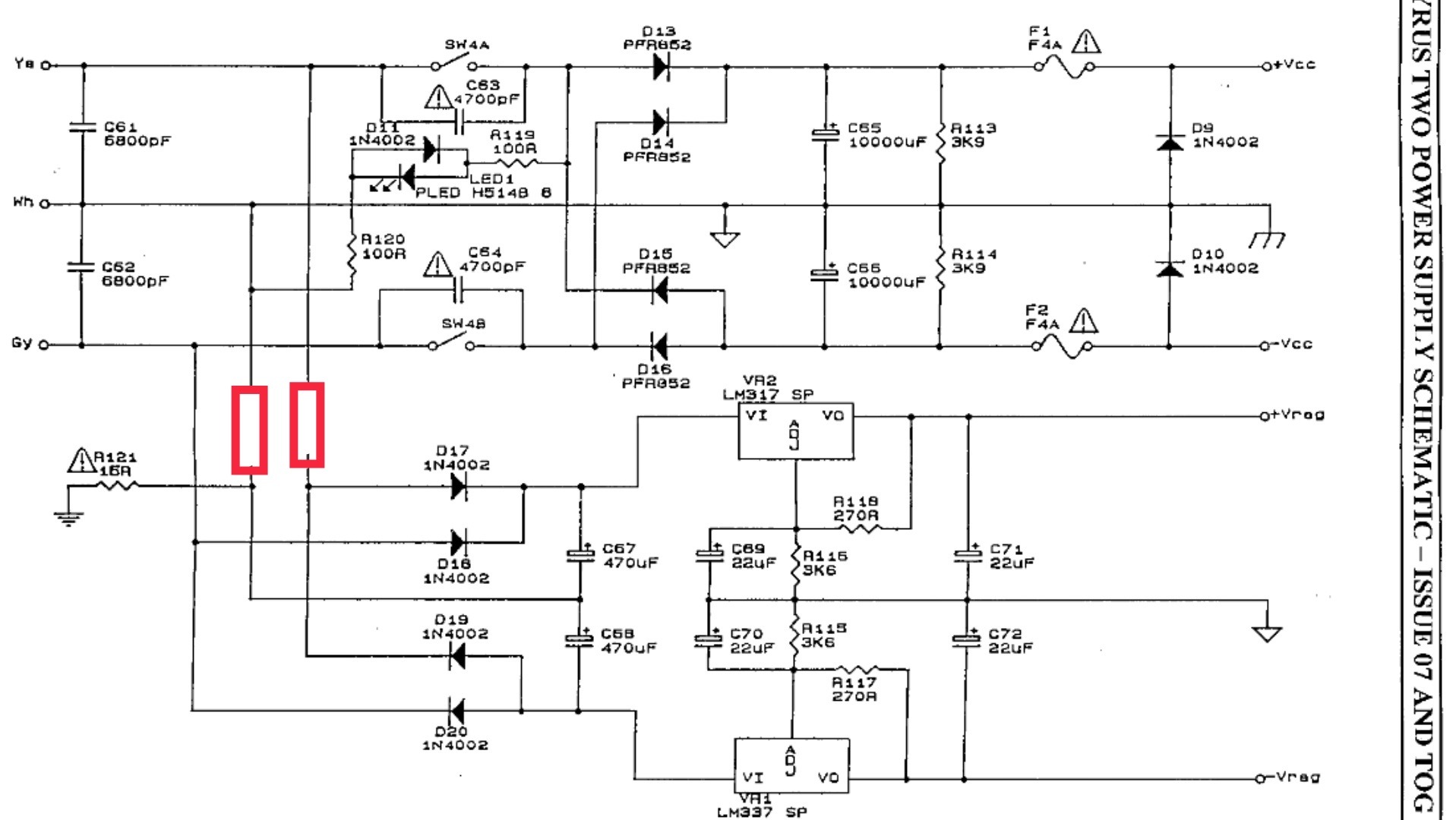

There are other issues that give me pause. The regulators and their output caps seem to be under suspicion; are they innocent, and only the MC stage(s) at fault? The supply bypass caps on the MC stage seem unusually small, and I don't see any bypass for the other opamps indicated on the schematic.
Well, the regulators are another PITA. They run pretty hot, reducing the voltage from appr. 40V to 18V. I'm considering adding a series resistors to help them a bit, although there is not much space there to do it clean. The same is with additional bypass caps. One could stay on the underside of the pcb, but a tidy way it isn't🙂
Found two very convenient zero-ohm links in the supply path of the regulators in front of the rectifiers. Two 47 ohm resistors here have about 4.5 VAC drop across them, the regulators feel better now .A better way would probably be a smaller transformer with 20V secondaries, since the guy uses a PSX (an external power supply for the power amp section), but I don't want to modify this old beauty so heavily🙂
