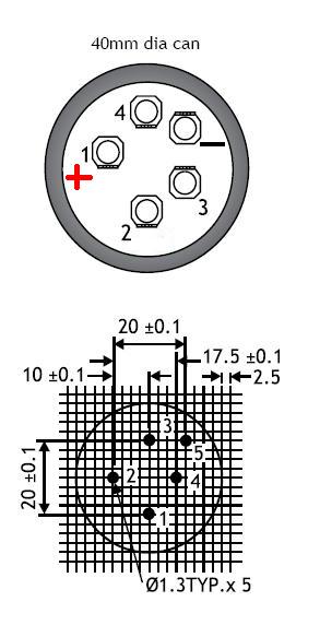

The picture below is of the newer BHC pin configuration. It is quite similar but will not fit!!!!!! Just a couple of mm out of alignment.

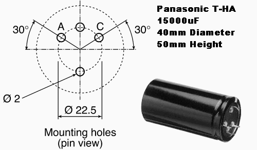

The originals have the +ve and -ve pins ~22.5 mm apart.
I am looking for.......
15000 - 22000uF
50V or more
max height ~67 mm and 40 mm diameter or less.
The + and - terminals are not centered with the -ve being close to the edge so I would prefer 35mm diameter if possible.
5 pin caps do not fit.
3 pin caps do not fit.
I cannot find 22.5mm 2 pin caps that are short enough to fit inside the case.

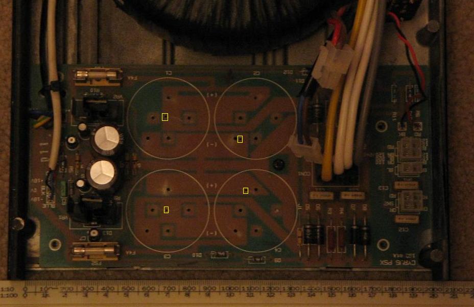

Can you post a picture of the pcb copper where these caps should fit in?
From all the supplies I have seen until now, you should have quite certainly have two points you can drill, according to the pin positions of the caps you have (Panasonic, etc.). Just do that and solder the new caps.

Hi Carl, thanks for the advice.
I have already posted some pictures here (post 25 etc.):
http://www.diyaudio.com/forums/attachment.php?s=&postid=1118466&stamp=1169998881
You can see from the photo that it will not be easy to fit four 10 mm pitch caps on those rails. It is hard to find 22.5mm pitch caps. It is made extra difficult because the +ve and -ve terminals were not in the center of the original.
I don't want to mess this up.
I will take a picture from the top with the caps removed.

I finally plucked up the courage to drill the board and have also scraped away the insulation (solder mask?) from the underside ready for new caps. It is ready now for 2 pin, 10mm pitch, 35mm max Diameter caps. I wish that I had just done this sooner but nerves got the better of me and clouded my judgement.
Thanks Carl for your advice.
I have forgotten about the BHC caps and all the multipin types.
The final fitting will not be perfectly symmetrical but I can make it work. Maybe you can see why I had the problems...........
Each white circle is 40mm diameter.

There shouldn't be much of a problem for changing from 15000 onto 22000uF. The strain will mostly be on the bridge/diodes and the power switch.

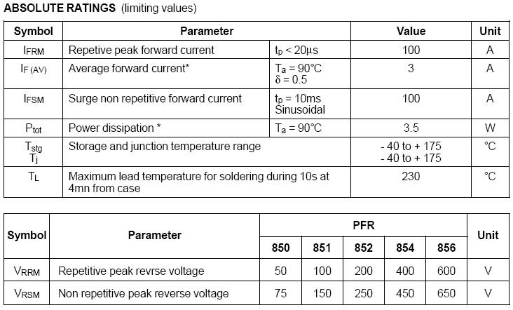

Thanks for the advice on diodes etc. I think my new ones should be up to the job. The power switch is rated at 10Amps. I can relax now. 😀

Changed 8 large diodes to BYW80-200 20 Amp 35nS with heatsinks. (TO-220).

I wouldn't parallel the new diodes as they are man enough on their own, and parallel diodes is not a great idea really. I'm surprised they didn't just do it right in the first place with a single adequately rated part.
I cannot recommend the dual rectifier and a pair of cascaded single polarity supplies.
The single rectifier works just as well in the tests I have carried out and I know from the trace layout on your PCB that the design has been optimised to get the best out of that single rectifier arrangement.
The dual rectifier will cost twice as many diodes and loses an extra 0.7V off each rail. There is absolutely no gain in hum susceptibility nor in buzz attenuation.
Well, it's not only recommended on those articles that I mentioned, as it's also recommended for "Gainclone" projects, in the Chip Amplifier forum. I mentioned that on another thread.
The only additional cost would be to cut the copper trace as it is now, because the number of diodes would be the same he is presently using.
Im really just starting to study power supply theory at the moment and I'm in no great hurry to heavily mod the rectification beyond the current setup .......... for now.
What is the disadvantage of parallel pairs? I know that one will always conduct more than the other due to heating effects but I don't see that as a problem here. Is the problem that both diodes will conduct at slightly different times creating more noise and maybe R.F.I.? That's just my best guess but I'd love to know more.
I'm really interested in snubbers and bypassing but my Tannoy's suffer badly from sibilance so I don't think that I could be completely objective until I get this sorted out. Could someone suggest some arbitrary values just to test wether the sibilance lessens or other things change?
Trial and error would probably be a fruitless exercise 'til I can remedy the 'Tannoy honk'.
Kind regards,
Martin.
richie00boy said:I wouldn't parallel the new diodes as they are man enough on their own, and parallel diodes is not a great idea really.
Kind regards,
Martin.
