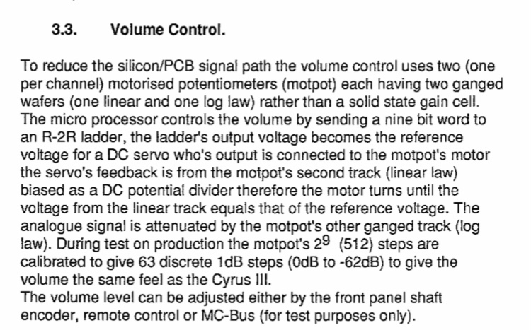

However, ever since I had the amp the channel matching is not perfect. Apparently it is calibrated at factory but that was 20 something years ago. I found the Maxim DS1882 which has 63* 1dB steps the same as the Cyrus Pre. I could drive it from an Arduino to give the attenuation.
Also, am I right that the capacitor (C311, C312) in the op-amps feedback will be performing a similar function; providing high gain for DC or slow changing signals (i.e. the desired DC voltage) while giving very low gain for quick changing AC signals (arcing)?
Just to educate myself I might try sticking a far bigger cap in the op-amp feedback and see if the potentiometers respond slower.
If you're able to Arduino, then surely you could have a peek at the NVM data, copy it as a backup and then fiddle with the values to see if the calibration lies there.
The data won't have changed (unless the NVM has died partially) , but if it was poorly calibrated then surely it can be adjusted to trim the calibration.

I think the cap will be to ensure Nyquist stability of some sort... in much the same way as CD player tracking and focus drive amplifiers do. All are systems with a mechanical feedback loop that needs to be made stable.
The voltage on the pot wiper is assumed to be a smooth value but if the pot is dodgy then that is not the case. I would just try it and see. You have nothing to lose by experimenting.
The opamp is a PI controller, the cap defines the integral gain and the resistor in series with it the proportional gain. The zeners provide hysteresis.
In normal operation (with a working pot) the circuit will drive the voltage up until the zeners conduct and smoothly increase motor drive till it turns. When the thing overshoots the resistor is responsible for immediately stopping the motor I think, and then the process repeats, the capacitor acting as an integrator for the error.
This means it should repeatedly readjust by tiny amounts as the error integrates on the cap. Not sure why it was designed that way. Perhaps I'm missing something - perhaps the opamp gain is low enough that the hysteresis on the output is enough to prevent this "hunting" behaviour normally?
You could try adding a high value resistor across the capacitor to reduce the DC gain, perhaps in the 10M region.
[ A theory: deterioration of the feedback capacitor over time could have led to hunting behaviour starting up (I like to think its not meant to), and this wore out the track(s) and made things worse. ]
The integration timescale is about 1.5seconds so you might expect a tiny amplitude of jitter on that sort of timescale I think, micro-movements of the motor only.
With the pot flaky you only have the pin capacitance of the JFET opamp to smooth things out (it would be much worse with a bipolar opamp, note). Try a few nanofarads on the wiper perhaps (JFET inputs are high enough impedance that that ought to be plenty). Do not substitute a bipolar opamp(!)
