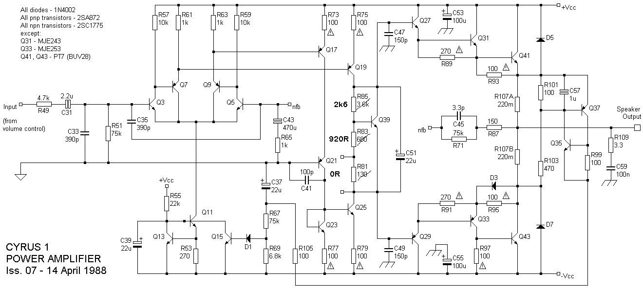

The trim resistor R81,82 has been removed in manufacture so the service manual is simply wrong for this board. The bias sub-circuit increases current in the bias transistor to reduce bias voltage across bases Q27,29 and Q28,30.

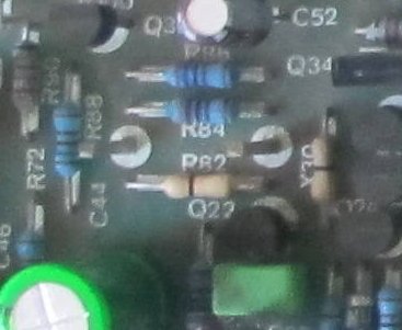

But R81/82 have not been removed! R81/R82 are NOT the 220R resistors that we have seen sitting high up in between the pins in the very first picture (close up) because in the overview picture in pampalini's second post, you can see they're not there.
The way I see it is that the silkscreen R81/82 is closest to the 0R resistors, and that the pins themselves have no reference designator. They are parallel to R81/R82, though, that's where they're drawn in the schematics.
That makes the situation as follows:
R81/82 schematics: 130R - but here: 0R;
R83/84 schematics: 680R - but here 920R;
R85/R86 schematics: 3k6 - but here 2k6.
The fact that R81/R82 are 0R explains why parallelling them as no effect and why pampalini measured 0R between them, had they been 130R, the instructions in the service manual would have been useful. That's why I suggested replacing all resistors first. And yes, it's also why measuring there would be no good.

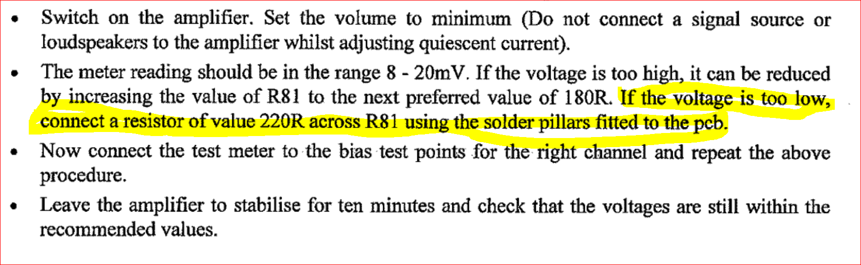

I did mesaured, as stated in the service manual, the bias across the big white .22 ohm resistor (part A).
The 220 ohm you see in the pix is my attempt, once again as stated in the service manual, to increase the bias. But, as the 81/82 resistor in my unit is 0, putting a 220 ohm resitstor in parallel, provide no effect to the bias current.
..so, once at home, I will measured the resistors, compare them with the list in the SM, and then think what to do....

Sure, the actual values of R83,84 and R85,86 appear to be different from the schematic - I cannot be certain what they are but R81 is gone. It is now a link.
My reasoning regarding the manual refers to the original design which it appears to do also so the bias adjustment according to the manual and attempted by the OP didn't do anything. I think that's clear enough.
