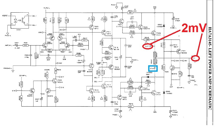

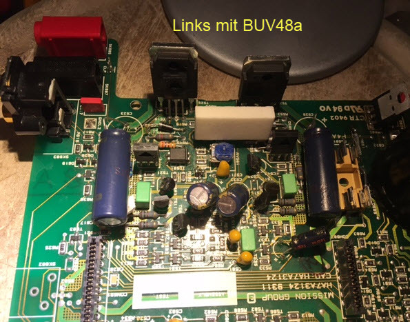

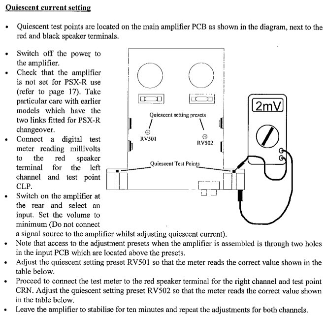

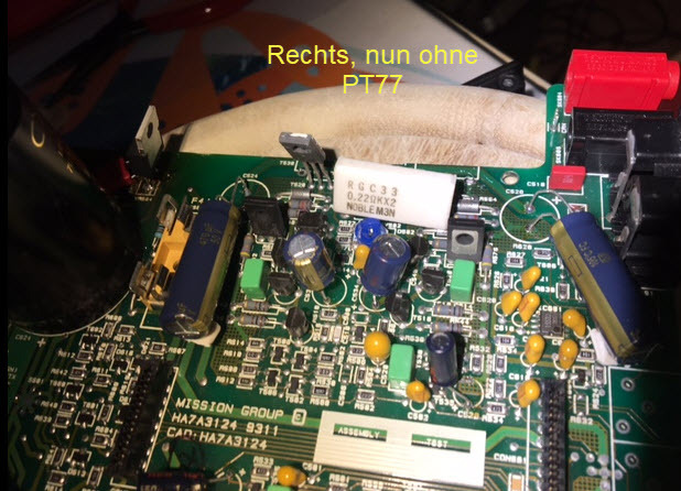

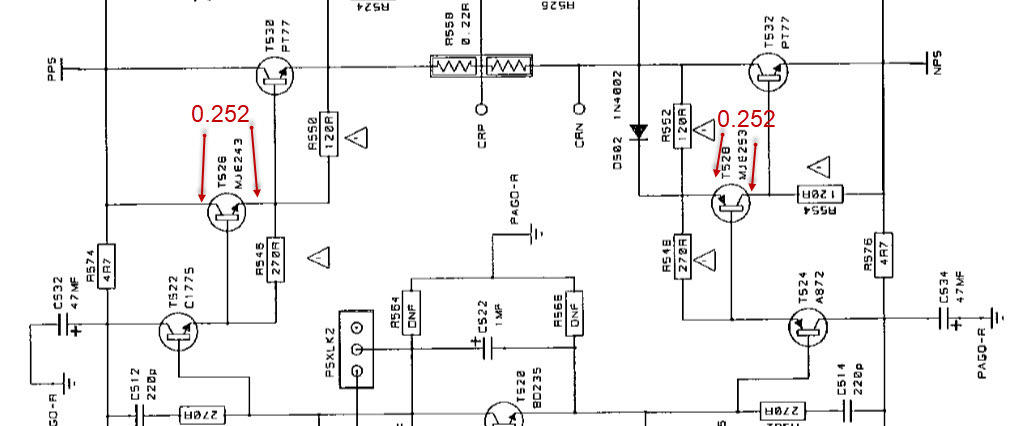

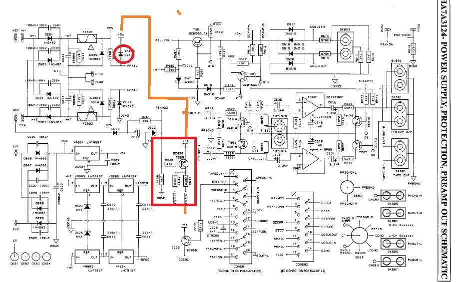

Genuine Circuit Diagram for Cyrus III - now online
http://bilder.hifi-forum.de/max/860950/planauschnitt-links_787907.jpg
found by
Cyrus III - Defekter Ringkerntrafo - Help!, Hifi-Klassiker - HIFI-FORUM (Seite 3)
(Report of a repair procedure in German language)
found by

What the heck has been done to that poor little amplifier?!! That is barbaric!
What are all the red circles about? I know some things that should be circled, and they ain't it. I'm sorry, but I am not allowed to share.
Even when the right information is obtained, you can't trust what people not in the know say on the internet! It the unit pictured showed up on my bench, those big parts would be replaced. If not I would refuse to work on it. Don't do silly stuff to your equipment folks. Cyrus designs are fairly advanced and not like the normal stuff you will run in to. Unless you truly understand the circuit, don't go around changing anything from the original design!
-Chris
