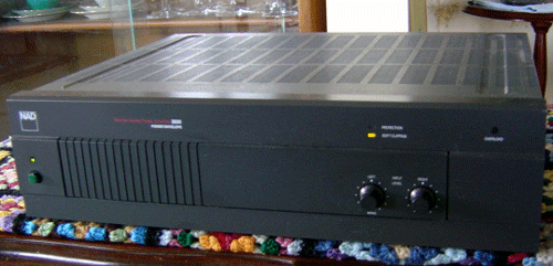

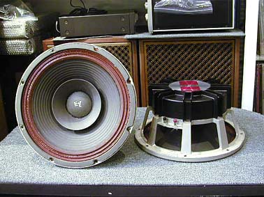

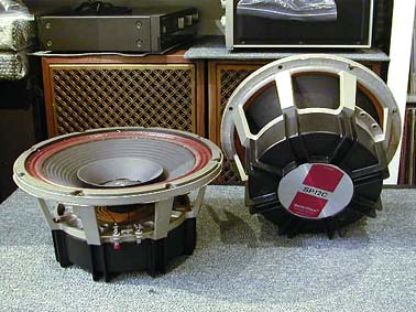

Yes, but that is not the reason, why I intend to reduce the supply voltage to half its value (a suited tweeter attenuation is already integrated by the presently passive crossover).
The reason is only to get an enhancement of the sound quality through bi-amping and forcing the idle current.
The transducers are vintage ones from Electro Voice. The tweeter is the "T350" and the bass-midrange the "SP12C".
for driving the SP12C the power amp is the NAD 2600.
That means, the preamp section of Cyrus V drives the internal power amp for tweeter and the external power amp for the SP12C.
This is already realized. But the external Cyrus V power supply and the increase of idle current has not yet been executed; I hope to get therefore a schematic from anyone. Maybe you know someone who can get this.
