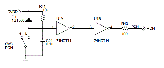

Pins 15 and 16 are the the clock select pins. Any change to them that exceeds 3 MCLK cyles generates an internal reset. Shorting them changes them from 1,0 to 0,0 , changing the selected MCLK frequency and back again, enough to generate a reset.
Tying PDN permanently high would defeat the pins function as the power on reset pin. It needs to transition from low to high at power-on to initialise the chip. The image below is from the AKD4103 evaluation board.
It looks like in the CD6/8 the PDN Signal is derived straight from Pin 20 of the Main Micro.
There's an internal Pull-Up Resistor within the AK4103 so a straight connection to the Micro. A bit of broken track or a dry on the Micro might be my trouble?
I'll take a look at what's happening there when I next get the chance.
Thanks again,
P.

Checked for broken Track between the Micro and the AK4103, all OK.
The PDN Signal is derived from the Micro's /STANDBY Pin, PIN 20. This remains at +5V at all times. Even though the Player itself switches into Standby (Display OFF etc) when asked to do so.
It's a 'bodge', but if a 47uF is placed across the PDN Pin and 0V then the charging time for the cap allows the PDN Pin to become +5V with such a delay as to allow he AK4103 to 'turn ON' and therefore the SPDIF appears. It never turns off though even when the Player goes into Standby. But then the +5VCD doesn't disappear either (?).
I wondered about the Reset IC, IC508 so replaced this but still the same.
Main Micro ? I doubt I'd get one of these now. Would have to send the Player to Cyrus for repair @ ££ God knows !!!
It's 'working' now but it is a bodge of a repair and my curiosity would like to know what's going on.
