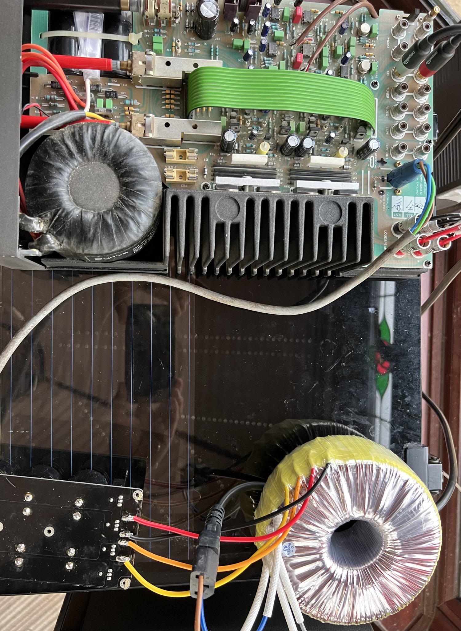

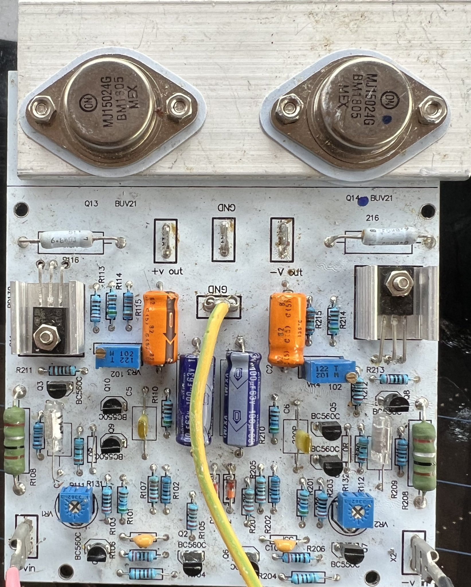

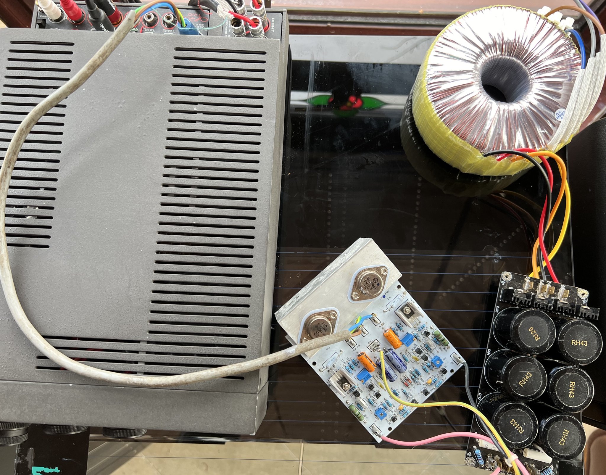

I am still playing with the power supply, using an old NAIM 135 clone voltage regulator board, I have set the power supply to exactly +/- 40V. There is further refinement in sound, could be user bias.
I wish I had instruments or know how to objectively measure this effect!

I'm always a bit skeptical about power regulator boards.
