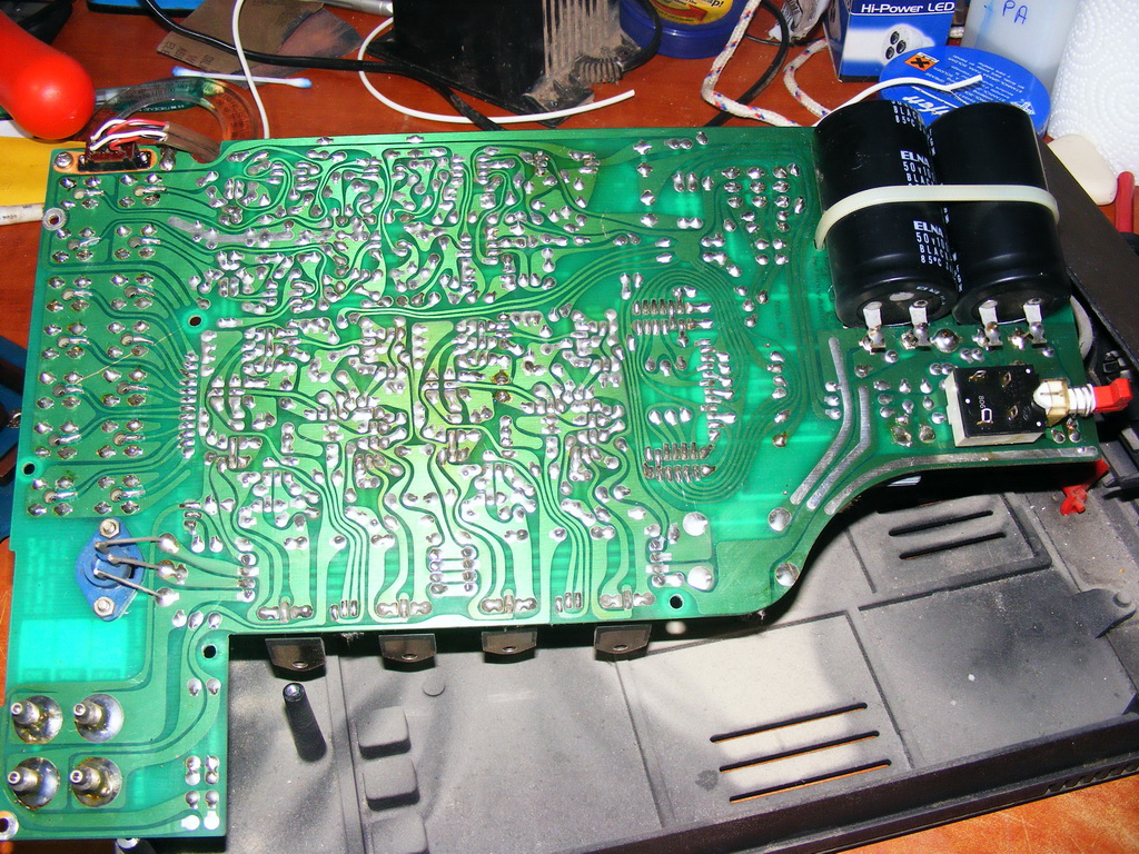

Unfortunately .........another issue appeared - the power board .
Ther is a strong pressure on one of the bass drivers left channel at medium to high levels.
The amplifier cannot be used in this condition.
Initially I thought to replace ALL transistors except for the power ones but eventually decided to bring the amplifier to a service.
The guy who once had repaired a Cyrus 1 initially gave the opinion that it is a power transistor that failed.
Hopefully it is not as I even don't know what transistors they have used.
They are not marked.
Will know how it goes in the next week and report here.

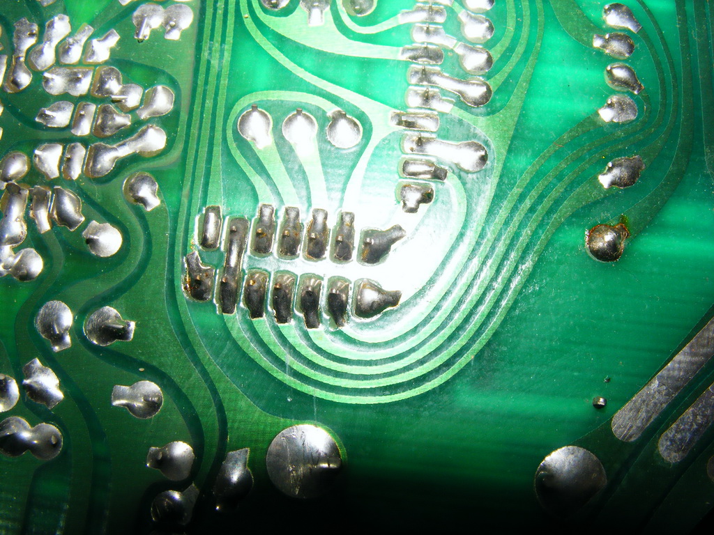

Today the power transistors of the bad channel have been checked ok.
The guy at the service said that the rest of the transistors also checked OK.
However he is unable to repair the amplifier .
He is giving up.
The reason is that there is a problem with a resistor (and yes - it smelled at home) .
I am taking the amplifier back home tomorrow .
Sent an e-mail to service@cyrusaudio.com asking them for circuit diagram and parts .
Will see how it goes .
The transistors up to the power ones are available.
I may need to measure all of the resistors of the good channel and make a diagram .
Then to replace the transistors in the bad channel or in both channels.
I have no clue what to do exactly to speed this up.

Aleko,
it's the same amp - there is no difference - differences exist maybe in the age of the amp, there were of course slightly different models over the years. Did you specify your amp exactly yet?
If a resistor is "smelling" that means that it is getting hot because the currants went off a lot. It is very likely the a transistor is faulty (and maybe also the resistor already).
I would like to help you more but I need much more information:
Which resistor gets hot?
Do you measure an output CD offset? (the "strong pressure" maybe...)
Did you or your technician measure the driver transistors?

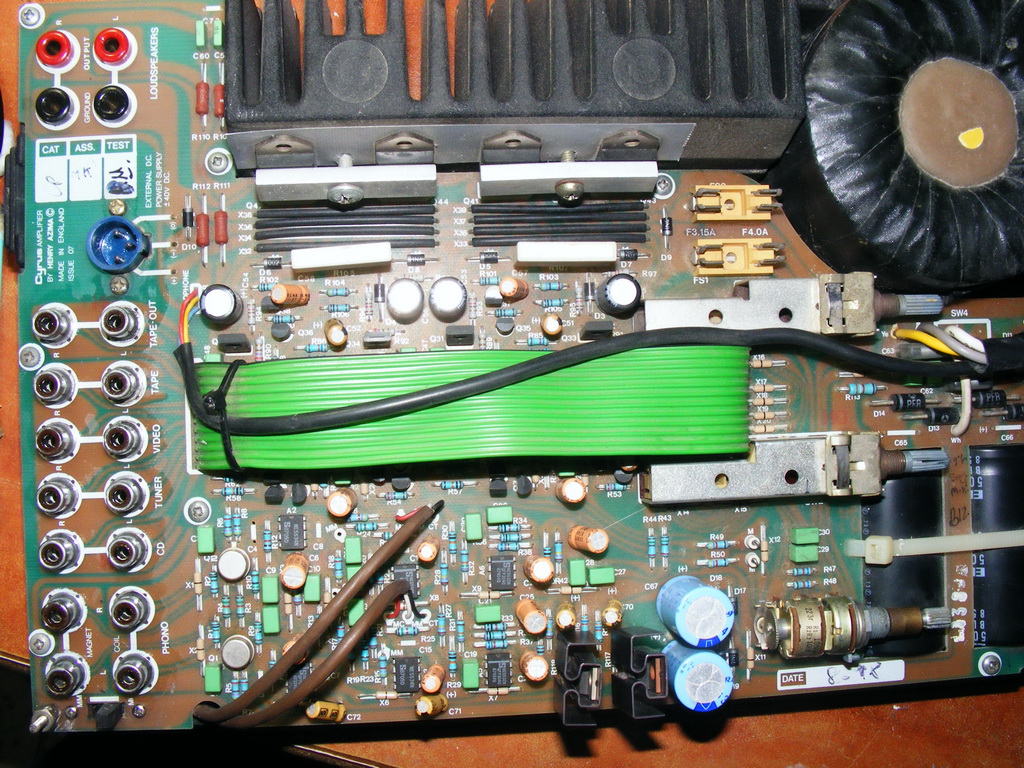

Hi Lohk,
I had specified the amplifier - yes.
In fact this appeared to be Mission amplifier and not Cyrus amplifier.
Anyway, need transistors ST 646 x 5 and 666 x 5.
These are the driver stage transistors for the right channel.
The left channel is OK.
The selector switch you sent appeared to be higher than the original .
It short circuited the power amp board.
Strangely enough what got damaged is the other channel...
The resistors almost burnt ( I had no fuses in the power supply!!!).
I will supply good resistors from Parts Connexion .
But the ST bipolar small signal transistors are not available.
Then do I need to know if they are PNP or NPN ?
How do I find an indication ?
Can you supply those transistors?
Or do you know wherefrom I can supply them?
Couldn't find them at the Mouser Electronics web shop.
Thank you
Best regards,
Aleko

Did you specify your amp as a Mission 778 somewhere? If this is your amp, I have very little information about it.
What has happened? The power amp cannot be shorted by the input switch (the power stage was not even activated). So something was fully wrong, which is beyond my imagination. I have no idea how I can help you here. Can you post close-up images of the pcb on both sides and post what exactly you have done?
I also have no idea which transistor you mean - I have never heard about the mentioned ones. The earlier Cyrus amps use ZTX753/653 for drivers, later MJE243 / MJE253, as far as I remember.
I am very sorry that my support created more trouble. But if you have soldered the switch into the amp without checking it and all possible connections and problems it is not my responsibility.
Klaus
Klaus
