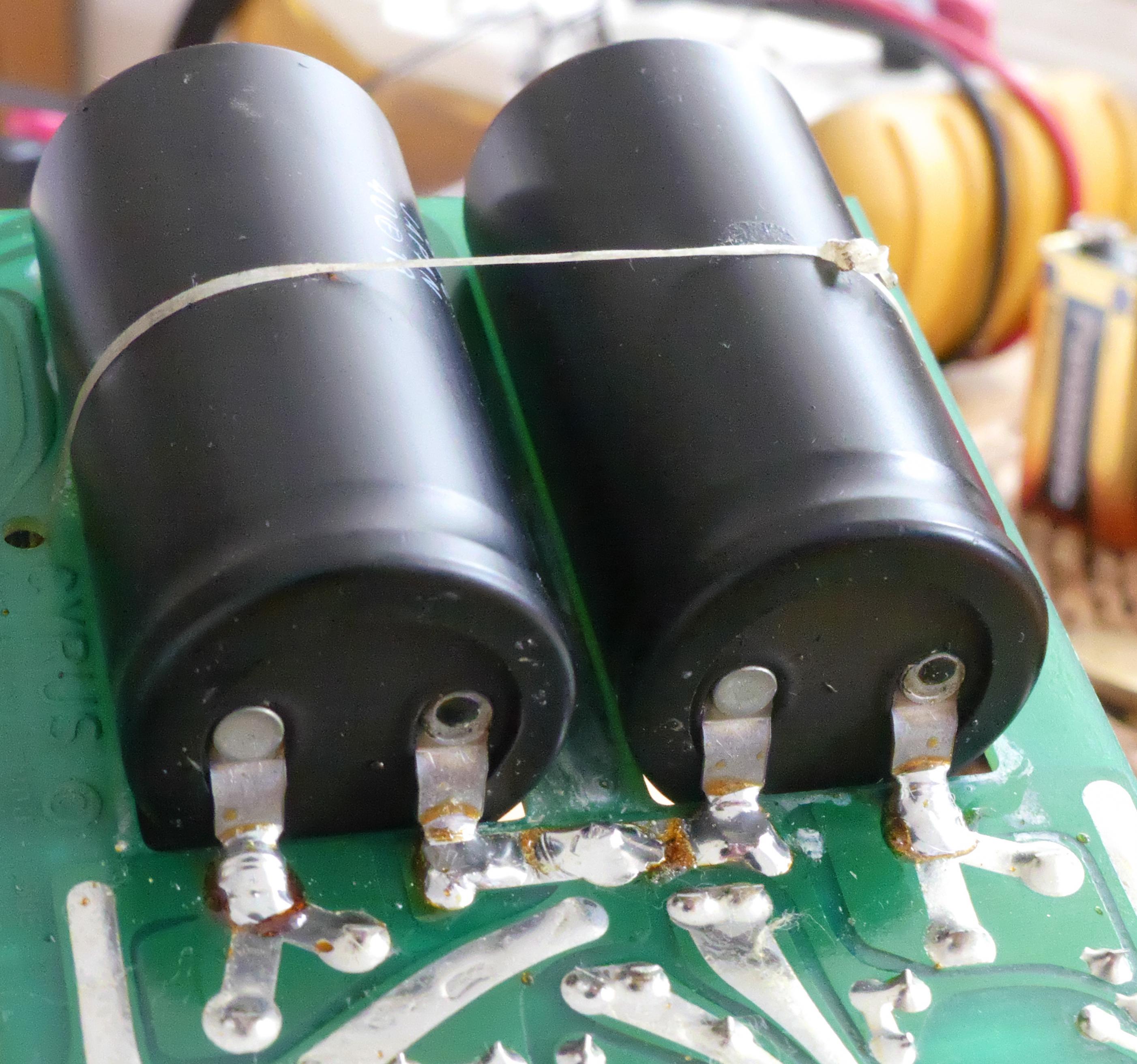

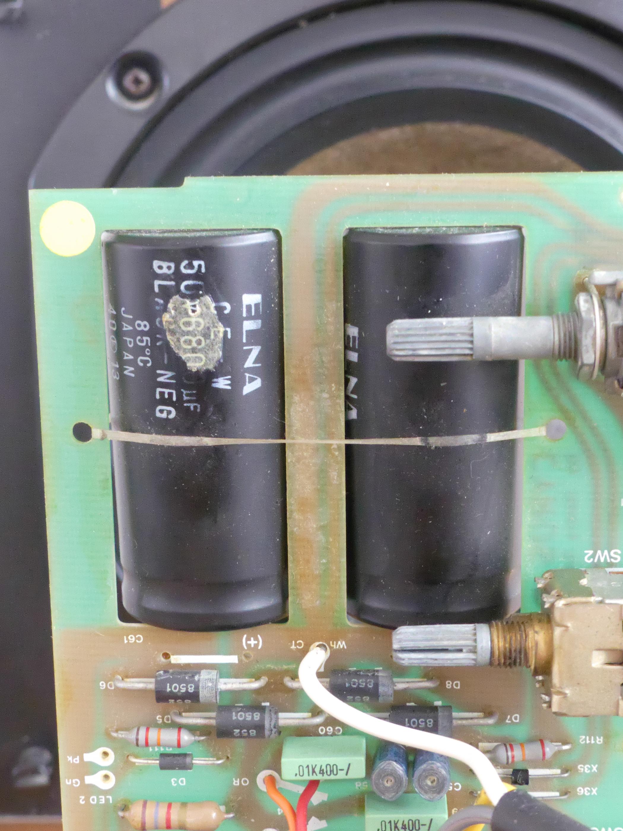

sorry AndrewT I think we may be at cross purposes - what is there originally are two ELNA 50V 6800uF black caps that I read somewhere wer of the slit foil type, I cant find a liek for like replacement online. Bur I found these: ST2-010: 10000uF 80V Supertech 2T Slit Foil Capacitor | Hifi Collective and was wondering if they might be ok. I have since read that it may not be a good thing to go messing around with these cap values .. open to opinions - but now thinking i should just go for a good quality (whatever that means) 50V 6800uF -again open to opinions.

For ref my 6800 caps are 30mm Diameter and 60mm long - pix attached.
Looked up the KEMET info that Mark mentions HERE.
Looks like they are only available in 10000uF capacity - the 50V is ALC10S1102DF dims: 35mm x 50mm so 5mm extra diameter and 10000uF not 6800. Can I find the 50V available online anywhere ? nope!! Next closest is the 63V 10000uF - ALC10S1103DH which at 35mm by 60mm will fit.
