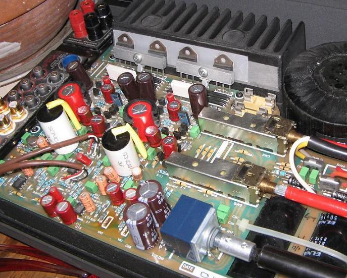

Hi Nerd,
I've completely recapped a cyrus 2 and PSX. Be wary of the limited case size when choosing input caps. You can probably see from my picture that the leads touch the top of the case ....

Hi Phil,
There are some great experts on the Cyrus stuff around here ... I'm not one of them ...... but I have three of them and have always wanted one since they first came out and I was too young and broke to buy one! (Not the experts. I mean the amps.)
There are loads of threads about the early Cyrus amps. Definitely read through as many as you can. Stuff about the Cyrus one and two usually gets lumped in together with the occasional thead about the PSX supply for the Two.
Anyway, I recapped my Cyrus two a while ago now and changed the volume pot. I use my Cyrus two with the seperate PSX power supply and that's why you'll see the original power caps in my photo. They're not in use anyway so I didn't change them.
In my opinion, probably most of the caps are very important. The input caps have a signal passing directly through them so I wanted quality there .... I used Sonicaps BUT really they are way toooooo big for the job. Check dimensions before purchase!. The original electrolytics are very small and fit in a tight space. I do sometimes wonder why they chose electrolytics in this location ...... perhaps it wasn't just a cost issue?
Feedback caps, these are also in the signal path so I went for Black gates here. I don't have any conclusive proof that they are better than any other brand ..... I just didn't want that nagging feeling that my amp could have sounded better!
Power caps: Now, The originals are usually, but not always, split foil types which are very expensive but lots of people think that they are special. The capacitance counts here too. It's entirely reasonable to increase the capacitance a little here. The 'One' can sound a little anaemic compared to the 'Two'. The 'Two' is more powerful anyway but has a bigger transformer and more capacitance. I use my 'two' with a PSX. I recapped my PSX from 60,000uF split foil to 80,000uF Mundorf caps.
I mention this because my Two has awesome bass but sounds a little slow in the mid and treble. I didn't notice until I tried the unmodified Cyrus 'One'. My Cyrus 'One' has noticably less bass control .... and well .... less bass in general but it follows EVERY nook and cranny in the music at the speed of light!
My point being that more capacitance might give you a bit more bass but I'm not exactly sure if this extra capacitance would slow down the upper frequencies. Also, maybe not using 'slit-foil' caps is the cause. I'm not trying to confuse you, honestly, I just don't understand why the 'One' sounds better than my 'upgraded' 'Two'.
You can see in the pic that I used some Elna Silmics by the output transistors. They don't fit either! The legs are longer than ideal and are twisted over to avoid other components.
Chris (Anatech) has mentioned elsewhere that he has seen a few cases where the caps in the phono section have dried out and caused the phono section to oscillate. So, even if you don't use a record deck, still change the caps there or disconnect the section entirely by removing the voltage regulators or wire links or etc etc.
I removed the ribbon cable and replaced with silver and teflon wire underneath. The original ribbon wire has push-fit connections at one end which can't be a great idea after all of these years.
In my opinion the solder traces are very delicate so go carefully with your iron!
The pic shows an Alps 'Blue Velvet' pot that I fitted with some pin bending and improvisation.
These days I have bypassed all of the switches and use an external stepped attenuator.
I'm currently passively Bi-amping:
A Cyrus one for the tweeter and Cyrus Two/PSX for the mid and bass duty.
I hope that helps in some way!
