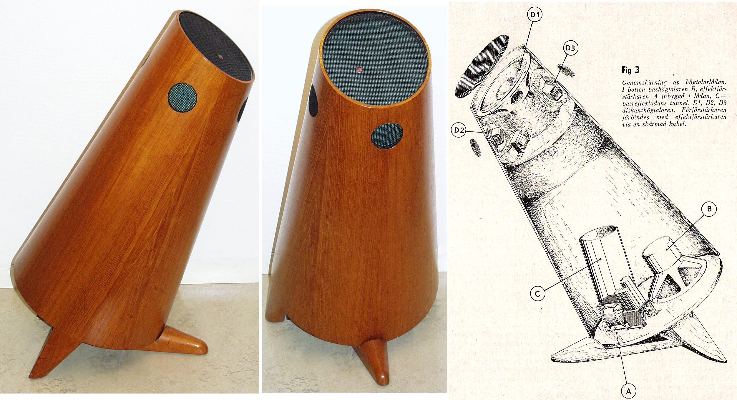

Thanks to DonVK for pointing out how Olson make his measurement. I always wondered about that. I think Linkwitz has worked a minor miracle with his Lx Mini design, the imaging on his speaker ranks up there with the best I've ever heard regardless of price, design, room, or whatever. I consider it a benchmark design.
No problem. Olson's experiments are good illustrations, but often don't reflect what designers implement in speaker designs.
BTW I like to build with cylinders, so I have my biases as well. 😀

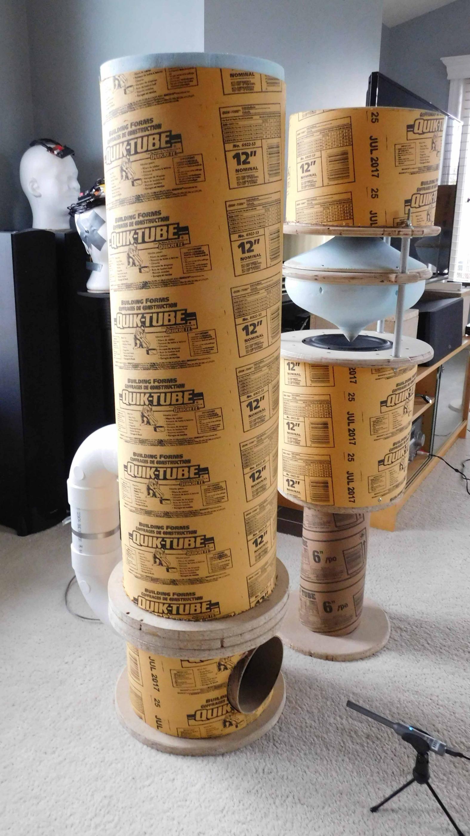

Hi all, noob Vortex here.
I'm going to build the cylinders, no matter what. Just out of pure curiosity. It will definitely cost some money to create those MDF rings and glue them together step-by-step but at the end something very interesting will come out for sure. Inner surface won't be flat, I'll introduce some interesting design when making the rings.
For my 18" Daytons according to WinISD I'm good with a vented design: 46cm diameter (18", exactly the same like the driver, not bigger) and 1m length will give me some nice curves with a tuning freq of about 20-22Hz. But I'll re-check with some other calculators as well, buy adjustable port, etc.
I have space to place the cylinders facing forward since I'll cross the woofer at around 150-200Hz Hz anyway where the direction of the woofer begins to count ... If the project turns out to be good - which I hope for - I'll add a white piano finish, add mid+high cylinders.. a local company here is able to make such beautiful acrylic stands .. it will be an interesting project.

Some construction suggestions.
You can build a cylinder "like" structure using 8-16 sides for the 18" driver enclosure. It will look a little barrel like but it will use less material and be faster to construct. You can probably find ABS or PVC pipe sizes suitable for the other drivers. With a little planning you can often "nest" the cutouts for mounting rings to reuse the center cutout material for the next smaller ring.
Anytime you put a lot of distance behind the driver be prepared for resonances. Often some fill material can reduce these. These will happen regardless of the path cross section (circle, square, triangle, etc) and you see them in the TL designs and other structures with a long paths.
Before you buy material, and break out the tools and glue. Take some time to learn a tool like HornResp (its free!) to model your enclosures. Time very well spent.
