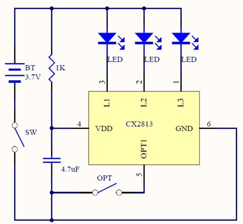

CX2812 LED driver

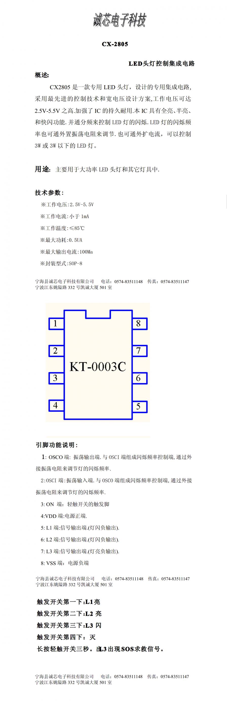

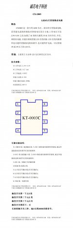

Consider replacing it with an ATtiny13 if you want a light with more useful modes. Still, being able to disable the flashing mode would be an improvement, and it looked like one of the jumpers could do that.
AVR Drivers - Flashlight Wiki
How To Build a Flashlight With Perfect Modes (picture heavy) | BudgetLightForum.com
You probably found this discussion?
http://budgetlightforum.com/node/15463
RedSpawn said the actual modes were:
0,0: high – low – flash – off
+,0: high – low – off
0,+: high – off – off
++: high – off
