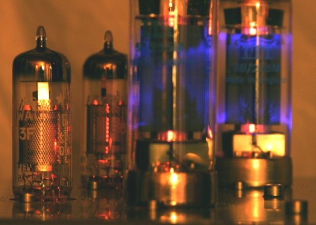

They do glow a rather nice blue on the envelope.
So the whole 5B-25X series are really nice valves🙂

I got the 5B254M in the end, but have been too busy with other projects to have done any more than running one valve up with about 250v anode voltage to watch the blue glow 🙂

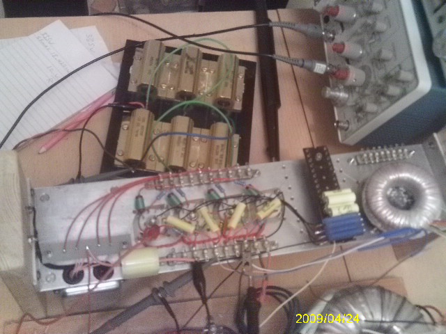

Hey rotaspec,
How you getting on with you 5B's?
I just completed the output stage prototype for my all Loktal amps🙂 getting nearly 100W RMS with four 5B255M.
They are good😀 way better than 807's and the data is a lie they easily do 30W anode dis.
Also no worries on the screen, been running them at 498V UL, they love it.
Here are some bad pics:
