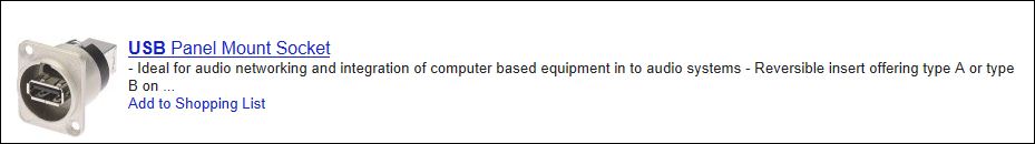

Hi.
It is much eaeier to cut a round Hole. you could then fit one of these.
all major electronic suppliers . here in the uk farnell and cpc stock them amongst others . They are made by neutrik and cost approx 4 uk pounds each . i would think digikey or mouser would stock them . Try googling neutrik usb im sure you will find them no problems. Also there is another benefit of using these you connect them to your pcb by jumper wires most other usb sockets i have seen solder direct to the pcb wich also acts as the mounting for them too in the rough world of guitar pedeals it wouldnt be long befor the normal usb sockets suffered from bad connections . I hope this helps .. Ps they also do a matching cover that fits over your usb lead so it locks into place as would an xLR connector . they even do an RJ 45 version for ethernet . I know what you mean ther is somthing nice about a round hole lol..
Regards Ian
Oh! That thing is awesome! Didn't know it even existed. Perhaps I'll just stick to round holes then haha. What is the name/model # of that part, and where can I get it? I'm not seeing many panel mount USB ports available from U.S. companies.
