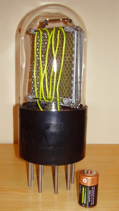

Do you plan on making the filament glow? Then you somehow need to restore the vacuum and reseal the tube. The filament needs a vacuum to prevent it from burning out.
barium/strontium/calcium oxides cathode; barium flash getter; thats the biggest health risk imo. mercury filled tubes are other story.
rest is nickel,copper,carbon,molybden,tungsten,mica,glass.
about beo-its the pink ceramic,like in magnetrons.
The white of knackered getters is reactive metal oxide. Add water and the result is alkaline.
Ah a modern city then, but alkali rain instead of acid rain!
P.S. will the hot wire (string) method work on vacuum tube glass? It is more resistant to temp. stresses than a bottle..
So if water mixes with the dust it gets dangerously alkaline, is there any way I can clean out the dust when I do break/crack a tube?
I use a lot of them in my art, and I have certainly broke several. I would always hold my breath, wrap them up in a bag and throw them away, because I had always been told they were dangerous.
In reality, I would LOVE to clean them out and use them for art.
It's not the alkalinity. Several of the metals are potentially very toxic. Don't lick it. Wash your hands well after touching, you will probably be OK. I would not put them on public display unless enclosed somehow, though I am sure it has been done.
Barium, strontium, calcium are safe I think. The volume of getter is not enough to worry about, micrograms of alkali aren't a threat. Thoriated dust in the lungs is a potential death sentence though, any alpha-emitter lodged in tissue will be a strong cancer source due to the very intense local damage, and dust lodged in the lungs cannot be treated (yes the lungs self-clean themselves of dust, but its not a perfect mechanism).

You can try this:
put a length of properly fitting silicon rubber tube sleeve over the tube.
Heat up to about 150 deg C and shock break in a cup with cold water.
I have not tried that with vacuum tubes but with ordinary glass tubes
it gives a clean cut.
Maybe you have to "vent" the tube first by cutting the tip off.
A grinder should do.
But if you want to be sure the tube does not shatter cut the tip off under water
in your bathtub (you need 30cm of water in every direction).
I use old household scissors for cutting thin glass plates to size this way.
The water prevents the glass to brake where you do not want it to brake.
