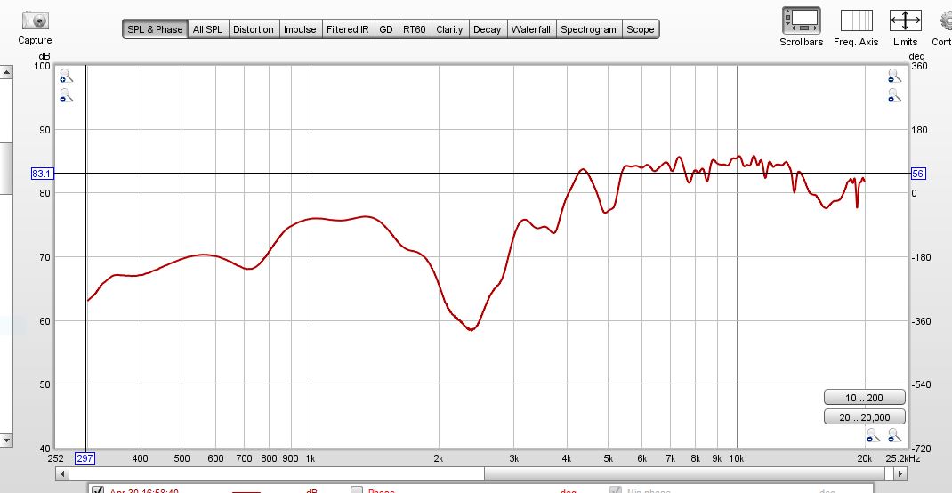

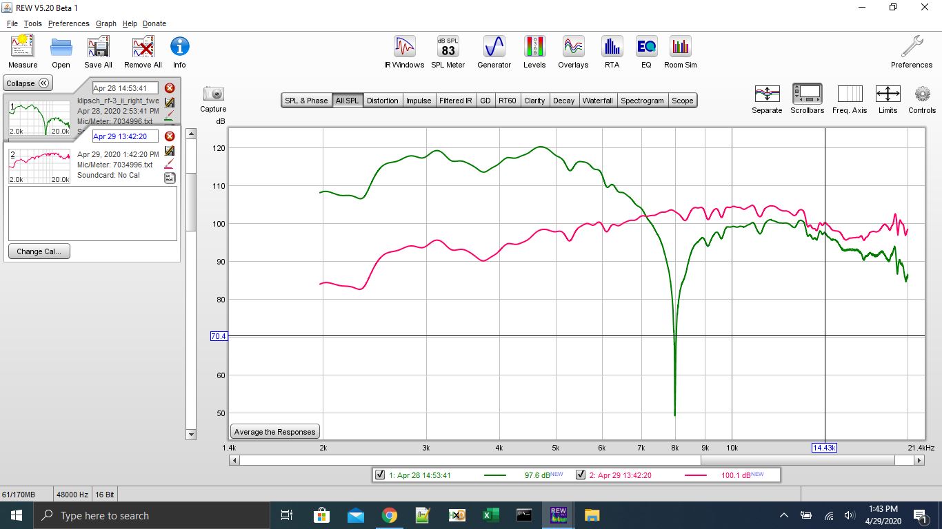

I decided I would try to refurbish them to see how good I could get them to sound and then maybe, try a warmer amplifier to see if I can hear a difference. My first attempt would be to damp the speakers similar to what they guy did in the link above. In addition to being able to possibly hear the difference, I always like to SEE the results of my efforts by measuring it. So I did a near field (about 1.5 inches from the baffle) measurment of both tweeters both before and after damping the horn. Boy was I in for a surprise! Both tweeters were almost identical in their response. Here is the result of one of them:

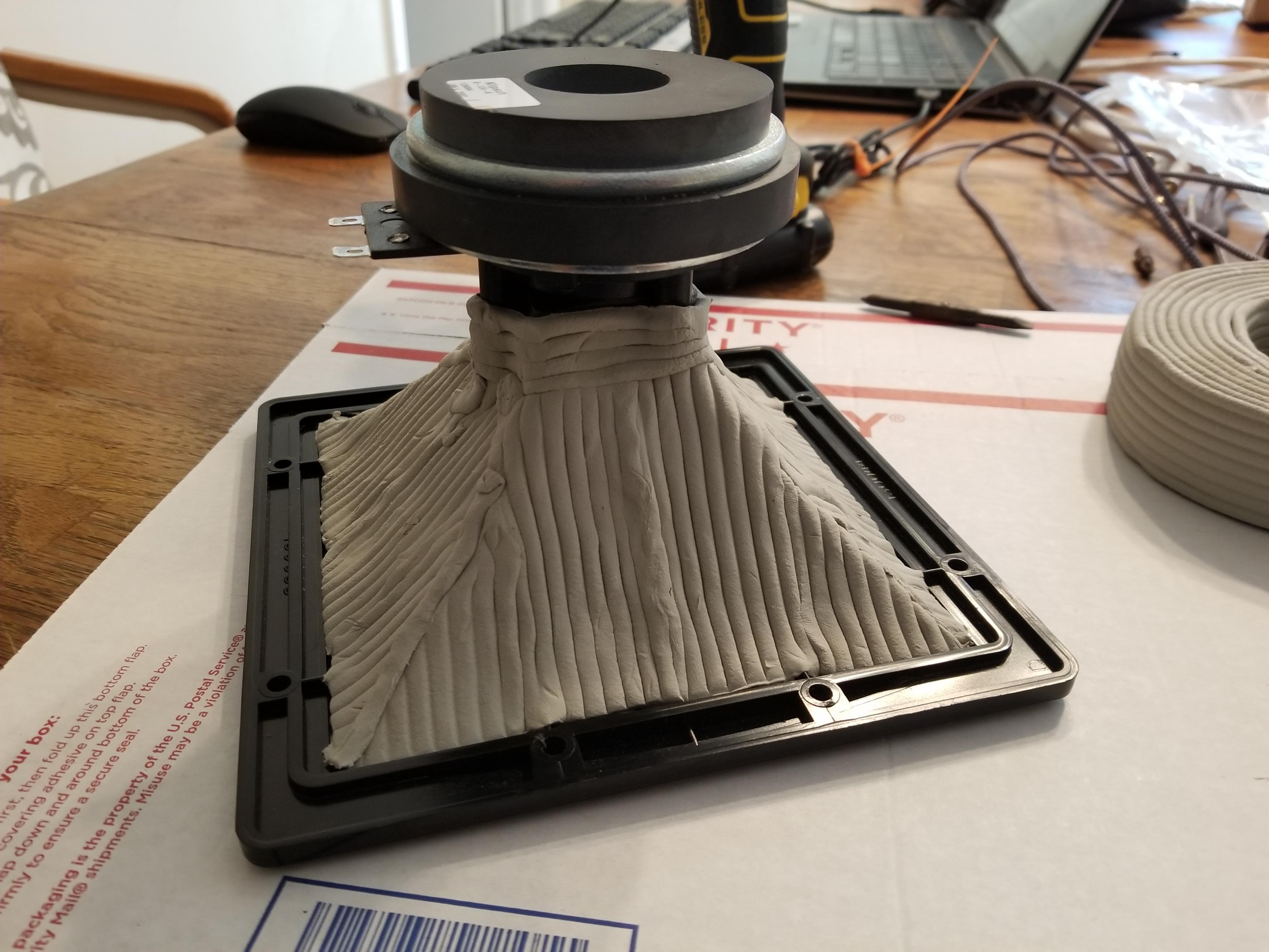

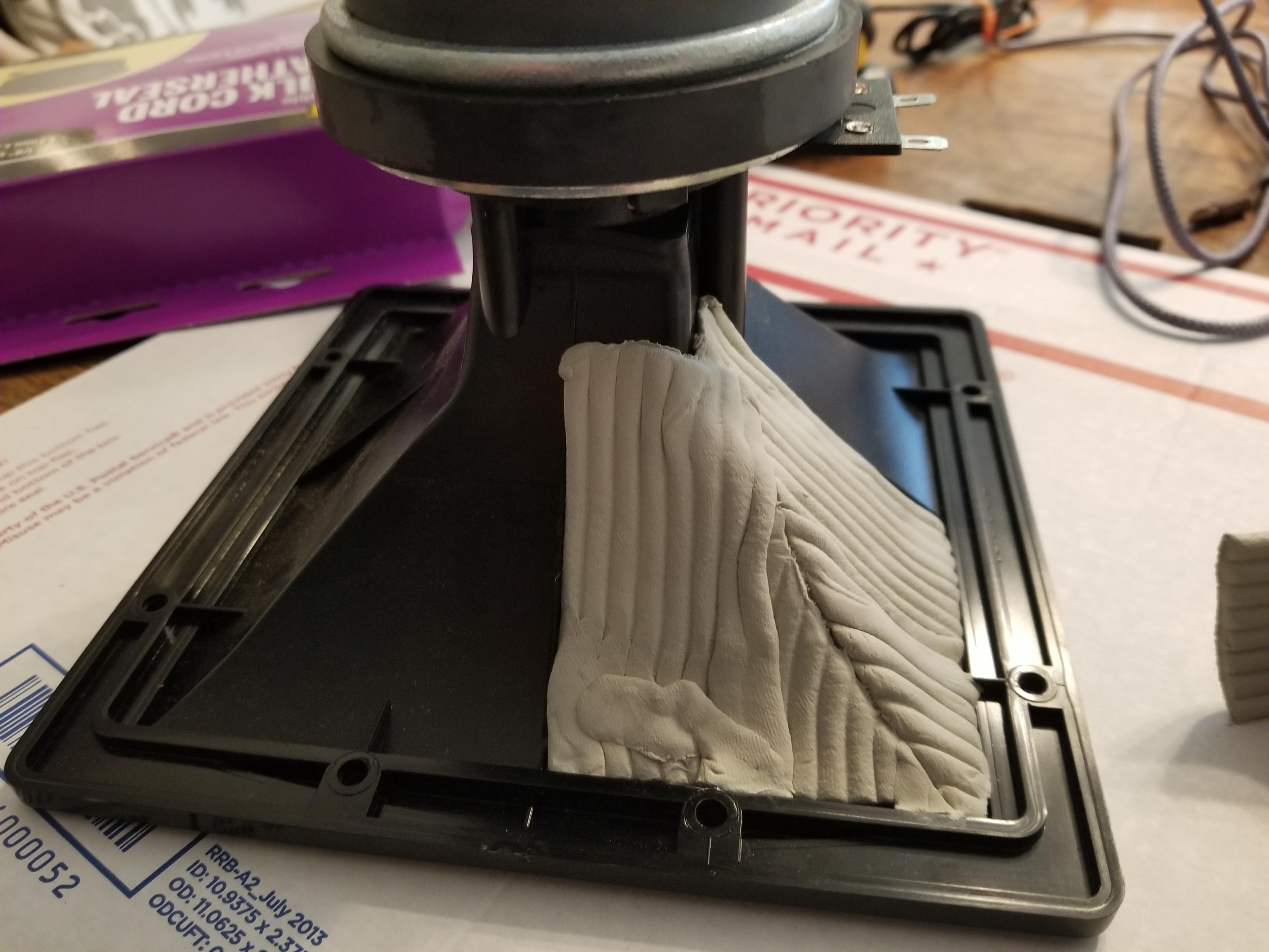

I was NOT expecting the huge suck-out at 8kHz! I did however, decide to proceed with damping the horns, just to see what it did. To that end, I found some rope caulk from Home Depot, and I thought I'd try it to see if it both was sticky enough to hold, while being easy enough to remove if I decided to change course. Here is what it looked like, in progress:

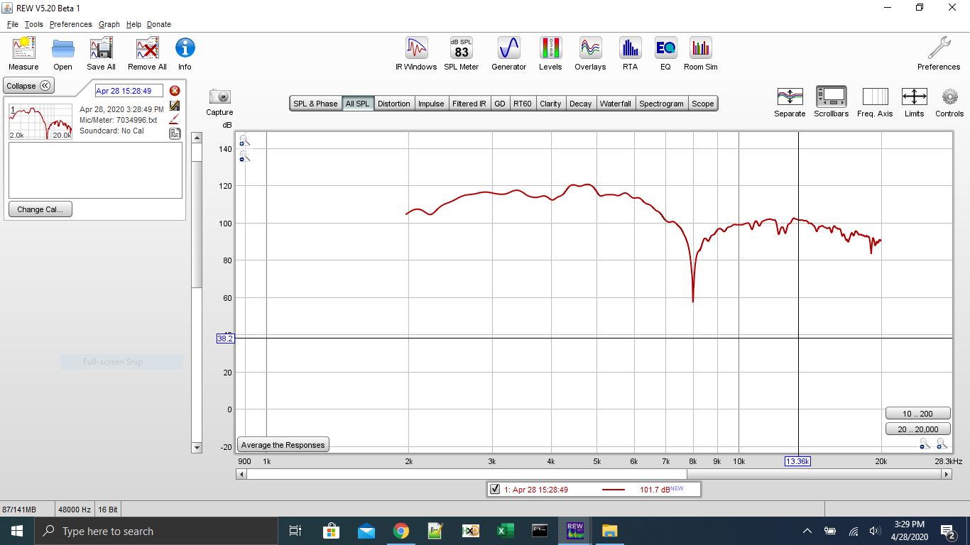

After re-installing the horns, I measured them again and the result was pretty amazing! Here is a screen shot of both a before and after response measurement of one of the tweeters:
Please note these are gated measurements using REW without any additional smoothing (as I don't have an anechoic chamber).
So this is encouraging.. The suck-out at 8kHz is gone! However, I see that while the lower range of the response was almost 20db higher than the higher end before damping, it is now almost 10db LOWER at the 3kHz area than it is from about 8-12kHz. This leads me to believe that the material I used is too heavy, providing too much damping? I would appreciate any thoughts or suggestions about this..

  1. Pre-damping gated measurement of tweeter 1975kHz to 20kHz
  2. Damping of tweeter horn in progress
  3. Damping of tweeter horn completed
  4. Gated measurement of tweeter after damping
I also measured the loudspeaker from 300Hz to 20kHz and added that plot.. Yikes!
