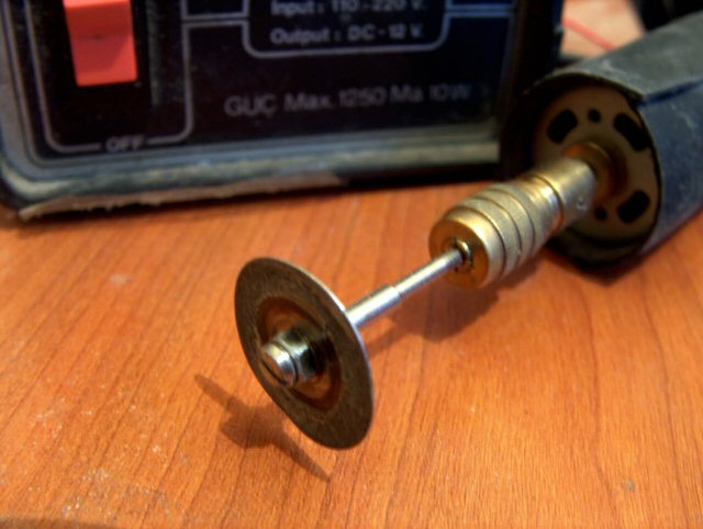

Fresnel lenses are easily cut with a table saw, rotozip or Dremel with Cutting wheel. Just mask the active part of the lens you will be using to prevent scratches. Common household plastic wrap works great.
