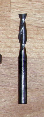

That's the bit I'm using for cutting circles. I have a router mounted on a table. I drill the hole in a center of a circle in MDF with a small drill and measure the radius of a cutout. Now I measure the same distance on a table from edge of a router bit and drill the hole in a table and put the drill bit there. I mount the MDF on a table ( the drill bit goes through the hole I made previously). I can rotate the MDF piece on a table, while the router bit cuts the perfect circle from a bottom.
