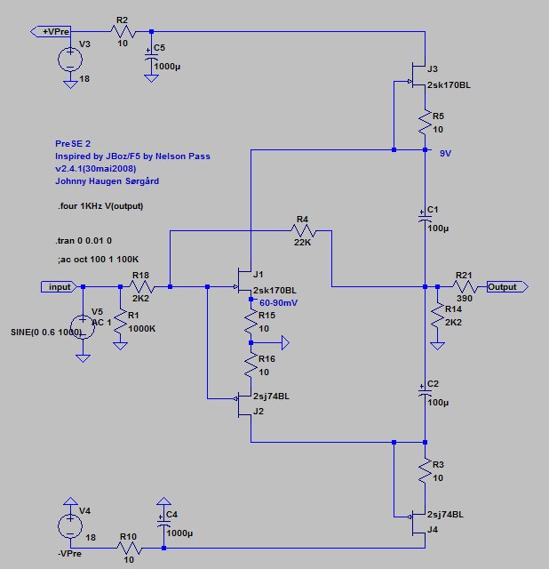

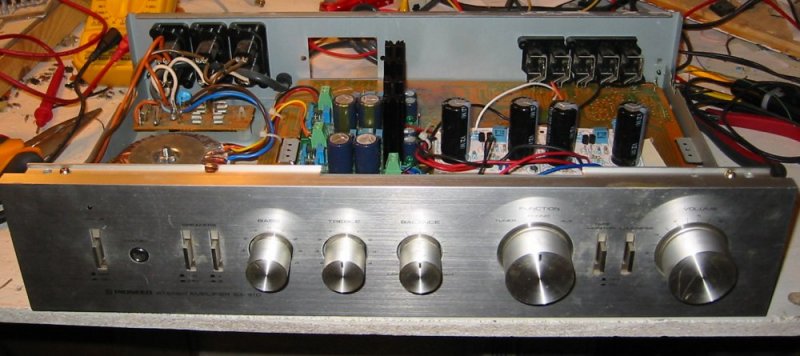

Cute little preamp inspired by JBoz/F5
I attempted to measure the noise of this circuit's output. I turned the input pot down to zero. If I did this correctly, the circuit's dBV appears to be very quiet!
