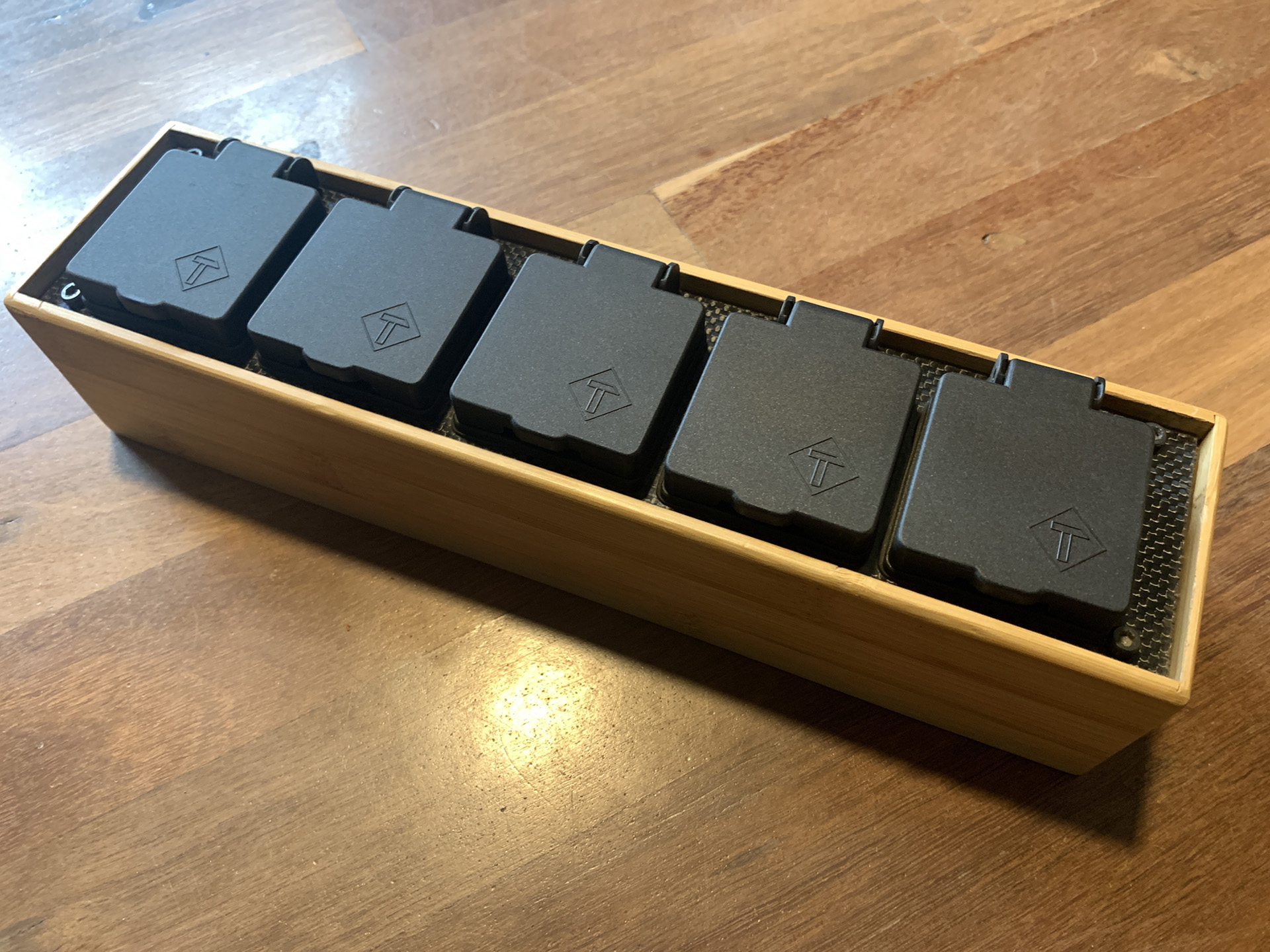

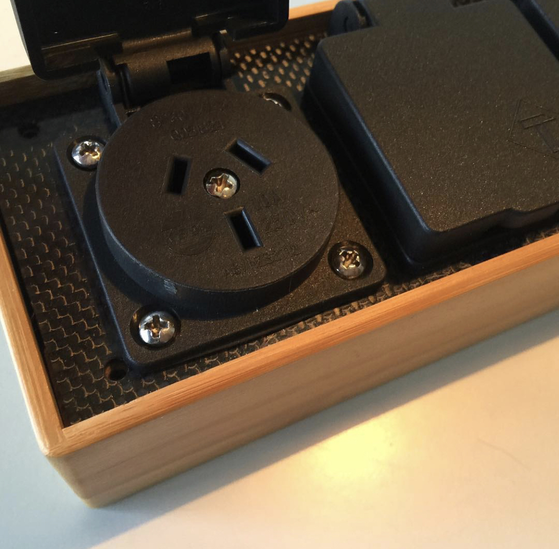

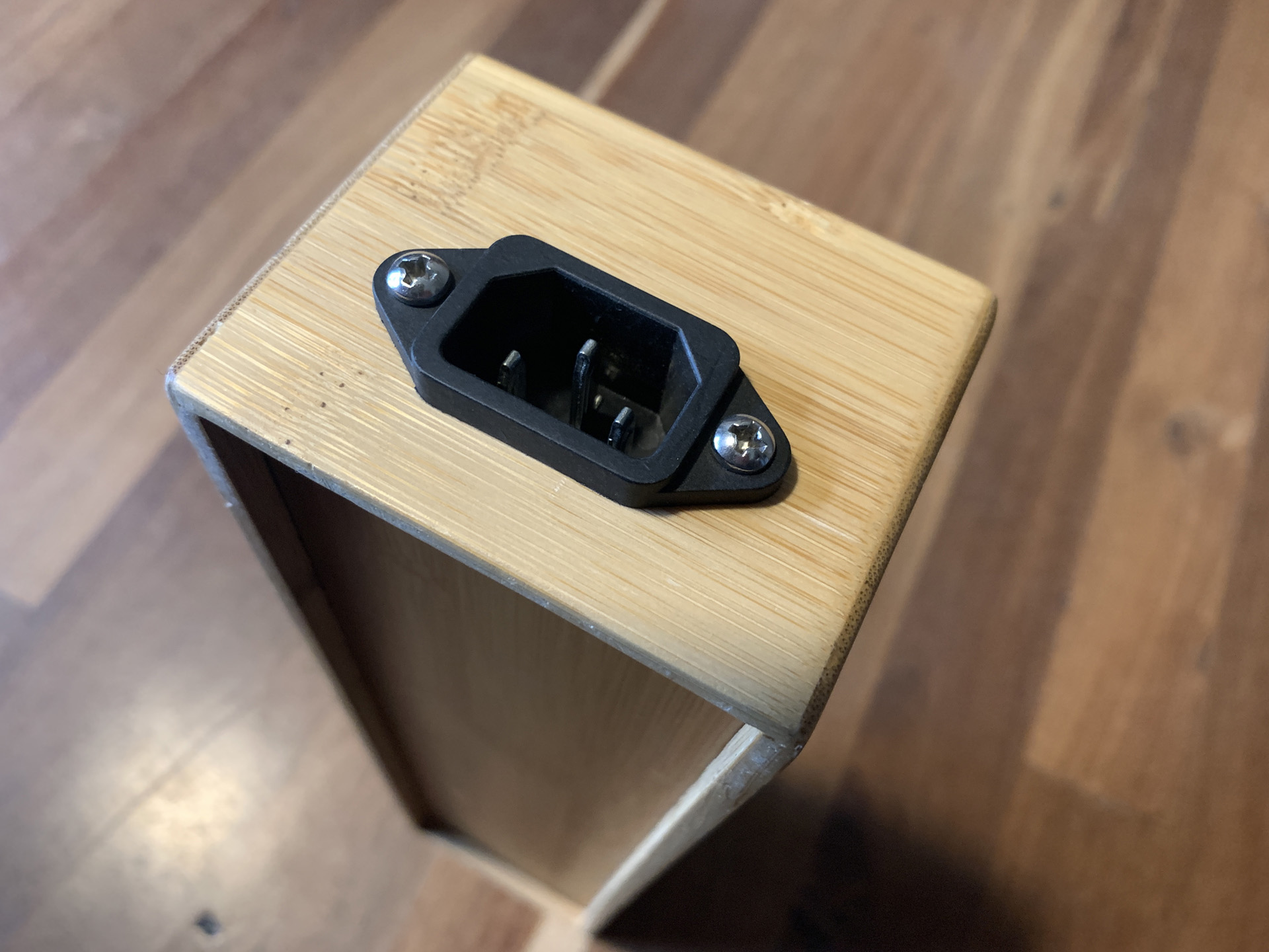

I've been fabricating my own power distribution boards for a while now. I found inexpensive bamboo cutlery drawer organisers that I used for the enclosures. I had some sheets of carbon fibre left over from my drone building antics and sourced some sockets designed for camper trailers that utilise a cover. I like the idea of preventing unused receptacles from filling with dust. Like you, I did not want any additional filtering, just good quality mains copper cable.

Can you back this up? I doubt very much the Aus electrical code covers devices not permanently connected to the mains.
Under Australian electrical standards all electrical work, devices including powerboards and extension cables are subject to regulation. The electrician bible is the australian standard AS3000 and anything its referenced to.
What Lowpoke built is not permitted under any circumstances.
