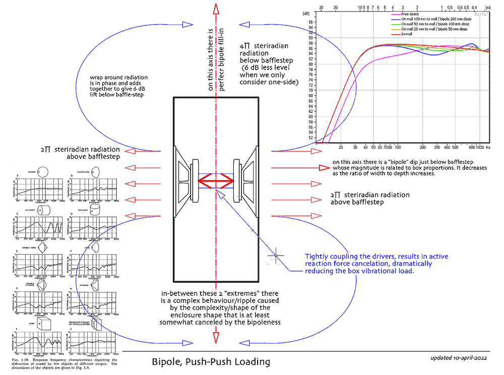

2 woofers per cabinet, use them push-push to gain gthe (huge) benefits of active reaction forcwe cancelation.
The rest of your plan makes sense. Use quality plywood. For the task 15mm will be adequate.

- Push-Push, opposed?
- [reading]... Is that arrangement only good for sealed?

Doesn’t need to be sealed.
That XO looks to be a decent substitue for plate amp XOs. It lacks a HP but if you are happy not cutting the top you are fine. And well under your $250 budget.

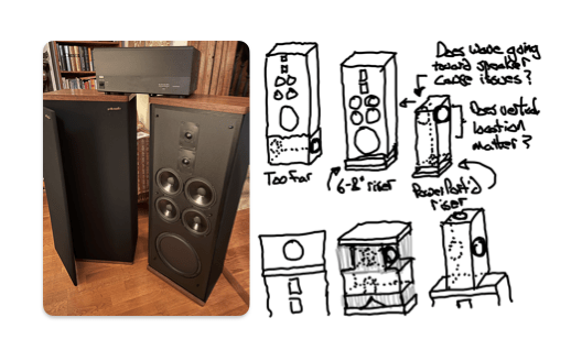

So, thoughts after doodling:
- I'm guessing a tall, narrow tower, with the speakers opposed at the top, and the port on the bottom, is a good place to start?
Having a sub with speakers pointed at the mains... is that problematic?
- I imagined a musical sub would be pointed at the listening area, but no? These frequencies are a mostly omnidirectional fill, so it doesn't matter?
- I'm o.k. with bizarre designs to fit the need.
The speakers I have (the ones in the picture are pre-mods) are relatively shallow. I considered building something like a riser, or something like a mohawk that sits on top (using that tall narrow design).
Not sure about placement and best design.
Thoughts?

Bass is omnidirectional below about 500 Hz. Side mounted woofers used well below that frequency are pretty much perfect AFAIC.
That will be a (very likely mistuned) ML-TL.

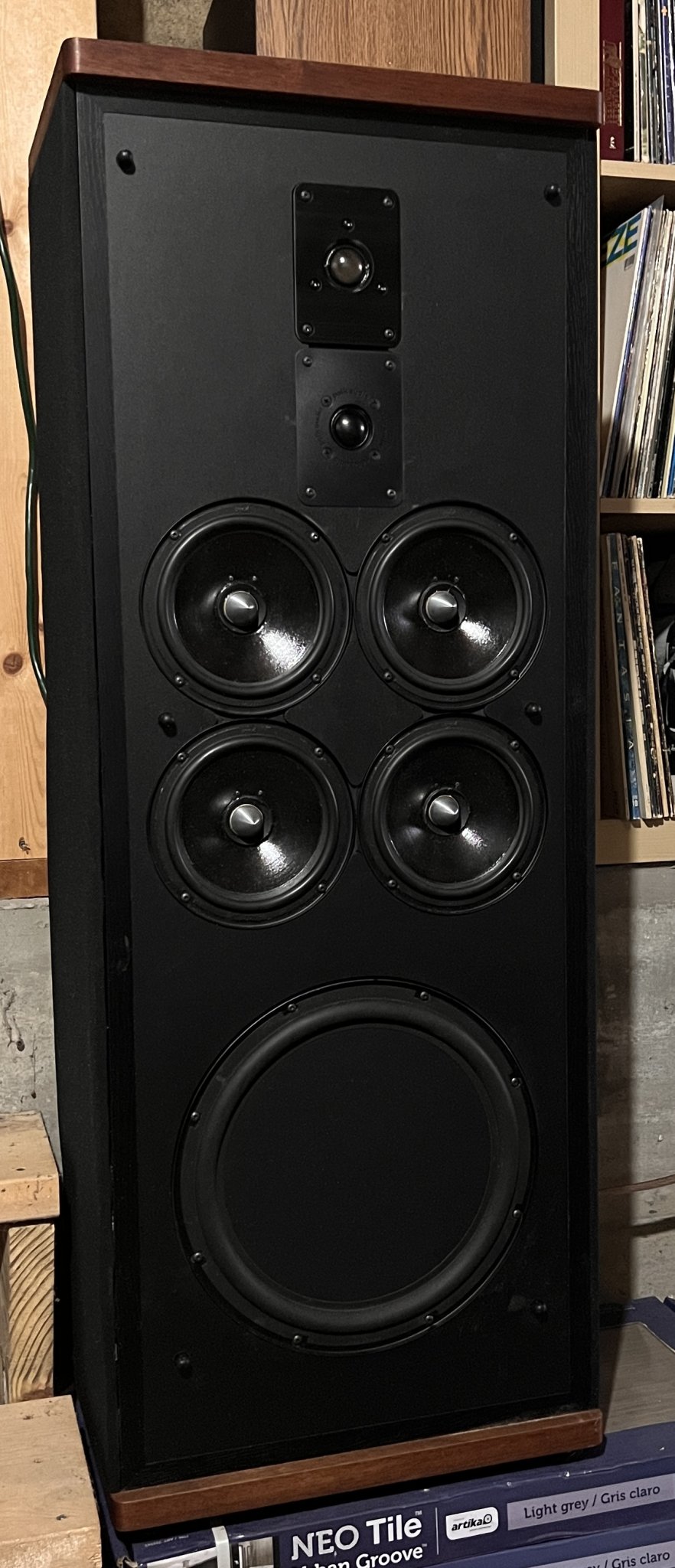

The things with 4 midbass and 2 tweeters per side are your mains?
dave
dave

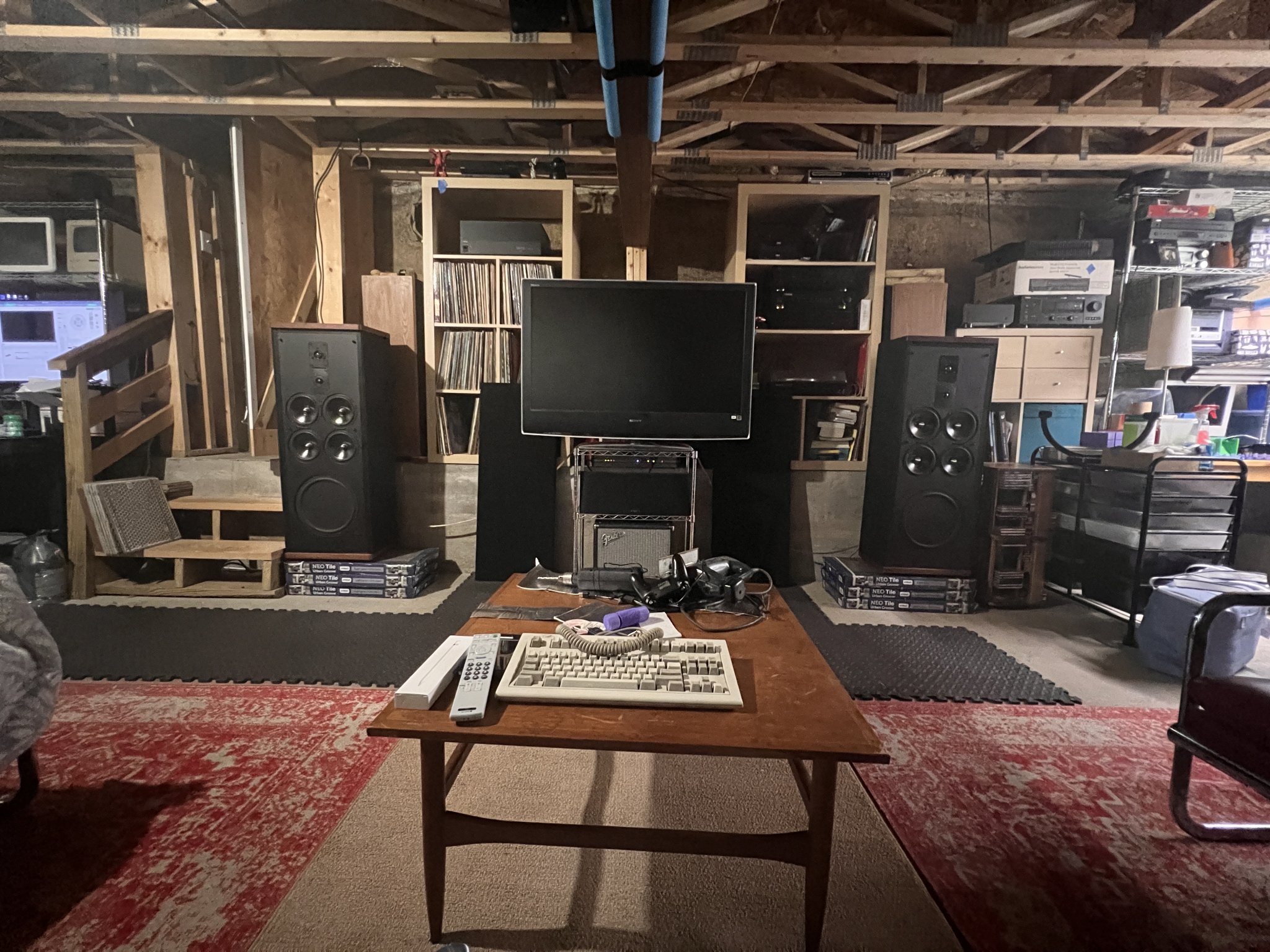

Yep, those are the mains. As they are now, they look a little different (and I've got 2 more replacement tweeters (to match the tops) to mount this weekend)...
My in-progress, unfinished listening area is ugly, and almost set up (still need to put everything in the right place):
I wanted to put the low-end reinforcement in the front, between the speakers and the tv, or under them.
The sevens back-to-back would mean a box about 12 inches wide, from side to side, if they're supposed to be as close as possible in the push-push pointed to the sides.
The original boxes for the sevens were kind of a mess. 2.5 ports (they shared air with the ported mid/tweet at the top of the cab). 2 dedicated ports for the sevens- one front, one back.
