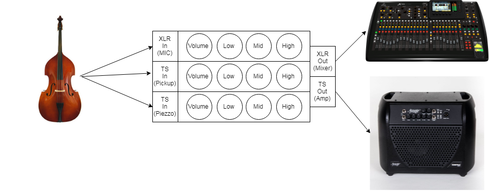

Hi!, I am a musician that is looking for someone to build a custom mixer for my double bass.
I currently use 3 sources to get an amplified sound out of my instrument:
1) Condenser MIC (Shure PGA81)
2) Piezzo Pickups (Fishman BP-100)
3) Magnetic Pickup (Krivo Pickup for Upright Bass)
My project is to build a mixer, with volume and eq for each channel, that can output a balanced line level and a instrument level one. For the conndenser mic must also provide phantom power and the idea is that it should be portable.
Any tips who could build something like this would be much appreciated.
Thanks!
Johann
Although I think your setup is fine I really think your first idea is quite good,
to have a custom mixer.
If you know soldering you can even build it yourself.
Go to this forum, Groupdiy.com, there's a lot of projects there you can use for your mixer.
From the projects in Groupdiy I recommend the following:
Condenser Mic preamp: you can use a Neve 1290 preamp, API 312 or SSL 9K type of preamps, any of those will sound really good
Piezzo Pickup: Bo Hansen DI with the mod for 10Megas (described in the forum)
Magnetic Pickup: Bo Hansen DI with 1Mega impedance (normal/stock circuit)
For EQ:
Neumann W492 project
Calrec EQ
SSL 4K EQ
_______
check that forum out
It will be more expensive than you current (and working) solution,
but you will have really high quality circuits and maybe you have loads of fun building it, if you're into DIY yourself
