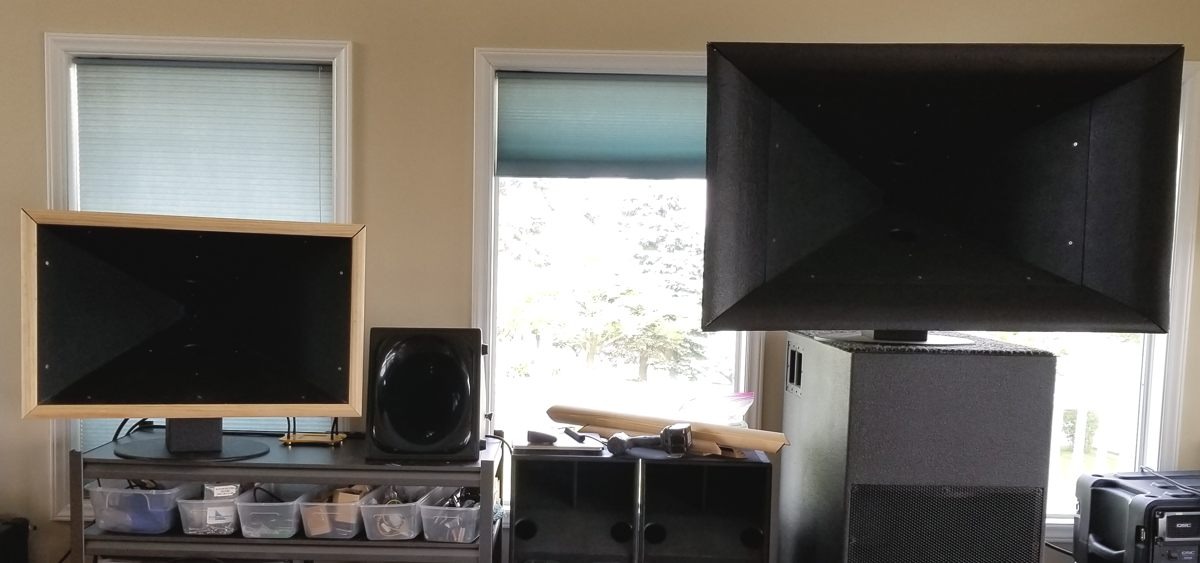

Hi, I've built straight-sided/tractix K402 clones, based off the work of the Australian that Chris mentioned.I am looking for someone that can build a K402 clone or something similar. I have lots of tools but no CNC although I do have a sliding table saw among other large machines. Never built a horn. I am sure that I am capable but would need you guys to do the design and help me figure out the angles and proportions.
It's not something I could get involved with again as far as direct help or production, but can happily help point you in the DIY path i took.
Here's a pict...
Right side has the secondary tractix flares attached to primary straight-sided horn section ; left side just has roundovers attached to primary horn
(I was comparing polars and listening to see the effect of the added tractix flares.)
The SynCalc spreadsheet Chris linked works great....heck of a gift to the DIY community from Mr Waslo.
If your sliding table saw is very large, the horn panels will be fairly easy to make once you get a feel. My Incra 500 miter table isn't big enough to make them easy.
I really like a plunging tracksaw, used with a 4x8ft table. A sheet of OSB on sawhorses, covered with a 1" sacrificial 4x8 foamboard, makes it really easy compared to a table saw.
The tracticx flares are made out of 2" thick rigid foamboard, using a hot-wire carving knife jig. (also learned from the kind Aussie...sorry can't find the link) yet)
FWIW, and maybe as a helpful motivator to get started with a unity/syn type build...
I've spent a lot of time comparing builds with and without secondary flares.....mainly because the secondary's at least quadruple the build difficulty, not to mention adding a lot of size and weight.
Like here are some straight-sided secondaries...that are removable for A/B comparisons.
There is no question secondaries, either straight-sided or tractrix improve polar measurements. And everybody on earth knows mouth terminations matter for the smoothest directivity.
What I've found however, is within say a listening window of +/-30 degrees, the measurements don't improve that much (compared to wider angles),
and more importantly...I can't hear much, if any, difference. Maybe I'm just deaf 🙂
Anyway, point is...if you are encouraged to DIY a unity...I'd suggest to first try one without any secondaries.
If nothing else, the learning will be invaluable in avoiding mistakes with a more complicated build that adds them.

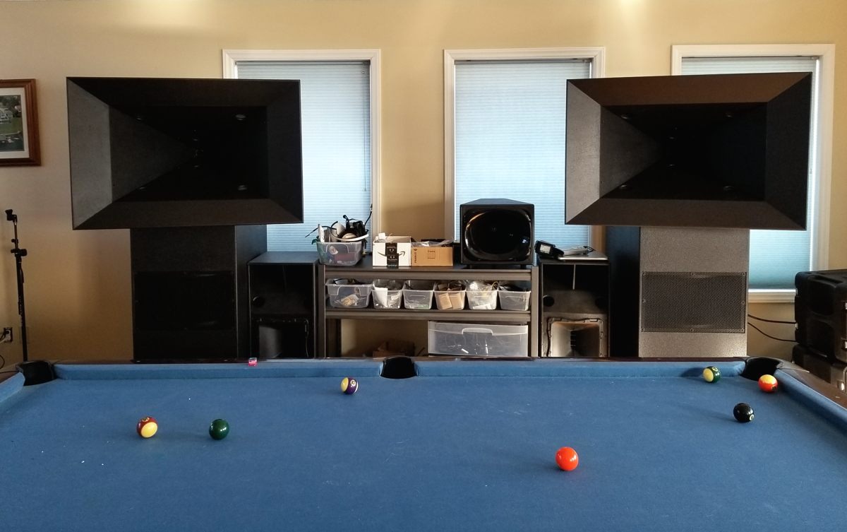

I now have all the builds pictured above out in a storage trailer. Here's what replaced them...
Again, fwiw

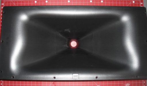

Roy D. at Klipsch (their main horn designer) has never spoken clearly or openly about why they use the throat termination geometry that they do on all their horn designs. I do know that I've been using said K-402 horns for over 16 years now, and have no intention of replacing them with anything else. The horns are either compression molded (i.e., the older/25 lb. K-402s) or injection molded (current production 15 lb. horns), so Klipsch could have used a curved throat, like the 1.4" JBL horn used in the JBL Cinema 3732, 4722N loudspeakers if they wanted to do that:
Roy has commented that the curved throat geometries of the oblate spheroid or quadratic throat varieties don't actually work as advertised, and he said it in a way that was unambiguous that he had tried them both, and found them wanting. Remember that horn polar coverage performance is the most important design factor for Roy due to his audience (professional cinema) and their requirements, That means that his horns are optimized for polar coverage and avoidance of throat slots--which is still used by others, but which in my experience sound like loud trumpet players that need to empty out their spit valves when playing above ~4 kHz (2" diameter throat horns, that is).
The problem is: the JBL design is more complex to build (actually, it's much more complex)--you'd have to clone the horn in structural resin to get the shape right. Also unfortunately, it's too small for my needs, while the K-402 is the right size. Also, the JBL horn is 1.4 inch throat, while the K-402 is 2".
You could chop off the throat entrance on the JBL horn at the point where it mates flush with a 2" driver throat, but then you still have the problem of the smaller horn size not controlling polars down to the lower limit of the compression driver's capabilities (for home hi-fi use--not PA use) like a BMS 4592 ND dual diaphragm ring radiator or Radian 950BePB beryllium dome driver (or the more expensive TAD 2" Be diaphragm compression drivers).

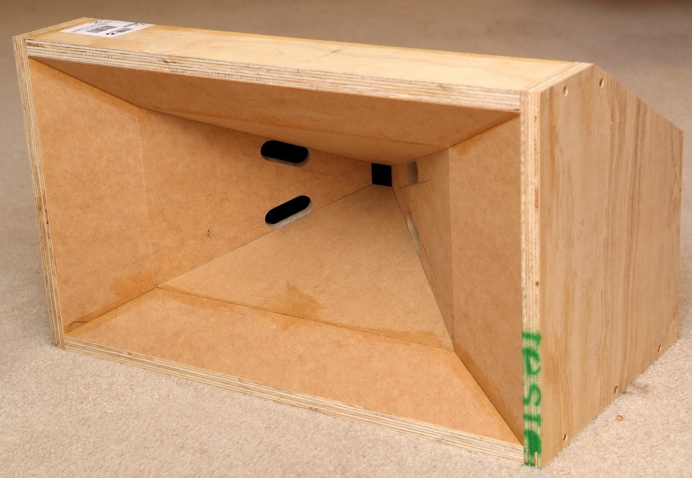

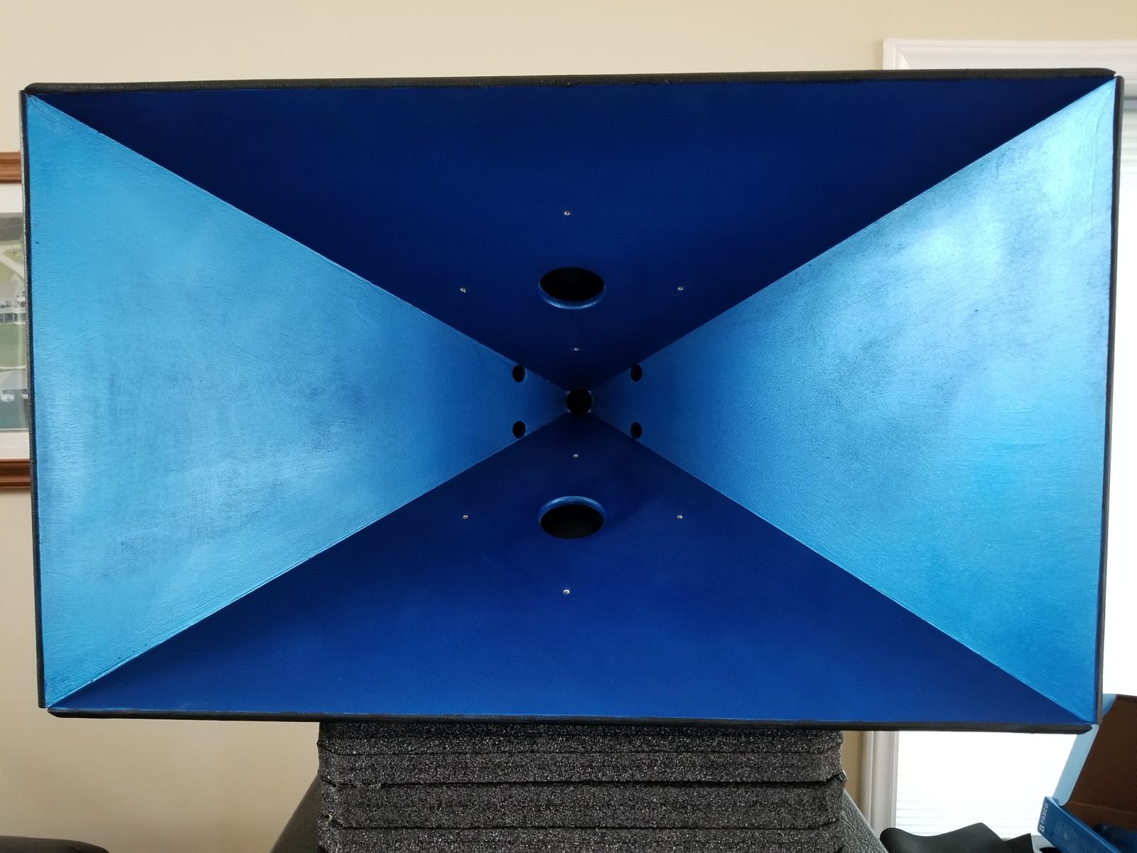

If you see the stereonet link above, there are 2 builds, one using foam cut with a hot wire, and the second one using laminated plywood sheets that I shaped with a table saw and electric planer. But there are many other ways.. you could make a mould and fibreglass the whole thing (like the originals), mould it out of concrete or plaster, or simplify it with a straight expansion as calculated in the synergy spreadsheet.
There are lots of different horn profiles/designs you could make, just copy a good existing design that matches your needs to get started.

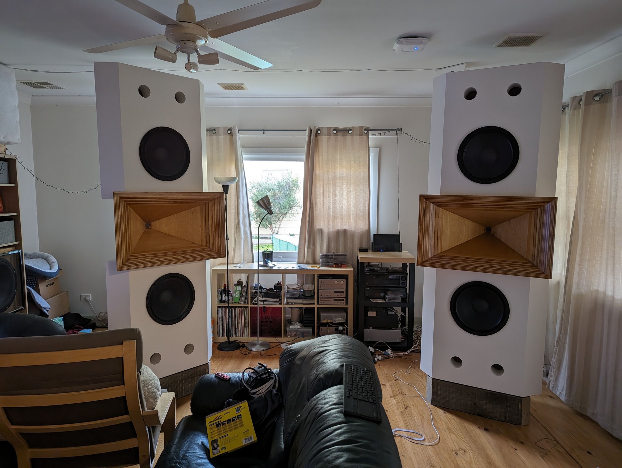

My next project is a pair of syntripp synergy horns, maybe with tractrix expansions... we'll see
