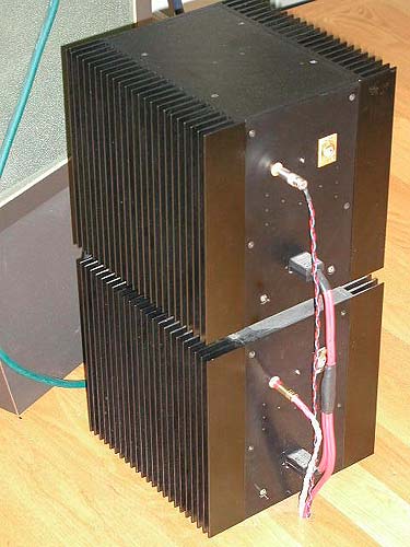

Well fellow machinists, it may indeed be hard for you to make any money here😉 The owner of those nice chassis' says:
I guess it's not TOO bad indeed😉😉
cowanrg said:well, for the materials AND labor, it was $150 each. not TOO bad considering. you gotta see them in person to tell. they are absolutely PERFECT. they were done to perfect tolerences. this is the front fins and the back plate with the hole in it.

Anybody, especially machinists, can see that those heatsinks were not machined, so $1,500 WAS for a chassis with extruded heatsinks.😉
Oh I know those were extruded...though I thought he'd included a price that'd be machined to something similar. My appologies 🙂

The sinks are standard extruded profiles.
It is not possible to make anything that even looks like a case for 300$.....as already stated in this thread.
Just the faceplate of the pass lokkalikes will set you back 300$ in reasonable numbers.

Here's an example of the simplest chassis one can make using R-Theta heatsinks I posted earlier. I used 1/4 aluminum plates for everuthing and 4 screws per panel. There are two 3/4 x 1.5" bars per each sink (used also for TO-3 devices attachment) and four 4" stand offs, that's all to keep everything together. This chassis is good for Aleph 2, but I couldn't offer it for $300.😉

Now, to simplify building my chassis, one can use 6" x 1/4" aluminum bars, so they have to be cut to length only and finished on belt sander (forget milling). Drilling 4 holes per panel is not a problem either. So why would you need machinists to do this kind of work? All you need are basic tools anybody can get for less than $100 ea.😉
