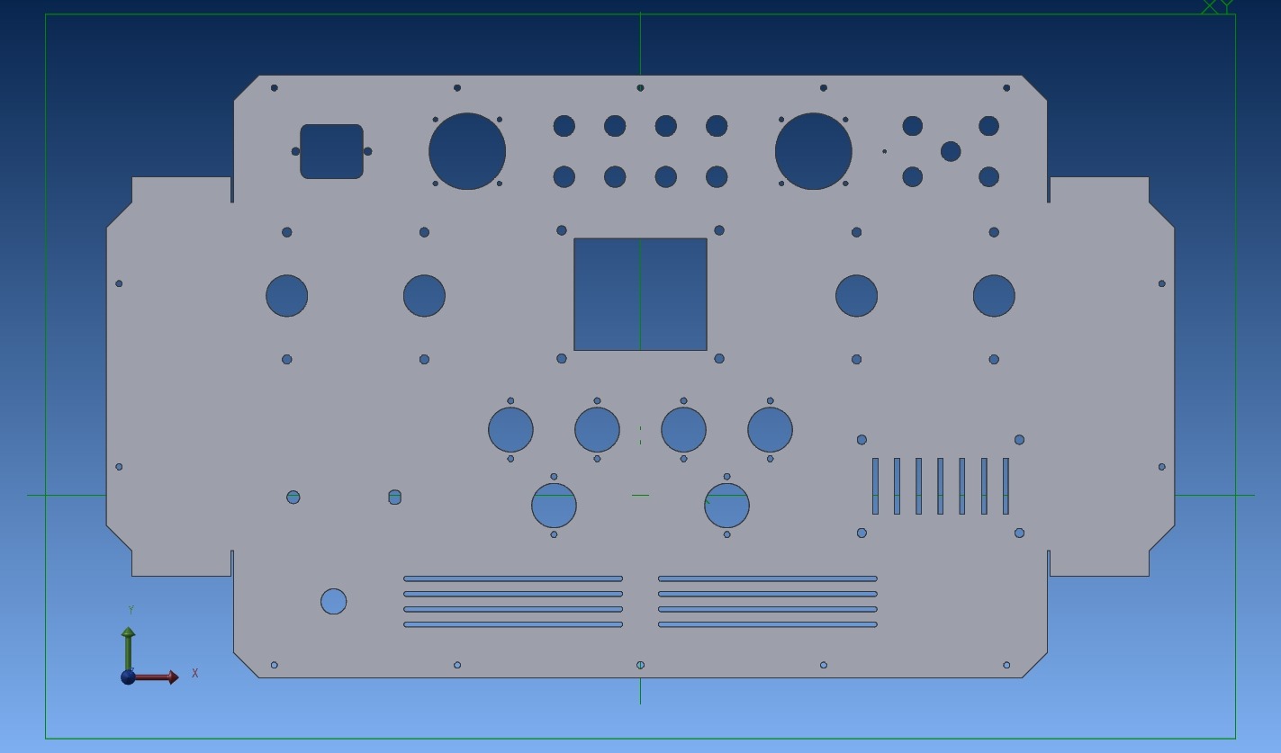

Exported Step file of above design per their drop zone require in 20ga 304 stainless. Quote didn't ask what metal finish- so we'll see if specified

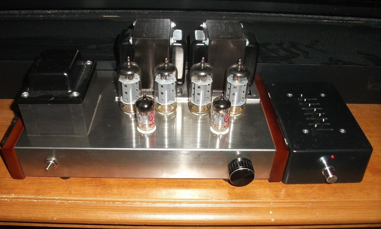

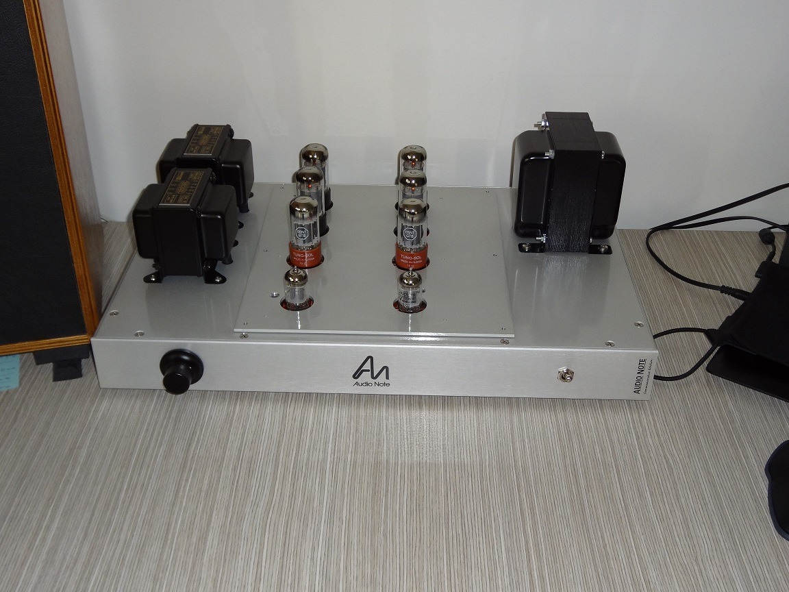

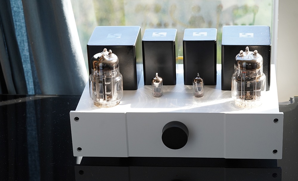

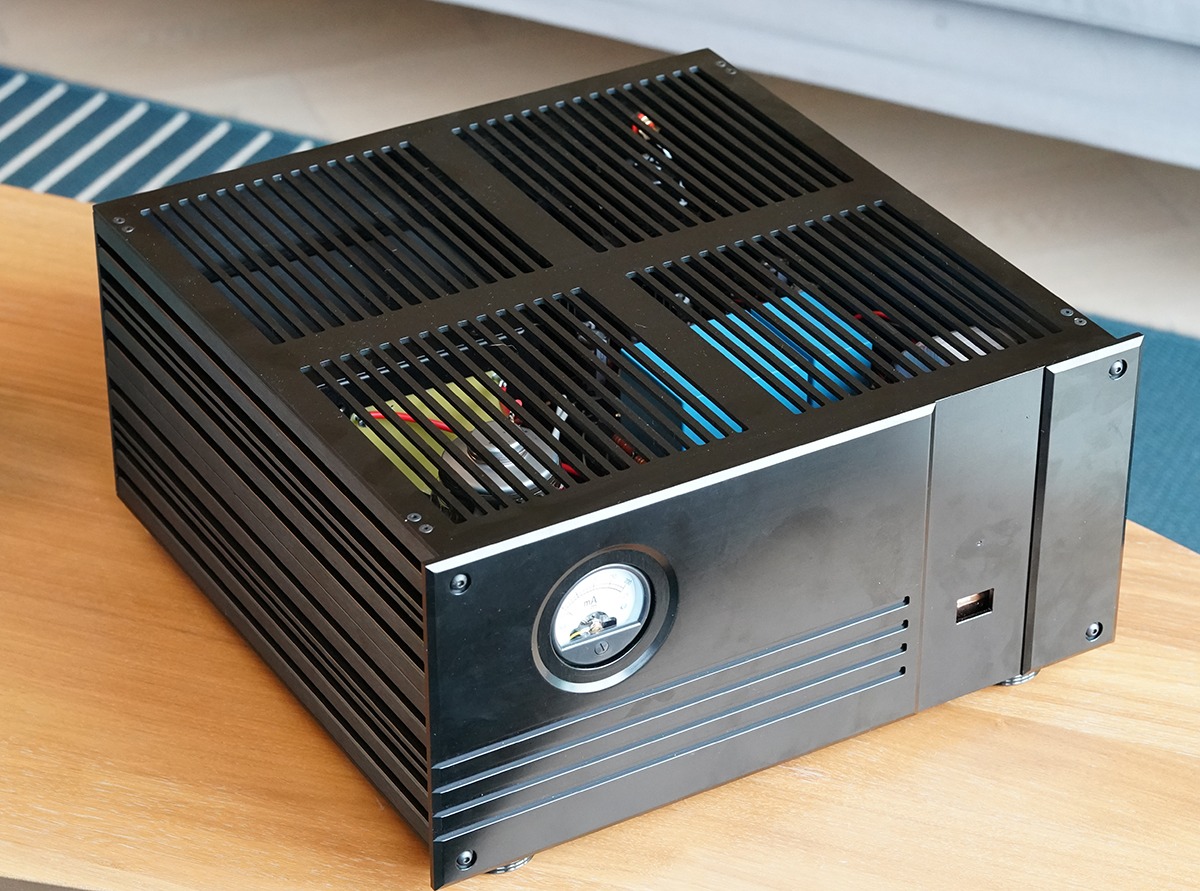

Yes, I have made some chassis with them and a couple are in process. I normally send them stp, dxf and pdf files for each part. And then you will need to separately specify about the material, finish. Also some threads info need to be told explicitly. Much better to have a direct communication by email or some messenger, do not expect to just upload the files and go. Some examples here, side walls are Modushop profiles, everything else from rapiddirect:
https://www.diyaudio.com/community/threads/photo-gallery.71300/post-6680630https://www.diyaudio.com/community/threads/photo-gallery.71300/post-6835348
