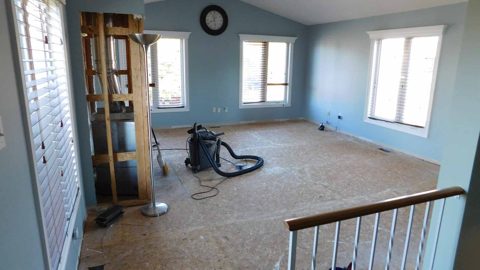

First attempt.

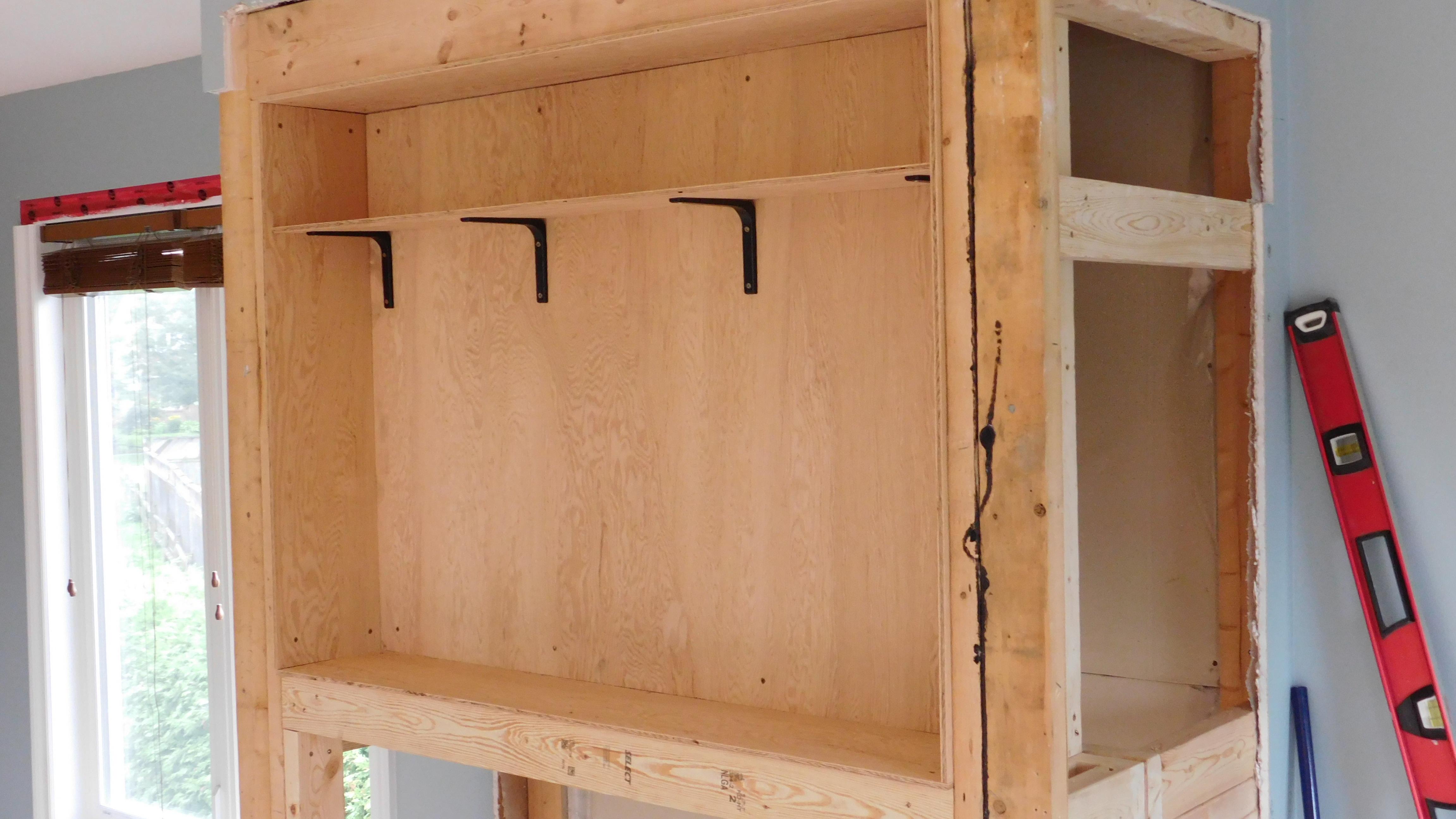

Pic#1 : shows the wood fireplace (now removed) and the room.
Pic#2 : shows the column reframed for the new gas fireplace and TV pocket.
The sitting area is about -30deg and >=2m out from the CC shelf. V1 is a 3 way design using dual DC130b-4 woofers and a CX120-8 coax. If the woofers are close enough and XO'd low enough it should reduce the lobbing. The Midrange and Tweeter are coax so that should minimize lobbing at the MF-HF XO. The woofer design is BR like the rest of the HT system, only the BR ports are now out the front. The baffle is angled down -30deg to the sitting area.

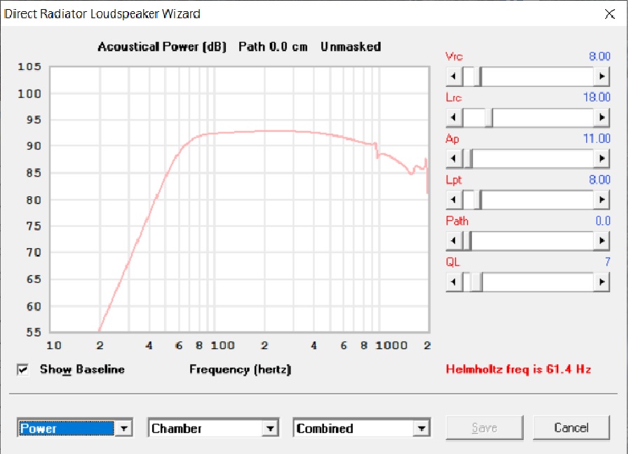

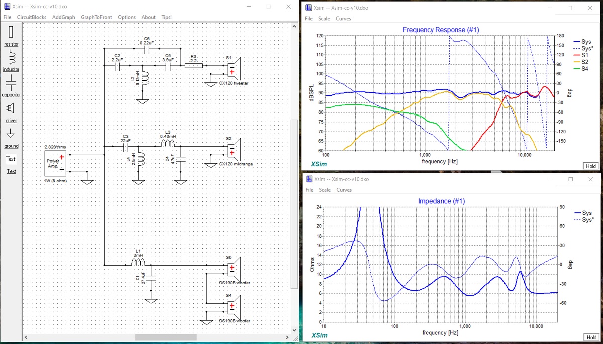

V1 BR and XO design
Using HornResp the BR design requires 6-8L and ports tubes ID=1.5" x 3". Pic#1 has the power curve and combined LF rolloff. The LF rollof is comparable to the CC370-v4 low end.
Using Xsim for the XO design. The CX130-8 FR a little bumpier than I would like. There is one MF dip as well as an HF dip+bump that I will just live with for now to preserve sensitivity. Overlapping the MF+HF a little helps flatten the curve. The LF-MF XO is 2nd order @800Hz , and MF-HF is 3rd order @5.8Khz. This is different than the 2 way CC370 (3rd order @ 2Khz) . The min impedance is ~6 ohm and similar to my other Paradigm speakers so my Yamaha receiver should like it. The speaker sensitivity is also ~90dB/W which is also similar to the other Paradigm speakers.

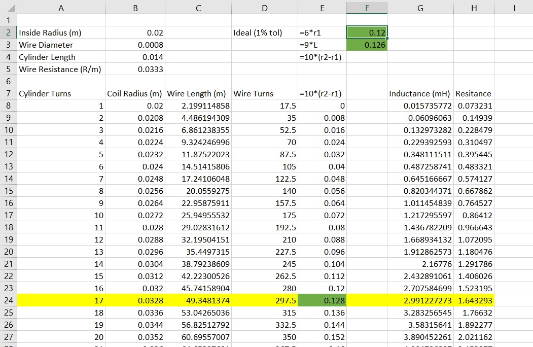

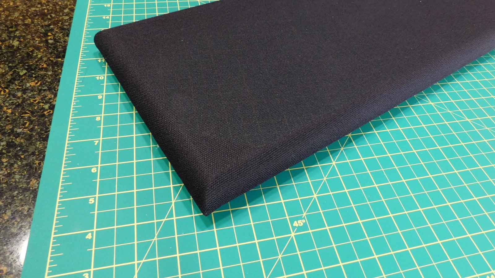

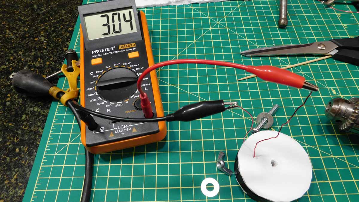

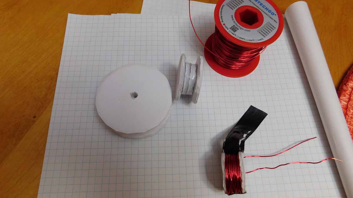

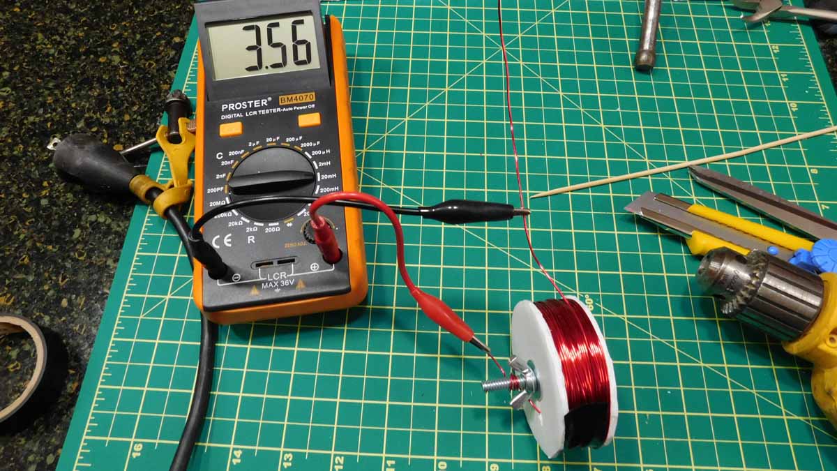

Inductors
Everytime I need an inductor the shipping cost's more than the part and then there's the delay. So I bought a spool of magnetic wire and tried out winding my own. This is very convenient for prototypes as it only takes a few minutes and I can easily adjust them. I even recover the wire when I'm done. Maybe I'll start collecting discarded electric motors 🙂
Pic#1 : shows the design for a 3mH inductor using Wheeler's formula. A simple spreadsheet can be used to optimize the coil ID, OD, length. Normally I would want thicker wire (lower resistance) and an iron core for something this large and intended for a low XO. However this is quicker for prototypes.
Pic#2,3,4 : Foam board can be used to make a quick spool, once you have the ID, OD, L of the coil. Wheeler's formula is very accurate. I filled the spool and adjusted +/- a few turns to get the precision I wanted. The metal bolt I used with a drill to wind the coil needs to be removed for measurement. A few zip ties hold it all in place.

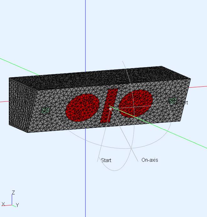

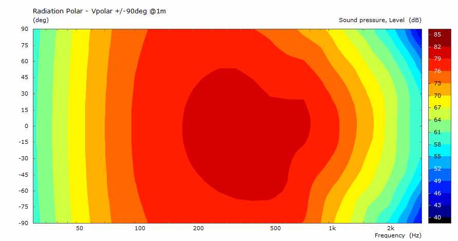

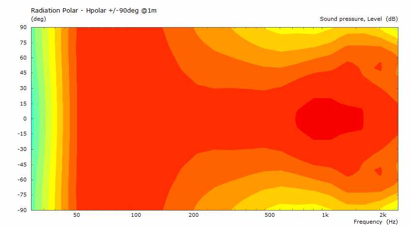

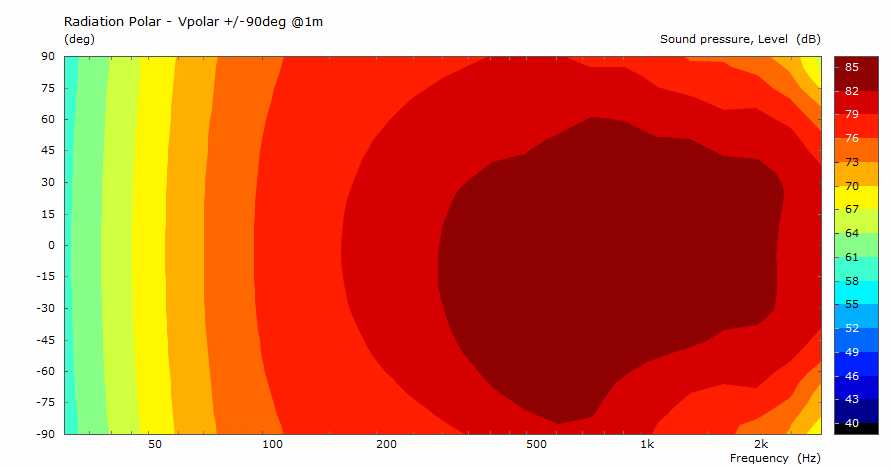

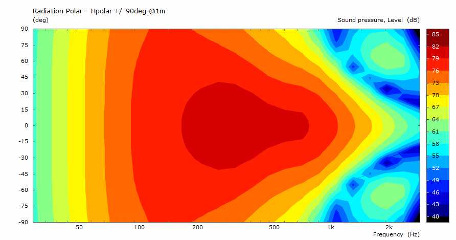

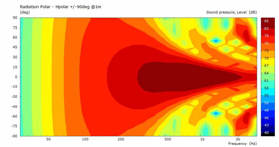

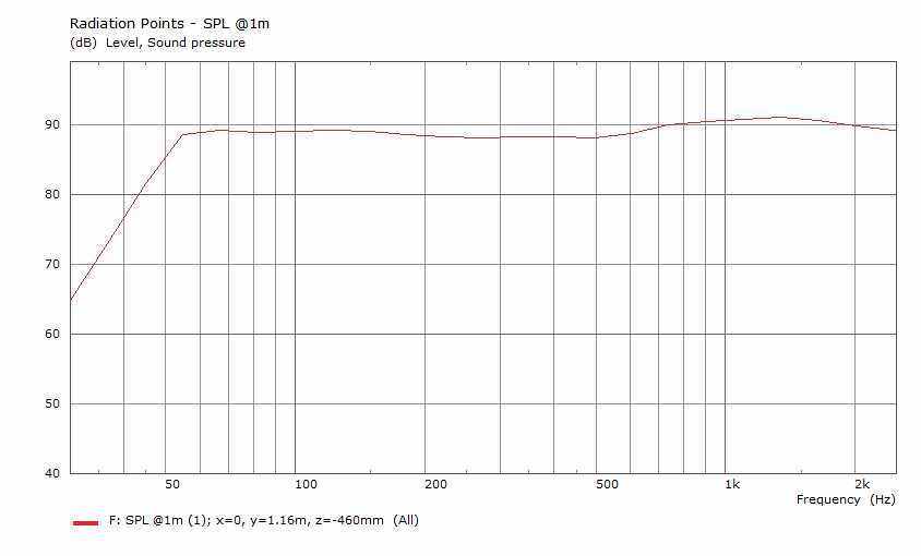

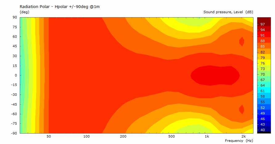

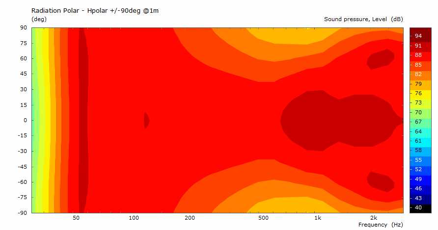

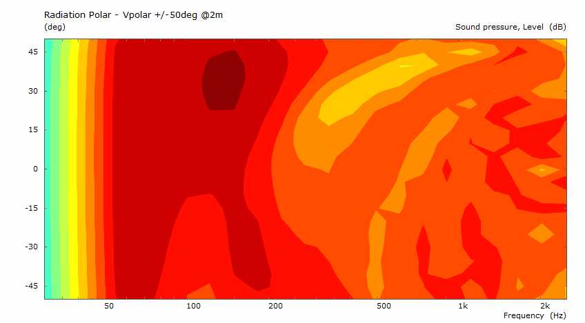

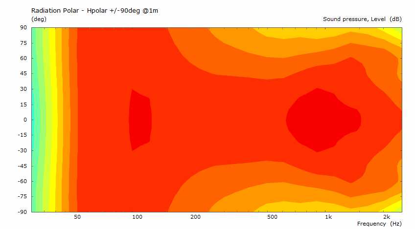

V1 polars
This is the AKABAK sim results for the V1 in 4Pi space. This is a starting point to see how much interference there is between the 2 woofers.
The model includes the LEM electrical models for the driver motors and the XO (800Hz, 5.8KHz) and BEM acoustic models for the chambers,ports and drivers.
You can see the off axis horizontal polar narrowing and the asymmetric vertical polar (30deg @top edge, 150deg @bottom edge). Still, there is at least 90deg horizontal coverage at the narrowing. I would like to improve this, but I need to check what happens when this design is mounted in the fireplace column.

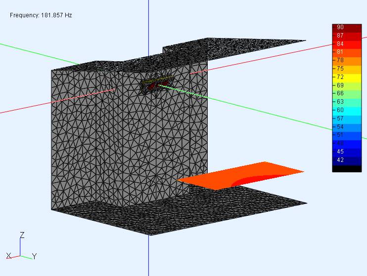

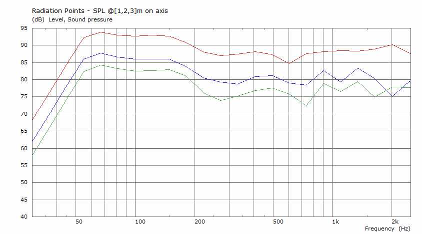

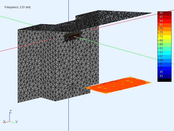

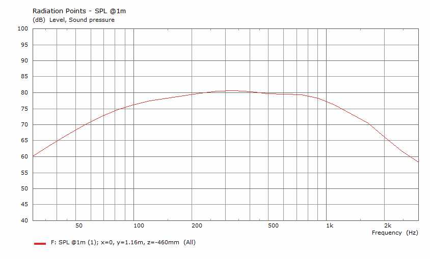

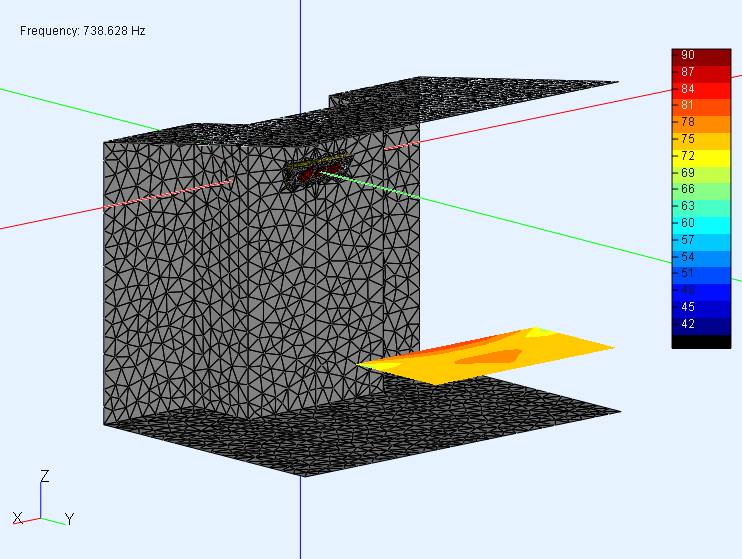

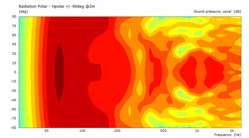

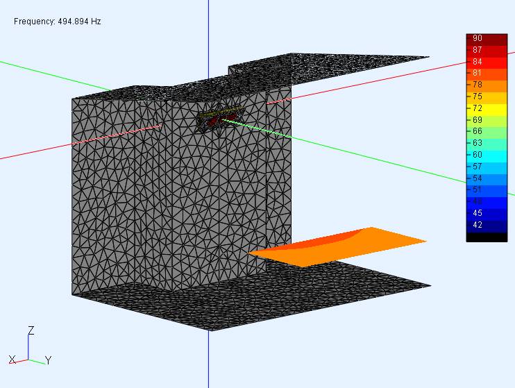

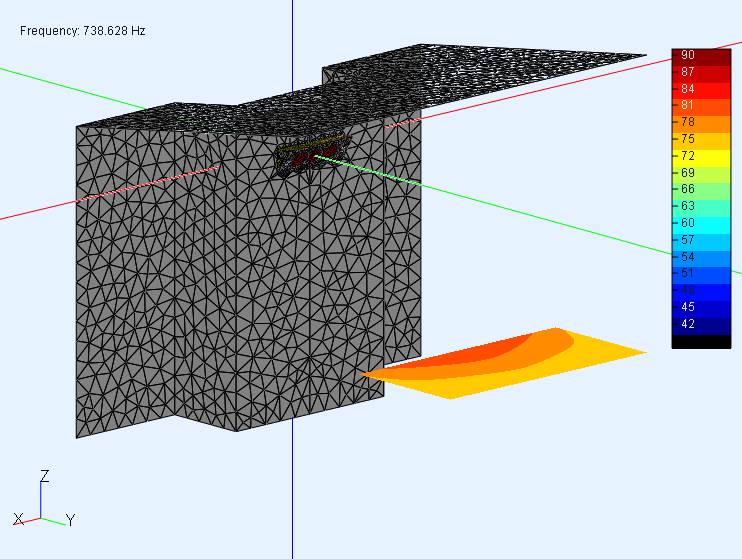

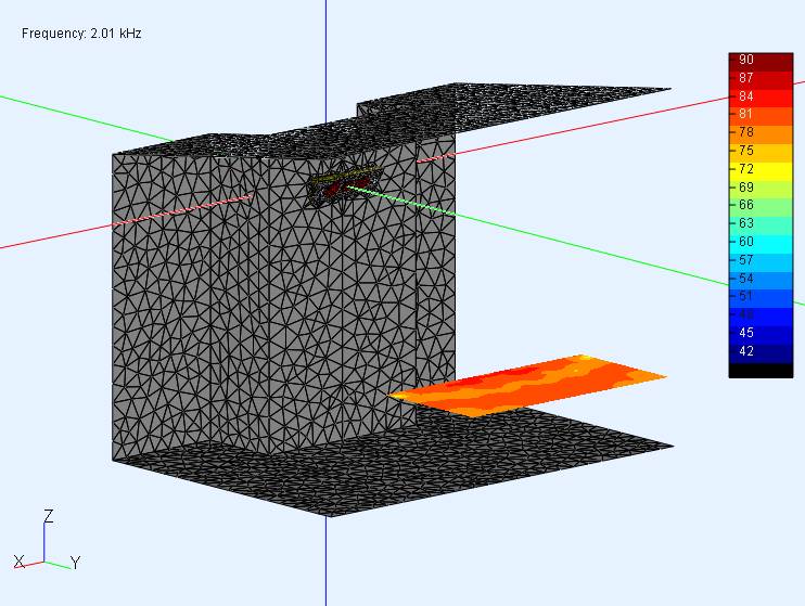

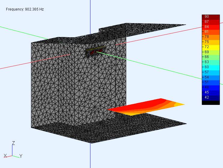

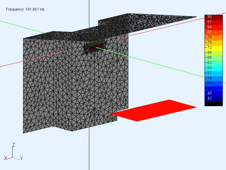

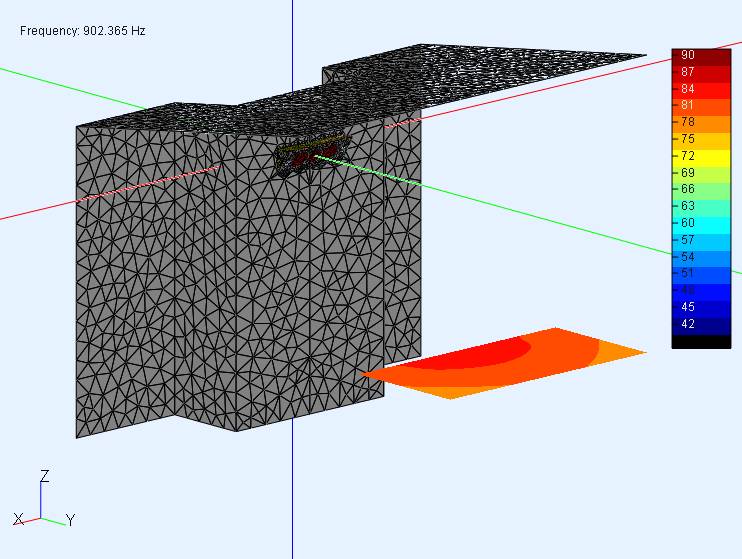

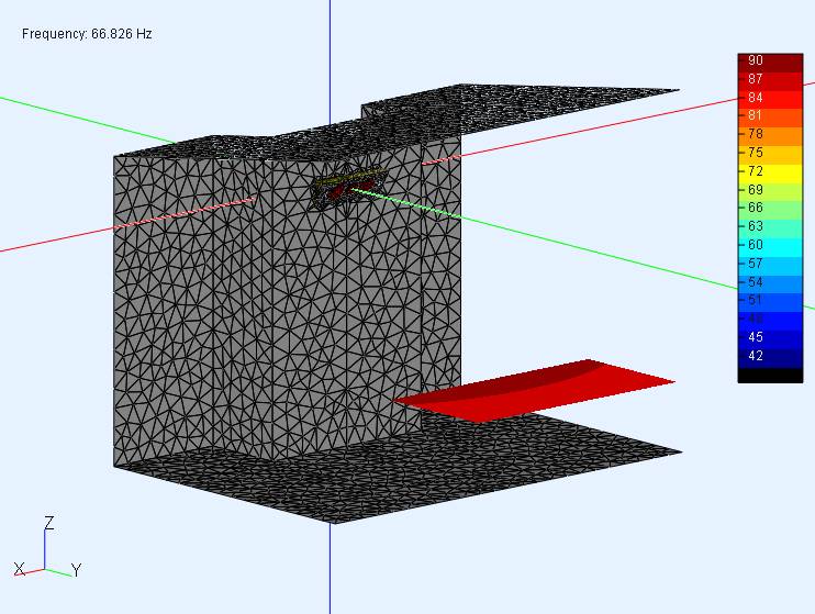

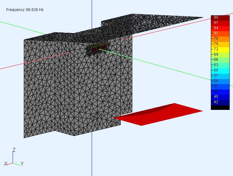

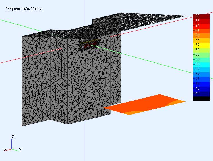

Effect of the FP column
These are some results from AKABAK BEM sim to see what effect the fireplace column will have on the polars. I have left out the floor in this sim so there is no ground bounce (yet). The sloped cathedral ceiling is causing a vertical bounce shown in the vertical polar. I've limited the Vpolar to +/-45 deg.
The column forms a wider baffle and helps boost the LF when compared to the 4pi simulation (as expected). The Hpolar dip is still there but it also has diffraction from the column edges (also expected). It looks like I put a small speaker on a wide baffled cabinet and pushed it against the wall. It behaves like that as well. 🙂
The observation field (1mx2m floating rectangle) represents SPL at ear level when sitting on a couch. It's not too bad but there is attenuation at the Hpolar dip and the system could use some EQ to flatten the response.

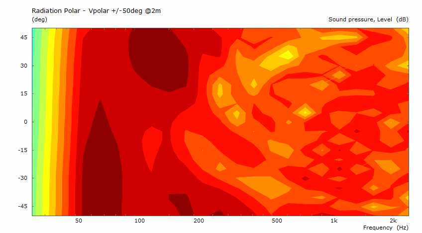

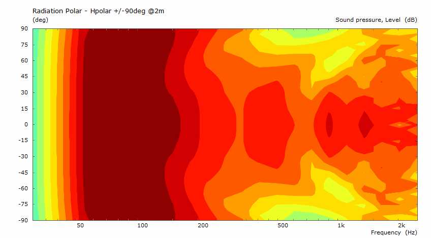

Effect of the column + floor
.. and with the floor. All the surfaces are modeled as ideal reflectors. The actual floor reflections should be attenuated by furniture and possible area rug.

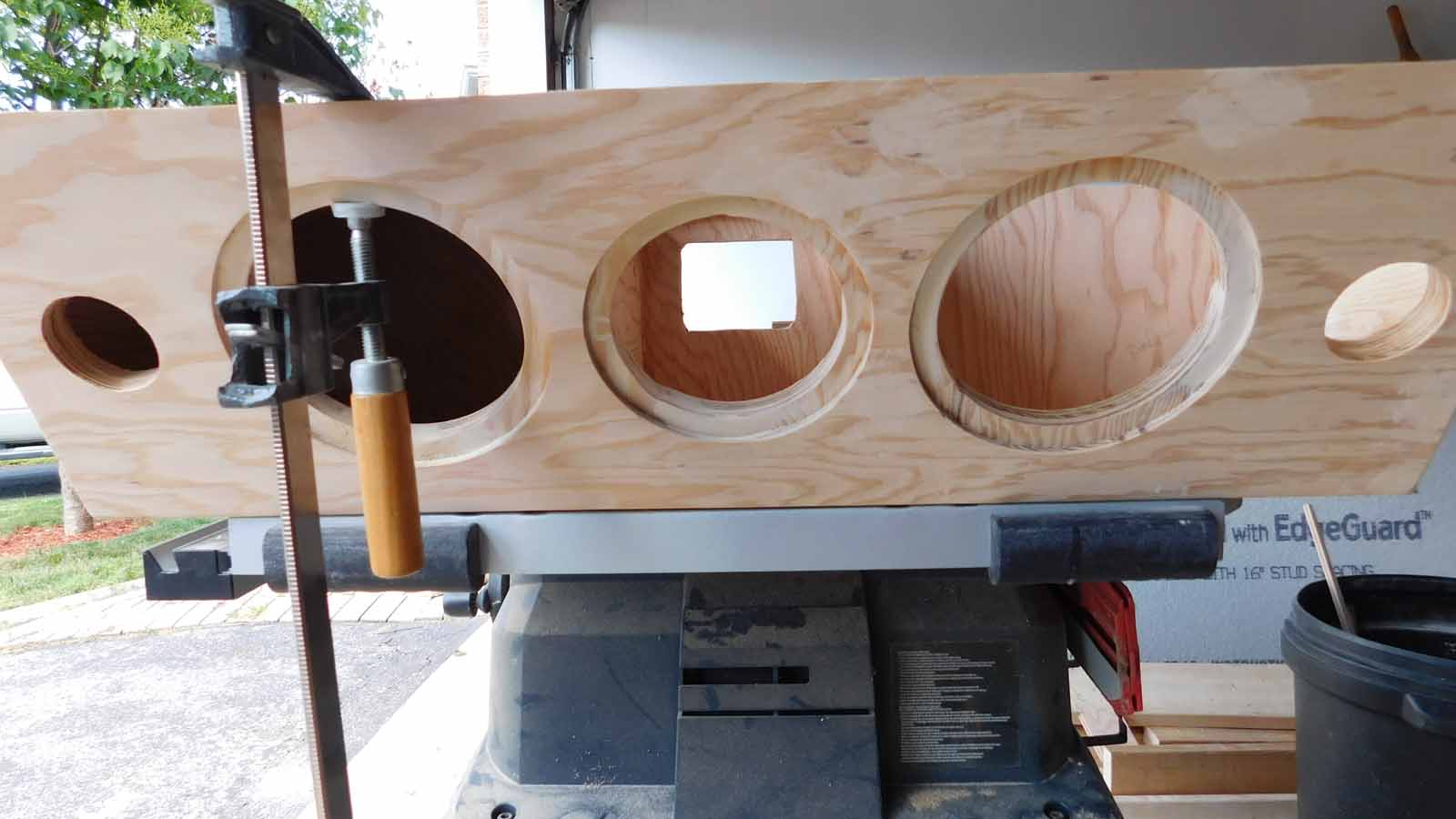

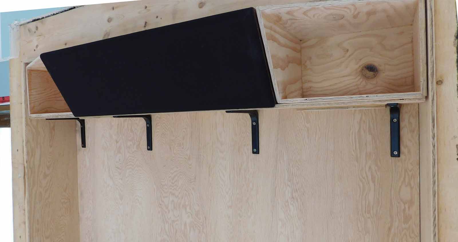

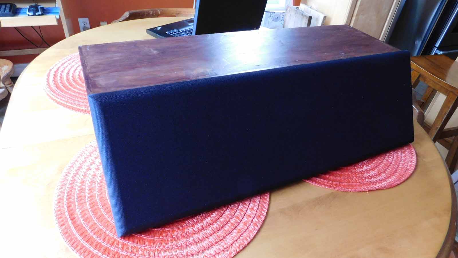

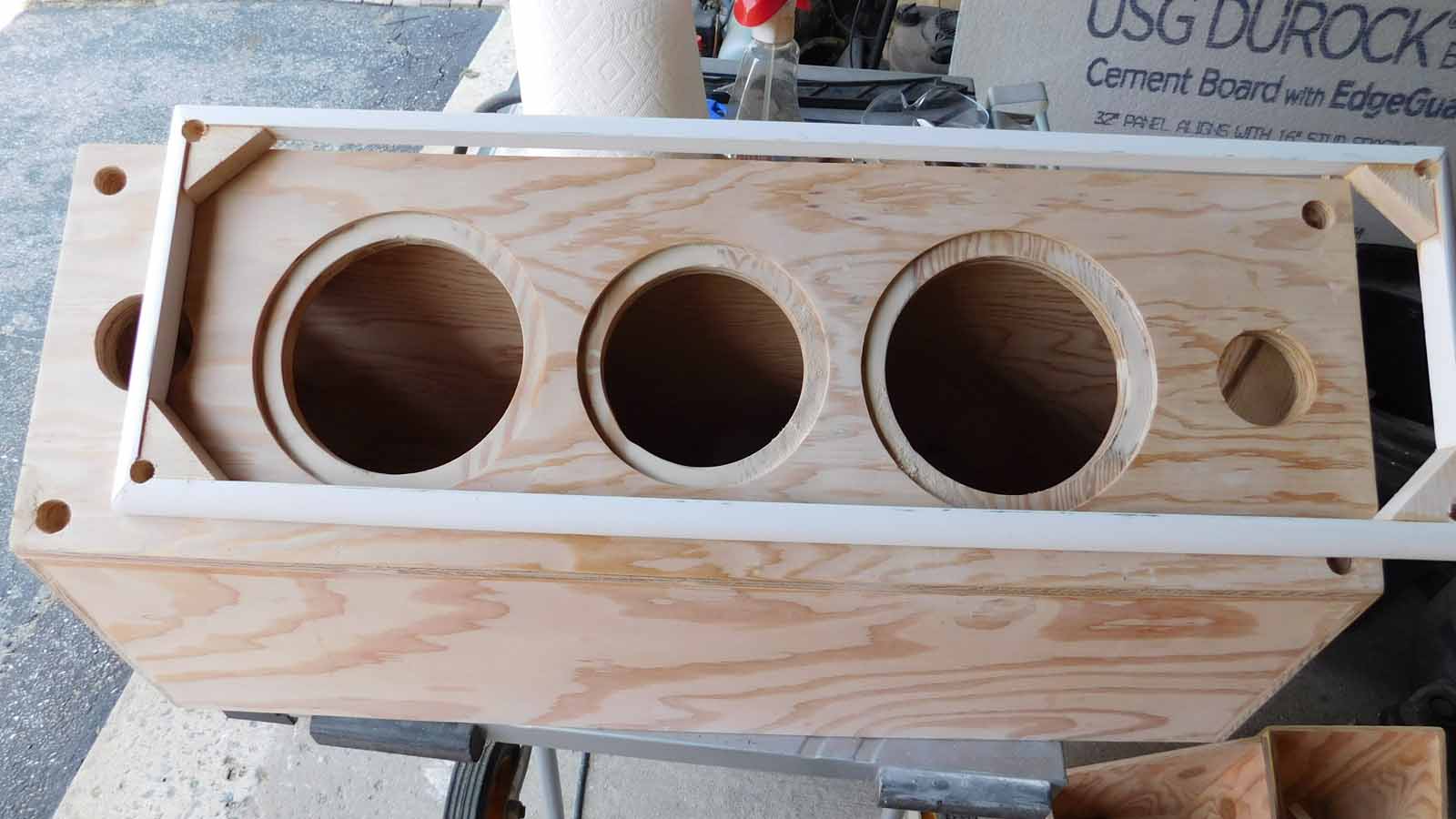

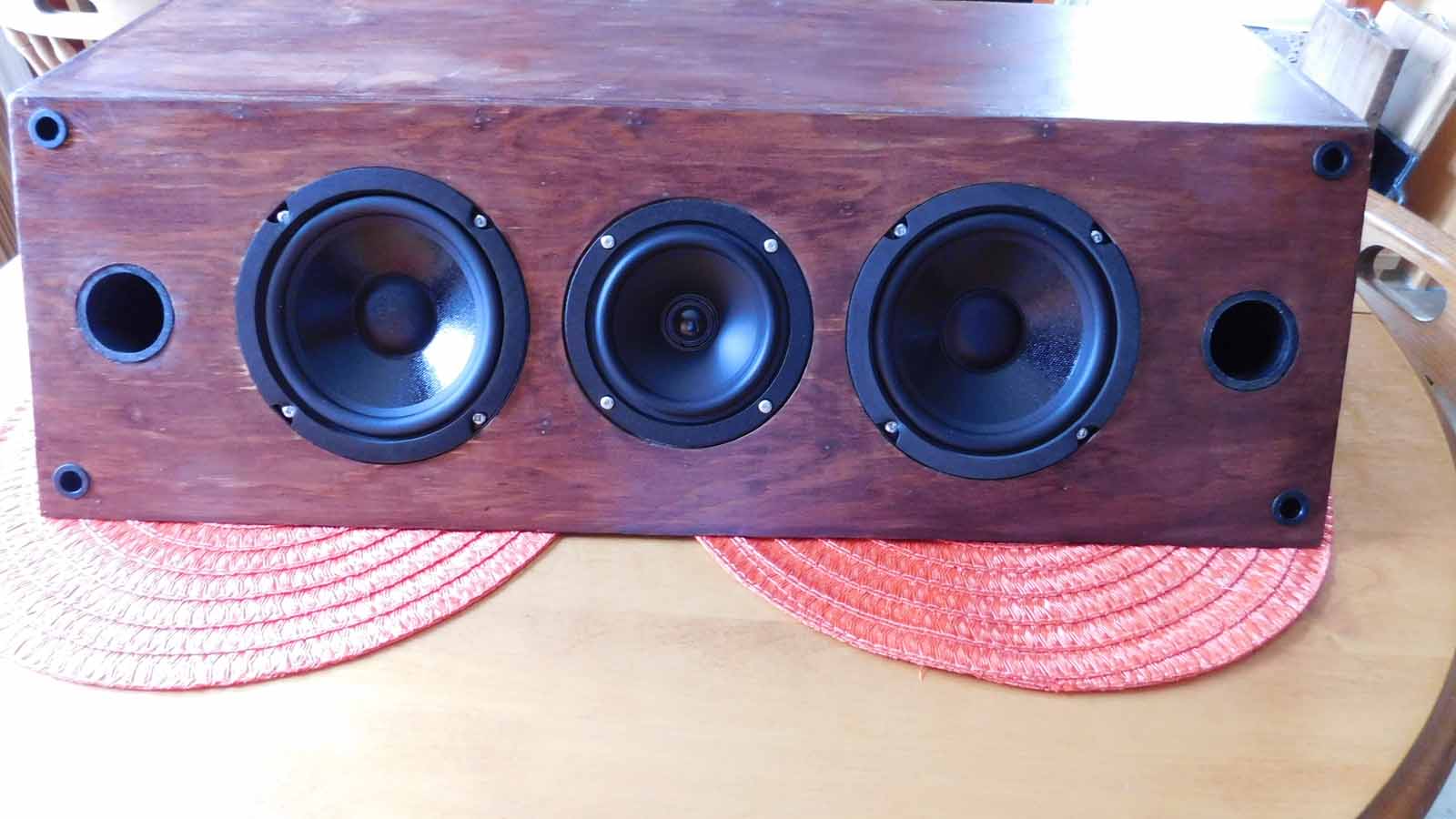

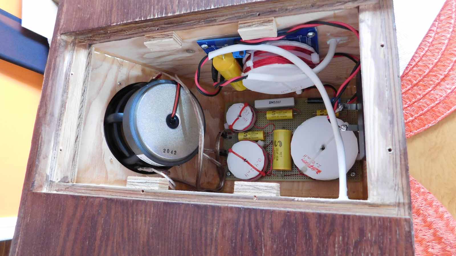

V1 build
V1 will be a starting point for listening and measuring. These are a few pic of the construction.
The plywood was stained with some left over walnut stain. It looks ugly on plywood, and would be better had I painted it black or even clear. This plywood was left over from stiffening the subfloor preparing for hardwood flooring.
The removable grill, mounting pins and material are new to me. Fairly easy to work with and I was concerned about the material corner appearance, and pin alignment. The frame is 11/16" quarter round which is easy to work with but not good w.r.t diffraction. The next removable grill will be more acoustically integrated.
Did a quick power up and listen with it sitting on a stand. Sounds good, but I still need measurements on a stand and in the fireplace column.

V1 - LF narrowing and the XO point
The V1 has the woofers as close as practical to the midrange (15cm C-C woofer to midrange coax).
Using my initial XO=800Hz gives me the min horizontal width I think I want, but it could be made wider. Moving the XO point lower means more midrange cone movement that I'd like to avoid because it's also acting as the tweeter's horn.
Using the V1 model to see the effect of moving the LF-MF XO point lower. A common RoT is to use lambda/4 spacing at the XO point, which is 573Hz for V1 spacing.
Pic [1,2,3] -> [800Hz, 530Hz, 400Hz]

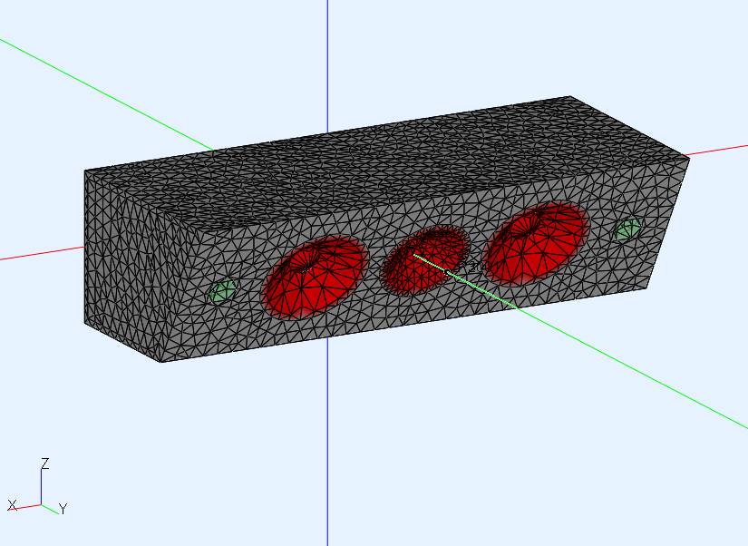

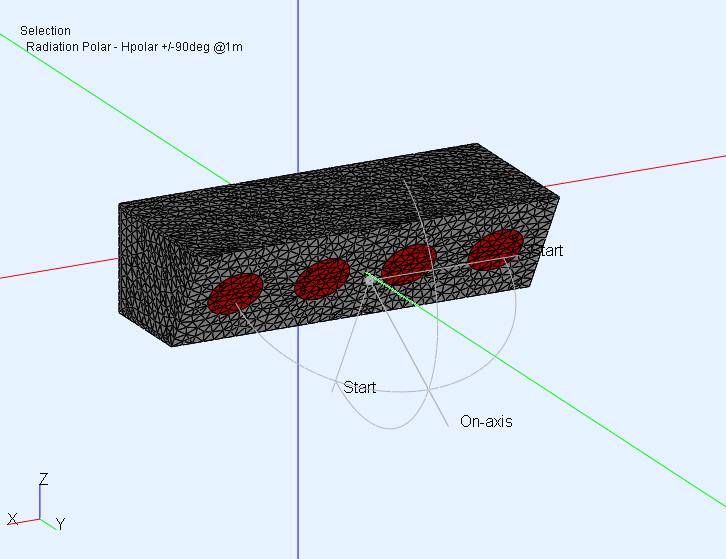

V3 - Quad Full range PC105-8
This is an attempt to shape the horizontal polar using a mini array of full range drivers (PC105-8). The sims are in 4pi space. I also have less volume per driver so it's now a sealed system.
Pics 1,2,3 : The simplified model and all drivers on (no filters) Hpolar and Vpolar plots. The horz beam width narrows and throws lobes. The reduced LF (<100Hz) will be compensated by LF gain from the wide column it will be mounted in.
Pics 4,5,6 : LP filters applied to attenuate the outer 2 drivers with increasing freq like a shaded array. This trick works to about 1-2Khz depending on the width you need and filters used. It still will require a center driver to take over >1Khz but the spacing requirement is not as critical as before. I would probably use woofers for this anyway and add either a midrange coax or planar.
