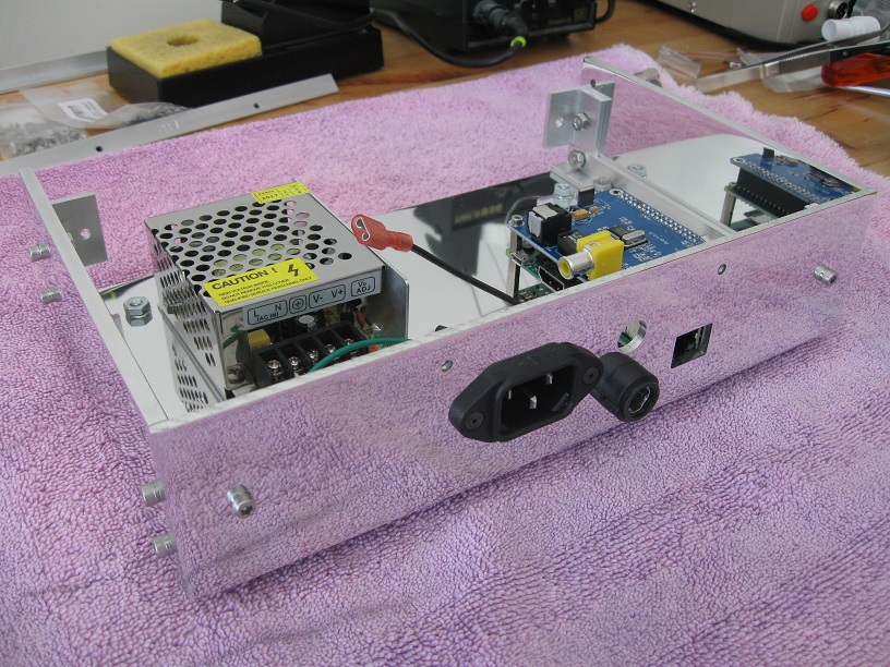

When I wanted to created a second setup in another area of my house I found out that the Squeezebox had been discontinued. Searching for a solution I learned about the Raspberry Pi and compatible sound cards. I opted for the Wolfson Audio card sold by Element14. It took a bit of effort to make it work the way I wanted, and I eventually replaced the Squeezebox with another Raspberry Pi + Wolfson Audio card setup. The one thing that was still bothering me was the fact that the RPI in a plastic box is so light that the weight of the network and SPDIF cables kept knocking the unit down from the shelf. I created my own custom solution and wanted to share it.
I cut panels to make a case from leftover material used in amplifiers
I assembled the base plate and installed the Raspberry Pi, SMPS, rubber feet and aluminum profiles to hold the side pieces. Even though I mentioned the Wolfson Audio card above, this unit has a Raspberry Pi 3B with a DigiPi+ sound card installed.
The side pieces installed and the back panel ready for mounting
The back panel in place
The unit is ready to receive the faceplate
The unit fully assembled and connected
The fully assembled unit viewed from another angle
The cover in place

I cut the aluminum on the table saw using a Freud blade for non-ferrous metal. The "L" shape profiles were also cut on the table saw using the miter gauge. For the holes I used a drill press. The pieces were then finished with a palm sander using 3M wet/dry sandpaper, grits 400, 600, 800, 1000 and 1200. The photo shows the aluminum plate used to make the Pumpkin pre-amplifier case. For this project I used leftover material from other projects.
I used this project to exercise mirror finish polishing. The case is not anodized, which makes it impractical to have this kind of finish if the music streamer were to be frequently handled. That is not the case, as the only thing that will be often touched is the power button.
In about a year or so from now, when the surfaces develop a patina that will make them look a little dull, I should have acquired powder coating equipment to refinish the cases in satin black.

Sorry, I forgot to mention the router. I used it give a round contour to the faceplate's corners. It was a minor but important participation.
Ohhh, you cheated
The SMPS used is capable of delivering 5A current, more than twice what the Raspberry Pi and SPDIF card require. Attaching one or more USB devices would not require an upgrade. If you build a similar case or customize a read-made one, you just need to cut the opening to expose the USB ports, which are already facing the back plate. In my case I only cut a small opening aligned with the Ethernet port, that is all the music streamer needs.

I purchased it from seller chenmiju2009 on Ebay and it is described as "AC 100V-240V DC 5V 5A Adjust Universal Regulated Switching Power Supply 25W".
If I post the link it will become stale in just a few days but, using the information above, I was able to find the item again.
