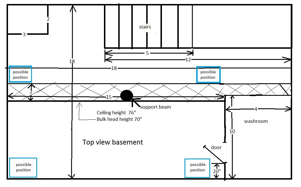

Room dimensions for Chang
A diagram of my basement will give you an idea of what I will be working with. I want to build the Curvy Changs but I am not sure if it will work in such a room. They can fit under the bulk head because they are about 62" high. The blue boxes marked on the picture may be a good choice for their location. If not then the half Changs may be my only choice. What do you think?
PeterC.
PeterC.
