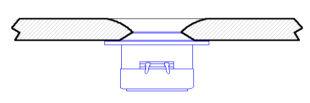

Some more numbers:
Curve radius 2011mm
Centre of curve to baffle: 28mm (1.1 inches)
narrow part in middle of side (Waist): 356mm
widest part of side: 511mm (7.2 inch extension)
Note: the side measurements are for a full depth side panel and a 240mm wide back panel.
For a recessed FE207E the driver brace is slightly less than 208mm deep. File it to fit then put some thin foam tape on it.

I've downloaded the new plans and will ponder over them. (NB Dave, the way I drew them in inventor is what gave me the silly angle, I should have looked and realised that it would be impossible to build to that accuracy and a sensible angle would be appropiate.)
Thinking about the back mounted treble, what I think I'll do if I go that way is have a circular insert with the FT17 rear mounted that bolts into a recess in the baffle. This way it will be possible to extract the tweeter without much trouble.

Marce, I like that idea. The horn assembly could be turned on a lathe easily. But how often would you need to extract the tweeter? If you had to replace it you could reach through the 180mm main driver hole.

The other advantage of having the tweeter on a seperate baffle insert is that if I mess up when making it I dont ruin a whole baffle.

Hi Dave,
i was being to clever for my own good, trying to set up a workplane using existing geomatry, a set of DWG,s or DXF's would be very usesful, if you dont mind, pre 2008 release cos I havn't loaded it yet.
If you have any drawings of the drive units, that would be a great help, and save me having to measure one of my FT17's, as I think I'll go for the rear mounted tweeter.

Rear mounting in this case we're actually talking about putting the FT17H in the front baffle, but frob the back, extending the horn flare out to integrate smoothly into the front baffle.
I see three advantages: Closer acoustic centre to the main driver, less diffraction due to a smoother match with the baffle, hides that cheap looking chrome ring.
