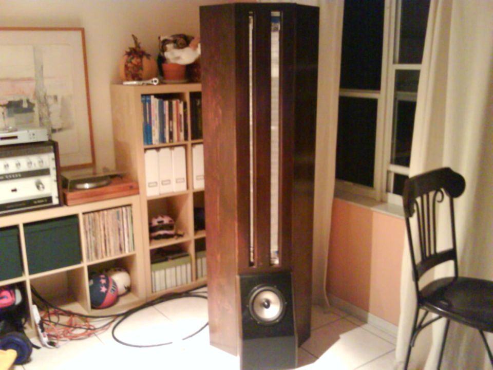

Here is a picture of my newest speaker.
And from behind.The subwoofer has a 15" passive radiator in the bottom,and it seems to be easier to match it with the panel as it is "tilted" 45`
It dosn`t go as deep as my first panel but deeper than my seccond one.This one is wider and not as curved.
I use iron and dont have to glue the magnets,and if i had to,i would`t use too strong glue becourse i will be able to remove them again.You could use silicone but not with accid, use one with alcohol regarding the aluminium.
I like the look of my newest planar ,and it is rather easy for me to make metalwork.I have the right tools.But i want it to go deeper,or maybe reduce the output in high frequenses.
Would it helpe to curve the membrane more, and wich radie would be the best??
The speakers from Martin Logan have curved membranes,what radius ,and how wide are they.

edit, note also that when you curve the design like that, you "support" the diaphragm at many points, so that it is actually devided into many smaller ones, with higher ressonance, hence less bass
My guess is that it would be better to curve it only vertically, but which way, forwards or opposite, I dont know 🙄 but I do have a suspicion 😉
Or you could split it up in 3 sections, each horisontally curved, but mounted "curved" vertically the opposite way
My aim is frekvensresponse to 100 hz.I know i need a sub.I think you are right about the width,it might be smaller,my first type was 12cm.x96cm. and was curved at R.31 cm The new one ,the third,is wider , 20cm.x113cm. and curved at R.36.The idea with 3 panels I cant visualice it right now ,i will have to think more.

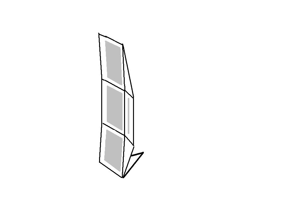

I imagine a 3 segment something like this...not sure if 1 or 3 segment tweeter
If you want it down to 100hz you either need equalising, or a 2way design...I dont think theres any other way around it
Båndsei
