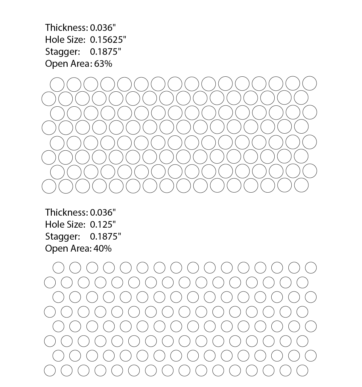

I'll be building a new pair of speakers with a few key changes:
-Thinner mylar (6 micron from 12 micron)
-Taller panels (12"x36" from 12"x24")
-More open area on steel panels (64% from 40%, see attached pic)
-Built in woofers and crossovers (NOT just a subwoofer taken from a sound-bar)

"More open area on steel panels (64% from 40%, see attached pic"

Thanks for that info tyu.
Does anyone know exactly how much my output could potentially decrease? My current panels get plenty loud and since these will be even bigger I doubt that they will be quiet, but just in case.
-Ben
I've built perf panels with open areas from 40% to 63% and I find the lower percentage open area ones just sound better. The higher open area ones were a bit harsh and also I think the lower open area stators help dampen the diaphragm's drum head resonance. Many builders add some acoustic resistance in the form of scrim cloth behind the rear stator for dampening-- perhaps it's better to go lower open area on the stators instead and use the extra metal to drive the diaphragm. Just my thoughts....

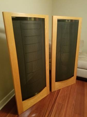

I have pr of Re-worket ML CLS....22"wide..48" tall....that would be the 50% open, curved panels...I run full rang but theres nothing there below 50-60 hz...be for over lode.... I get great output out of these panels,with just a transfourmer an a one ohm res.....get as good if not better than new CLS panels... with the ML crossover, tone shaping setup I have been told by other owners of the Stock CLS llz an CLXs
An if you pic the ML CLs up off the floor 6-8"...OMG...35 watt tube amp well run you out of a 18'X40" room...make big diff in output...Wow..shocking..well to me....I am posting this info just to help you..see were you may go....good luck ..have fun

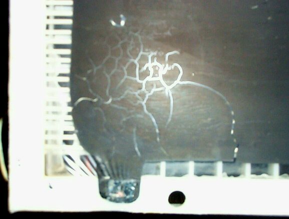

Some pix...tuff to get good pix close up
My problem with the newer ML small hole panels sound...I don't like there sound,of the way there new, well was new... type air frame works... the image is to large for me....an it makes it hard for me to get past that... to focus on the output...or sound quality....

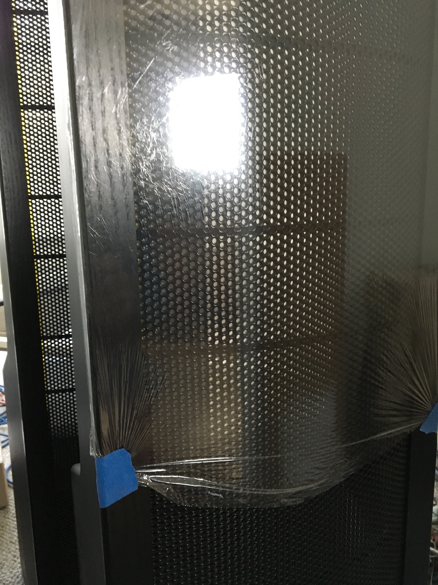

Pics include something you can try yourself . If your rebuilding, then you know which thin Mylar will suffice.
(my SL3 with Quad 988 original dust cover material placed directly over the panel) 988 being rebuilt currently.
Get out your laser pointer and place it 1/3rd in on each panel blah/blah/blah
Give it a Listen and tell me what coloration you notice 👌🏼

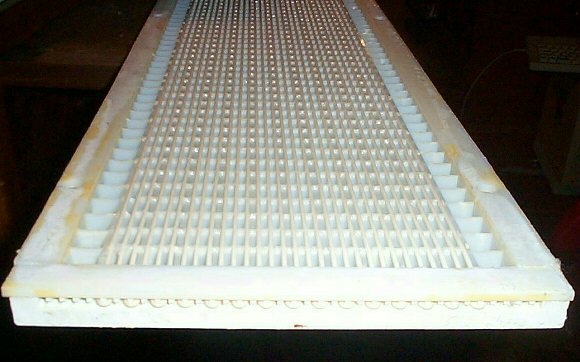

4 pr... SL3 never like sound..of the Hard Plastic Strip under the rubber bars on the back stator ....it come unglued in time...adds it own sound...
The Ascent panel did away with it just used rubbers..... an bass setup..much better panel match...open at bottem an top......but thay were $20ea...yes ML are good fun..for these prices...

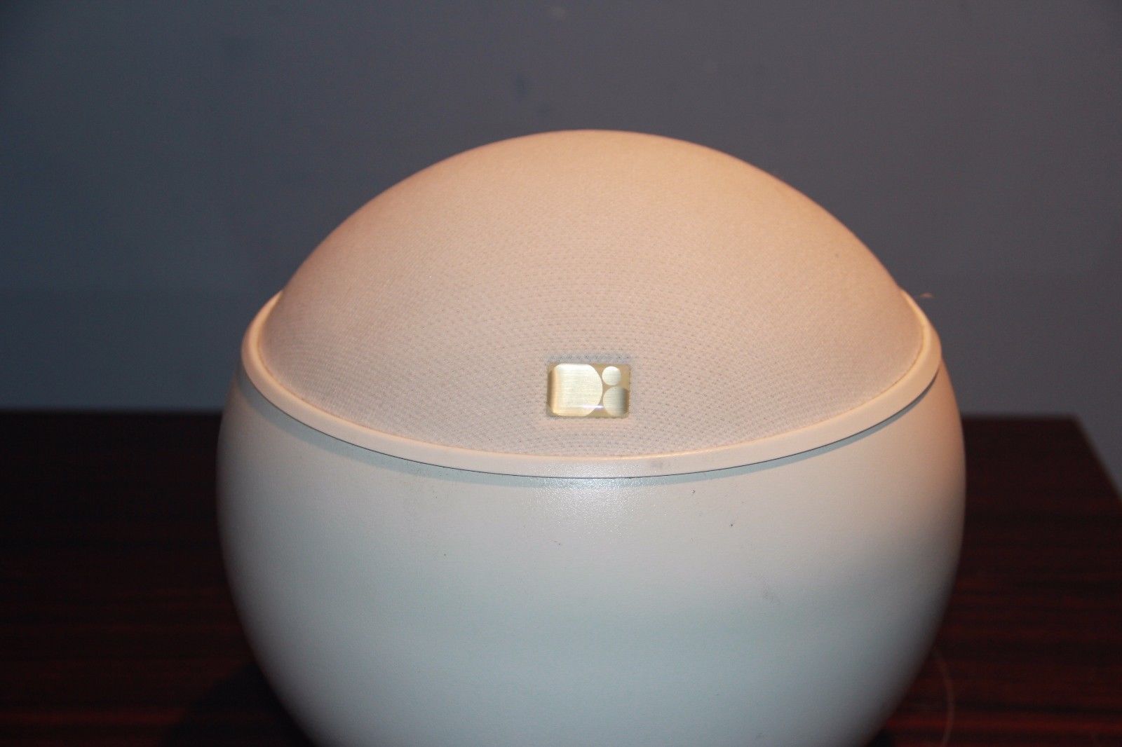

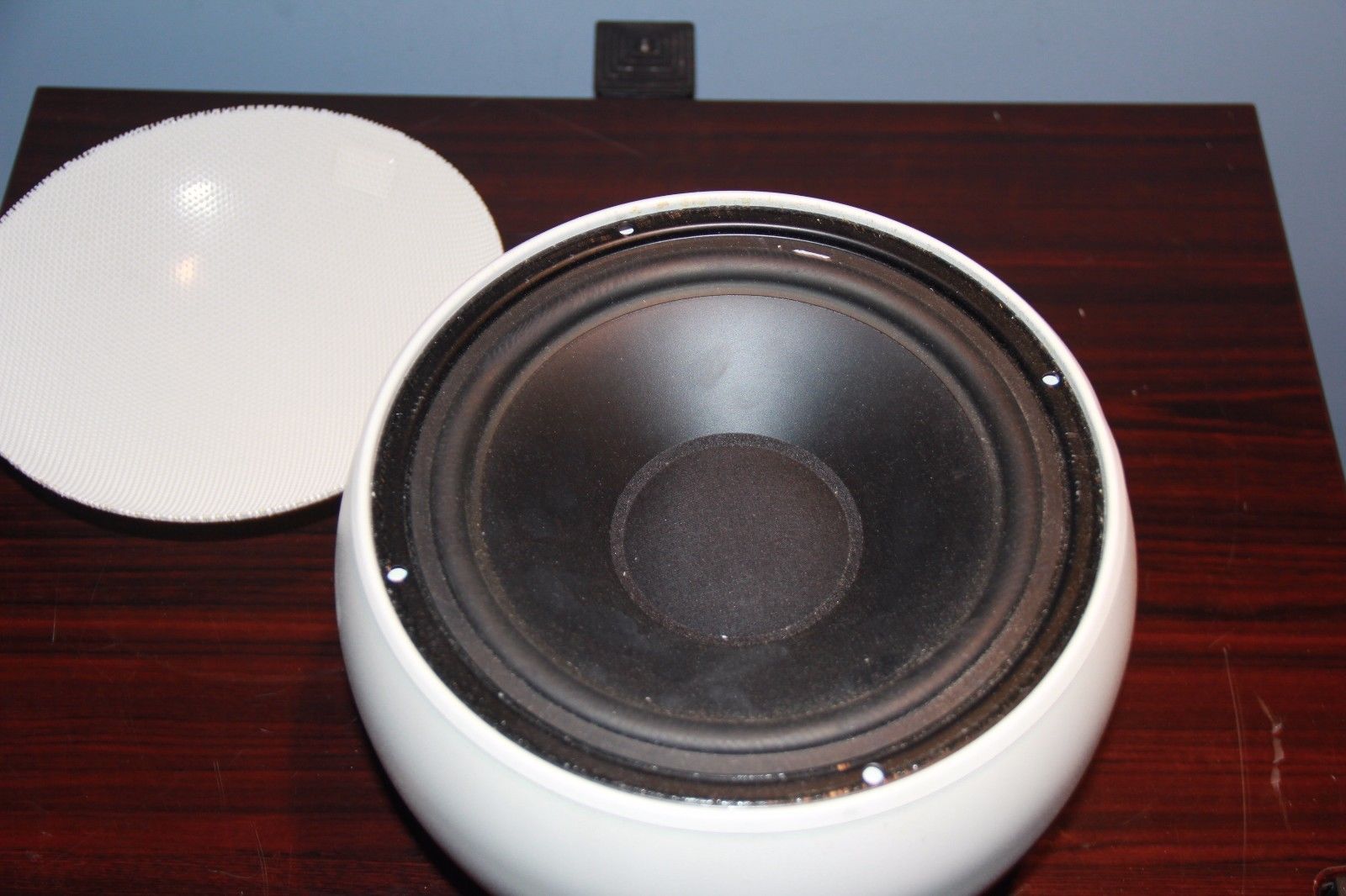

some pic I pulled off the web....
