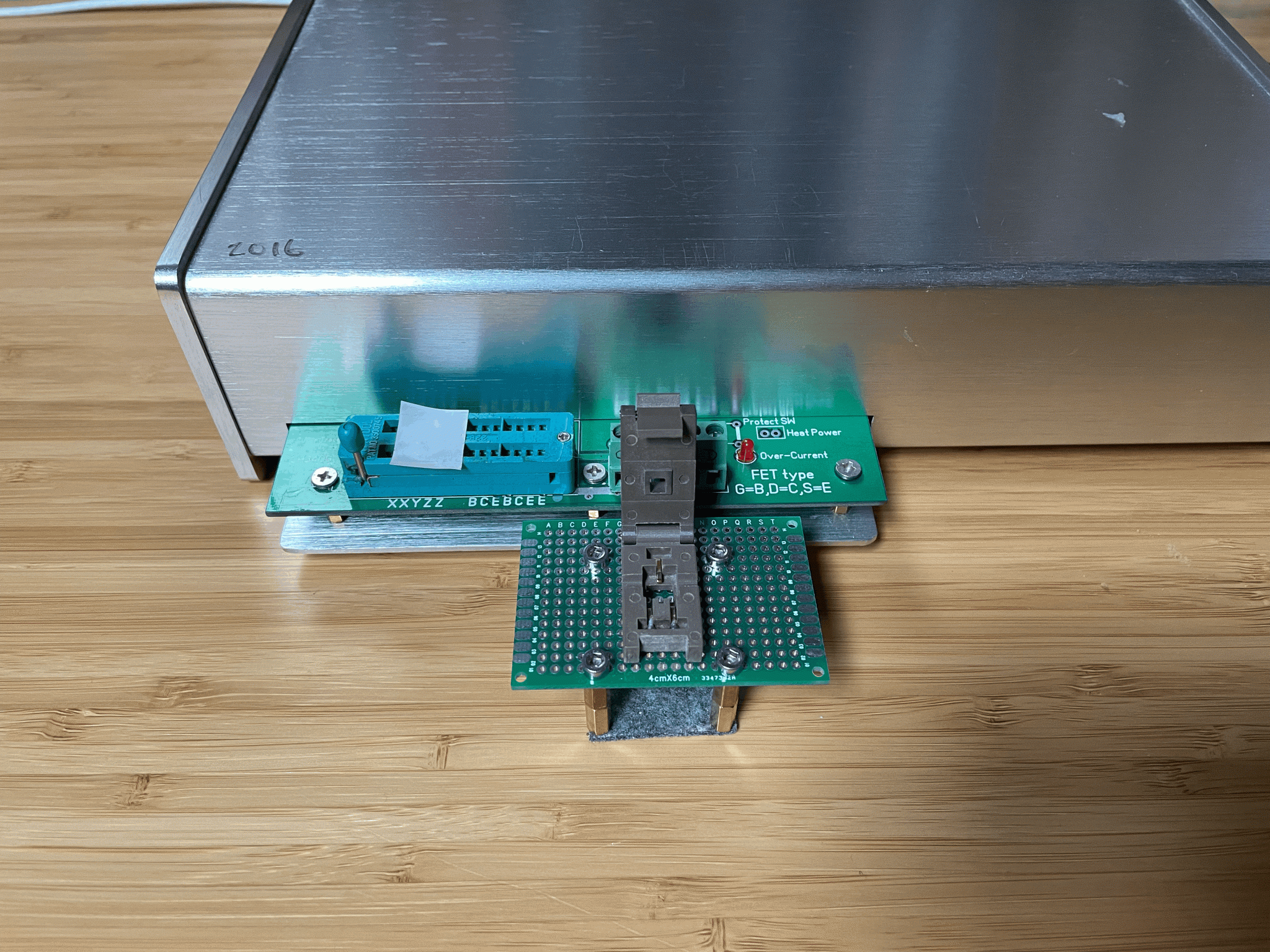

For measurement I purchased a TO-252 test socket and fitted this to my trusted Locky_Z curve tracer.
Reactions: pinholer
The loading/unloading of the FET is still what takes the longest time (some 20s with the FETs well organised in the trays). The devices nicely slip into place in the socket, but moving them around using forceps does take time.
The measurement itself takes 1-2s and is as simple as a click on the mouse. Data are automatically collected, numbered and saved.

Your way is certainly the best if you know the exact actual operating conditions beforehand. I don't.
My experience tells me that devices that traces similarly at one defined condition also behave similarly under different conditions.
Later on I may still need to do measurement at operating conditions (if I need perfect matches), but on a dramatically lower number of devices.
With 2500+ devices to do, most data with least effort is what I'm looking for.
