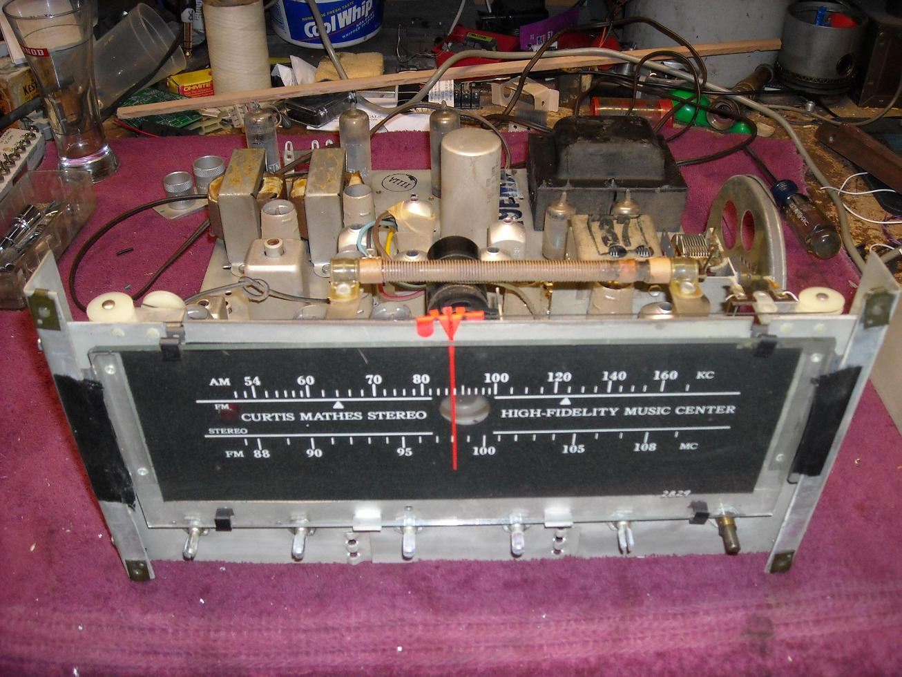

Is anyone familiar with these? I did a search and go t only one hit on a SS version.
It appears that late in their production they made one chassis that was used in the TV console and the stereo console. The one I scored today ($32.00) is a console stereo, but there is an input jack on the chassis for TV.
All the tubes are marked Curtis Mathes, Japan.
I slowly brought up the B+ on the caps to see if they would reform, and they looked good so I did the light bulb and variac power up. Everything looked good so I tried the FM stereo and it locked in to a strong station, but is a bit distorted.
With the selector on tape no input and the volume on max the hum is not too bad. B+ at first stage is 350, with 325 on the plates of the (SE) 6BQ5s. Ripple on the first filter cap is 4Vrms, with 0.3Vrms on the next filter, and less than 10mVrms on the two final (it splits) caps.
I connected a CD player to the tape input and it sounded much better.
It is nice that it is an integrated receiver, if it is possible to align the FM to get rid of the distortion.

It is a model 29FMX, which I believe is one of the last ones made before switching to SS.
In part this is based on the cabinet construction, which was veneer covered particle board.
From the adds I've found on several sites, up to the mid 60s they were advertising solid wood construction.
It looks like they had a basic design that they used in a wide variety of products, and kept improving the basic design over at least a decade.
