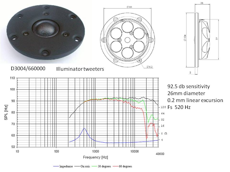

The two tweeters below may interrest you.
AUDAX TW034X0-P47N used in few design by Troels Gravesen :
http://www.audax-speaker.de/index.p...dFile=imported/pdf-download/audax-tw034x0.pdf
Peerless 810921/D2608 used in the Elsinore (J. Rasmussen) and Nomex164 (Gravesen) :
http://www.scan-speak.dk/datasheet/pdf/d2608-913000.pdf
The two tweeter have a rising response in the 10-20K region that can be corrected with a RLC network.
PS : I own both of them 🙂

I have make an overview of several available dome tweeters without ferrofluid and high efficiency. Go therefore to post 61 under
http://www.diyaudio.com/forums/mult...hout-titanium-without-horn-7.html#post4553344
