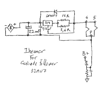

is this ok?
I have prepared this. Its ready. Is it ok to apply it?

The one glaring problem is that you're using a CCS to feed a parallel pair of heaters. A CCS is best used on heaters in series- in a sense, it forces matching between tubes (or, in your case, between sections of tubes).
You probably do not need that reverse-voltage diode since this is not a HV application.
When driving indirect heaters with a current source is there any benefit to bypassing the coils with capacitors? A small film cap driven by a very high impedance sounds like a cheap and cheerful way to minimize the potential of mains-bourne junk entering the circuit via the heater. Another consideration is that a solid state current source will only act as one to a certain frequency (well below RF?) Anyone played with this combination?
It would indeed be an excellent filter, except. Except that most CCSs for this application are not only not very high impedance, but they're distinctly iffy above a few hundred Hz. I've been doing some preliminary investigations on using power FETs or bipolar audio transistors (such as BD131) in a cascode.
EC8010 said:
...not only not very high impedance, but they're distinctly iffy above a few hundred Hz.
Thanks for the head's up! Heater CCS's were in consideration for my first self design but I hadn't considered the possibility of such poor behaviour from typical implementations. When you say 'most', you mean the the usual IC voltage regulator restrapped as a current source?
That's right, if you look at the curves of output impedance against frequency or ripple rejection against frequency for an adjustable regulator you soon realise that what you're looking at is a graph produced by the falling open loop gain of an op-amp. And not a very good one at that. A 741.
