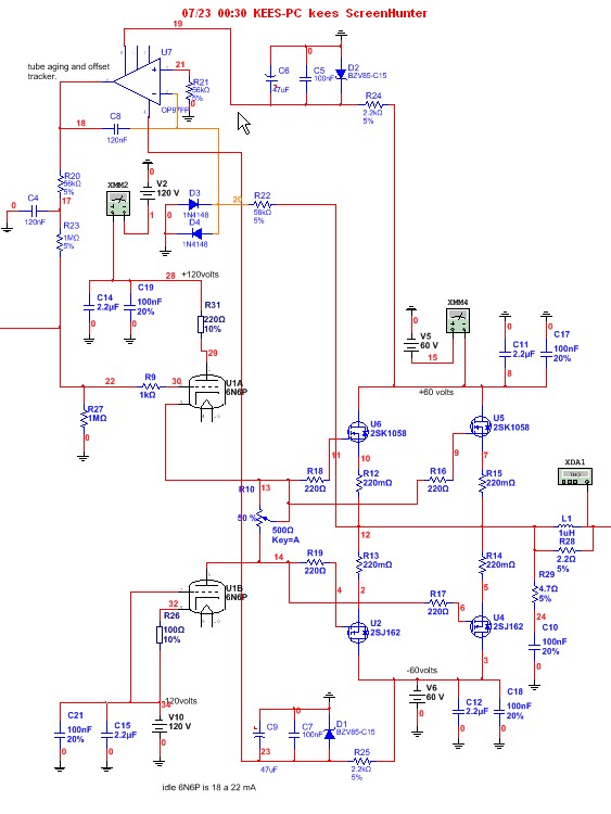

I have a hybrid who use a servo for offset nulling, it works trough the cathode follower input, it do work fine, but.
I did read something about a current servo who has less impact on sound eventually, I did this tryout by using a fet between the current source tube cathode and gate, see schematic, if i do simulate it it works fine, but in the real world not, I did see that I eventually has to change tho opamp inverting input, because on the negative side of the amp there is no inverting or how I do call that in english. ps I did try to invert the opamp input, no result.
maybe some has a idea, voltage servo,s do have impact, and so I want to try what current does.
thanks.

Hi Kees,
It looks to me like you either need some kind of level shifter between your op-amp and your PMOS, or you need to replace your PMOS source follower with something that can work with a control voltage low enough for the op-amp.
Your present circuit as an op-amp of which the output can't swing below -16 V. It drives a PMOS source follower whose source must end up a few volts above -120 V. That means its gate has to swing close to -120 V, while it can't go below -16 V.
If you are satisfied with a very limited control range, maybe you can put a resistive voltage divider between the op-amp and the source follower: a big resistor from op-amp to PMOS gate and a much smaller resistor from PMOS gate to -120 V.
Marcel

Hi Marcel
And if I try a drain follower there? or even a bipolair transistor, a level shifter feeding with the -120 volts can work best?
I don,t now if I am right with the impact, but I think current way of nulling offset is better.
Be the way, do you agree that windows 7 get,s not better after updates, I have crashes the last time, 3 times i did lost a schematic (blue screen) and reset of bios, but maybe you like me not so pc minded.
The schematic in this post is the version I did use for some years now. R31 is not used in present scheme.
thanks.

Hi All again.
I have done it this way (see picture) a mosfet to eart and let it snoop some current from the tube ccs cathode, but maybe a danger, if the mosfet fails the resistors will burn, but this afcourse is only if mosfet turn fully on, that is why a resistor of 1 M is from gate to earth, what do you think, it has a offset with it at 8 uV on simulation, but like first in real time what will it do.

Hello Kees,
I see two inversions in your loop (op-amp and PMOS Q5), so doesn't this circuit latch up?
If you replace the integrator with a non-inverting one, then it should work, or at least then I don't see a reason why it shouldn't anymore. You can then protect the op-amp against excessive input voltages by using a resistive voltage divider between the amplifier output and the plus input of the op-amp.
By the way, you could add a resistor in the drain lead of Q5 to limit the current if it should somehow get into the fault condition you described.
Best regards,
Marcel

Hi Marcel
I have only simulate it there it did work but maybe if the offset get positive it don,t.
I have see it, I will make the opamp non inverting it is easy then simulate again, a n fet is not the option.
thanks

Most simulators don't care whether a DC bias point is stable or not when simulating a DC operating point. When you simulate a schematic of a digital latch, it will typically end up in the metastable state (logic value 1/2), even though a real-life latch always leaves the metastable state within a few nanoseconds. You normally don't have that kind of problem in a transient simulation with an input signal.
Wel it is clear your explanation, I have to try real time, if the mosfets arrive I start. just try to make the opamp again non inverting, then the offset do keep walking upwards, if i do make it inverting again I get a stable offset in the uV region (8) and keeps there.

Hi Marcel
I now Dil not eurosound, I have order some time ago in china, but it is a gamble sometimes, and get parts is more difficult the last years, I think because a lot of people being stopped with electronics.
A small update about the servo, you are right, it has to be not inverting, I have put a other part in simulation, who did not work, component database of multisim is not so good, the part I had in schematic was already non inverting, but ic house was wrong, now I have put a nieuwer part in it, the behavior of the simulation is as expected now,
so it will proberly work.
thanks, en nog een prettige week.
Wel I have stop the attemp to use current servo, I stay with my own first way of doing it, only I have use a dual opamp with low pass extra, I did found it on the internet and has a very low point of working (1Hz) this do work also in amp, and it seems audio get much less stressed.
Maybe I can better chamge the zeners for two antiparalell diodes?
thanks.
